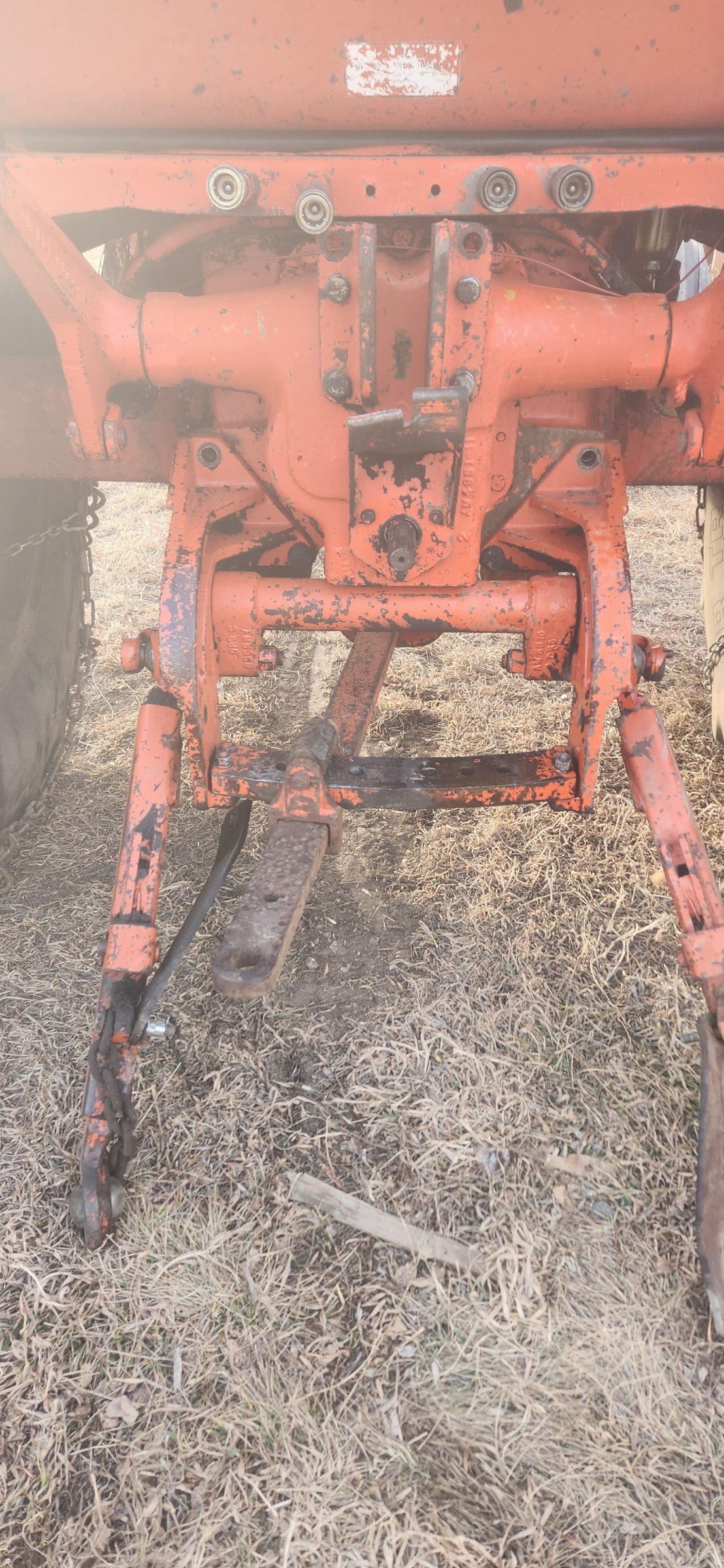

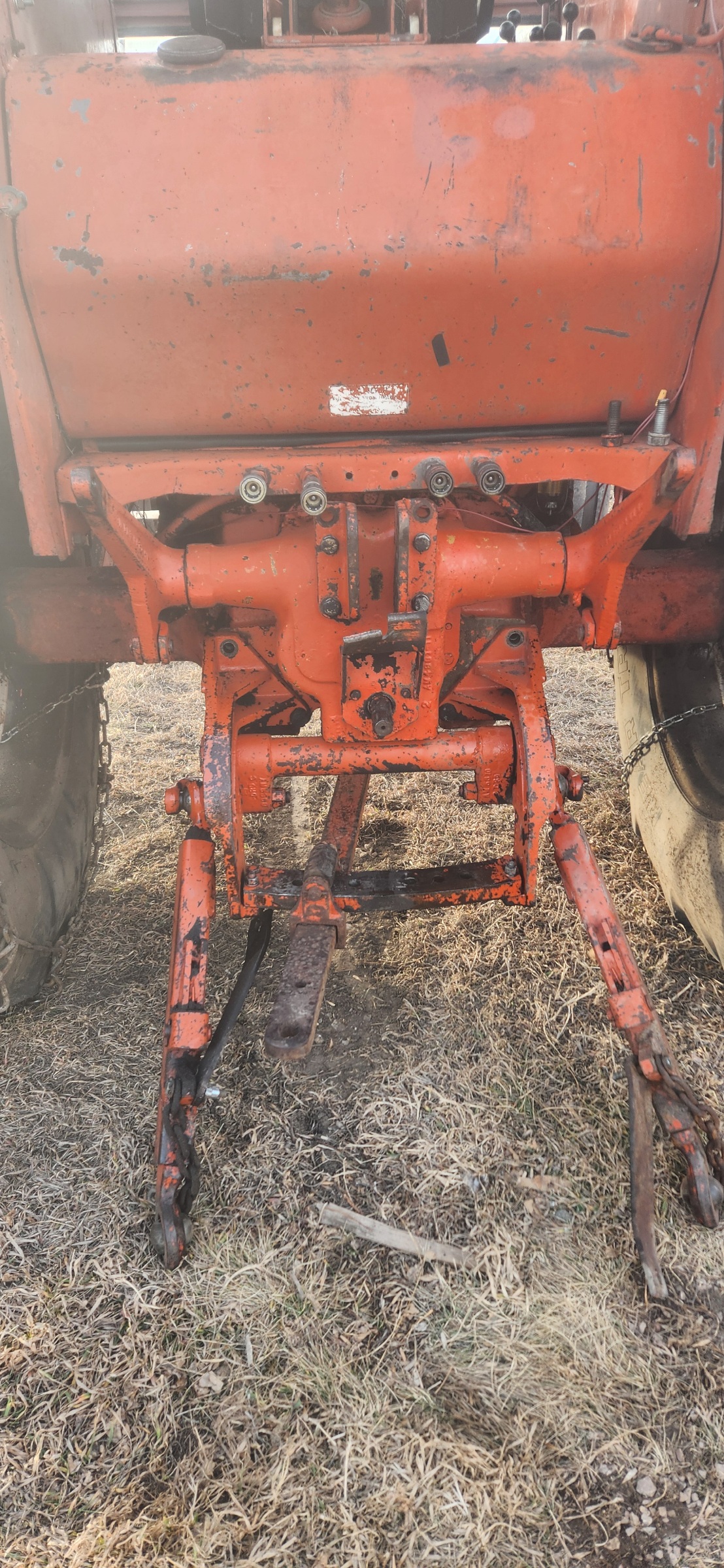

What do I need to remove on this to be and to use snap coupler again? Everything?

Looks like you need a drawbar and bail at least. Your drawbar might adapt?
Good luck with the project, not many snap-coupler 190's around! I've got a buddy that would like to own one.

It all has to be dropped off. 6 bolts and you are there. The snap-coupler tongue comes right up to the PTO housing when fully lifted up.

Was hoping to get away with less.I got an eye on a bail and plates did draw bar.
Thanks guys

Sam T in Ga had a reverse NOS OEM kit to change from 3 pt to snap - I never knew about it until he posted about it years ago. His may have been for a 180 though.
