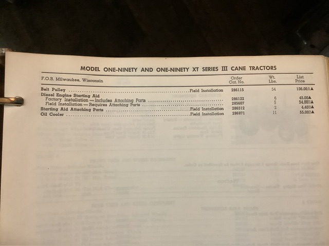

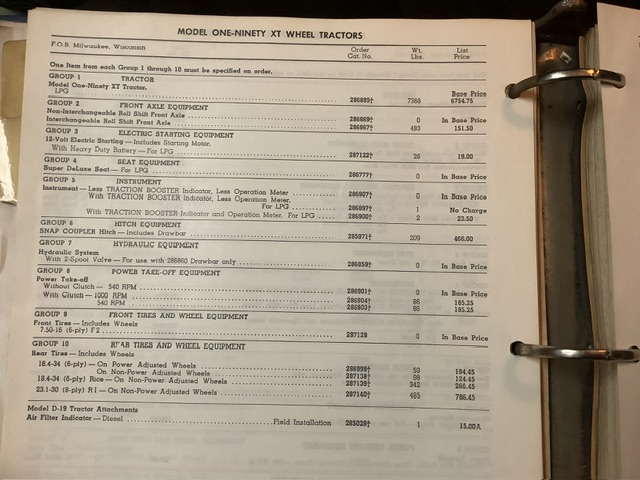

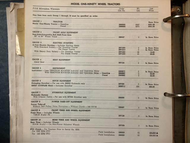

Hope you can read all that. That’s all the 190,190xt pages from August 27/ 1969 price sheets

Post Options Post Options   Thanks (0) Thanks(0)   Quote DrAllis Quote  Post ReplyReply Direct Link To This Post Posted: 6 hours 4 minutes ago at 6:34am
What I see is the 540/1000 RPM PTO wasn't even offered as an option in late 1969.

Post Options Post Options   Thanks (0) Thanks(0)   Quote tbran Quote  Post ReplyReply Direct Link To This Post Posted: 4 hours 48 minutes ago at 7:50am
Thanks Mike for posting that - should be archived somewhere - options are interesting - like fender extensions... RH step and handle.
