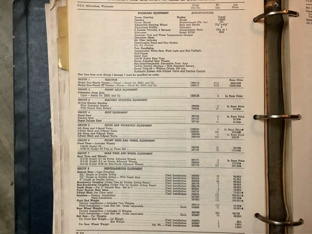

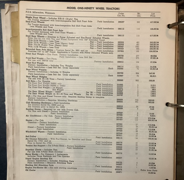

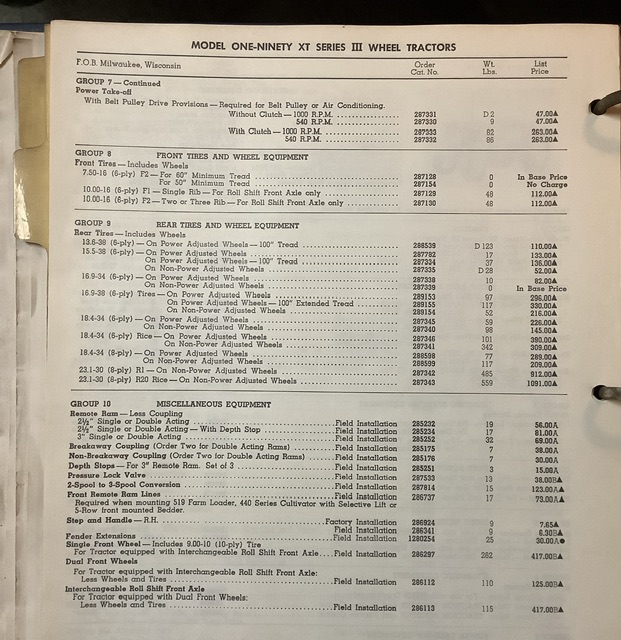

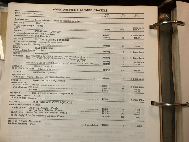

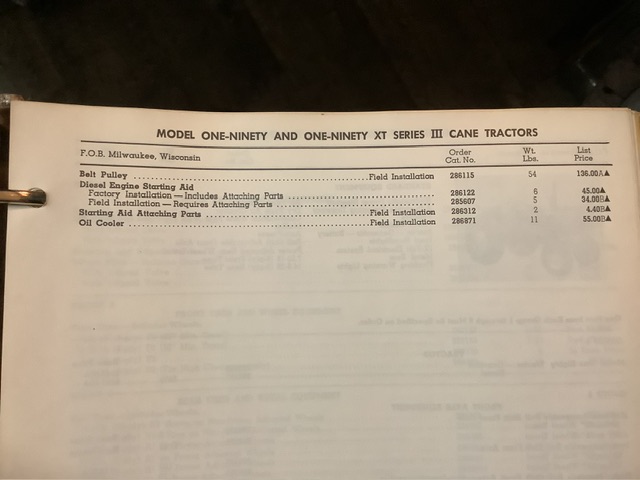

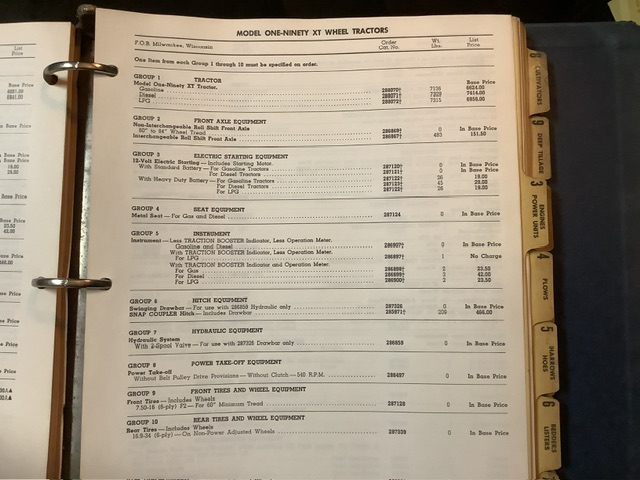

Points: 8901
Post Options Post Options   Thanks (0) Thanks(0)   Quote Mikez Quote  Post ReplyReply Direct Link To This Post Posted: 15 Jan 2026 at 7:32pm
Points: 8901
Post Options Post Options   Thanks (0) Thanks(0)   Quote Mikez Quote  Post ReplyReply Direct Link To This Post Posted: 15 Jan 2026 at 7:33pm
Points: 8901
Post Options Post Options   Thanks (0) Thanks(0)   Quote Mikez Quote  Post ReplyReply Direct Link To This Post Posted: 15 Jan 2026 at 7:35pm
Points: 8901
Post Options Post Options   Thanks (0) Thanks(0)   Quote Mikez Quote  Post ReplyReply Direct Link To This Post Posted: 15 Jan 2026 at 7:36pm
Points: 8901
Post Options Post Options   Thanks (0) Thanks(0)   Quote Mikez Quote  Post ReplyReply Direct Link To This Post Posted: 15 Jan 2026 at 7:40pm
Hope you can read all that. That’s all the 190,190xt pages from August 27/ 1969 price sheets

Post Options Post Options   Thanks (0) Thanks(0)   Quote DrAllis Quote  Post ReplyReply Direct Link To This Post Posted: 16 Jan 2026 at 6:34am
What I see is the 540/1000 RPM PTO wasn't even offered as an option in late 1969.
tbran View Drop Down
Location: Paris Tn
Points: 3631
Post Options Post Options   Thanks (0) Thanks(0)   Quote tbran Quote  Post ReplyReply Direct Link To This Post Posted: 16 Jan 2026 at 7:50am
Thanks Mike for posting that - should be archived somewhere - options are interesting - like fender extensions... RH step and handle.
