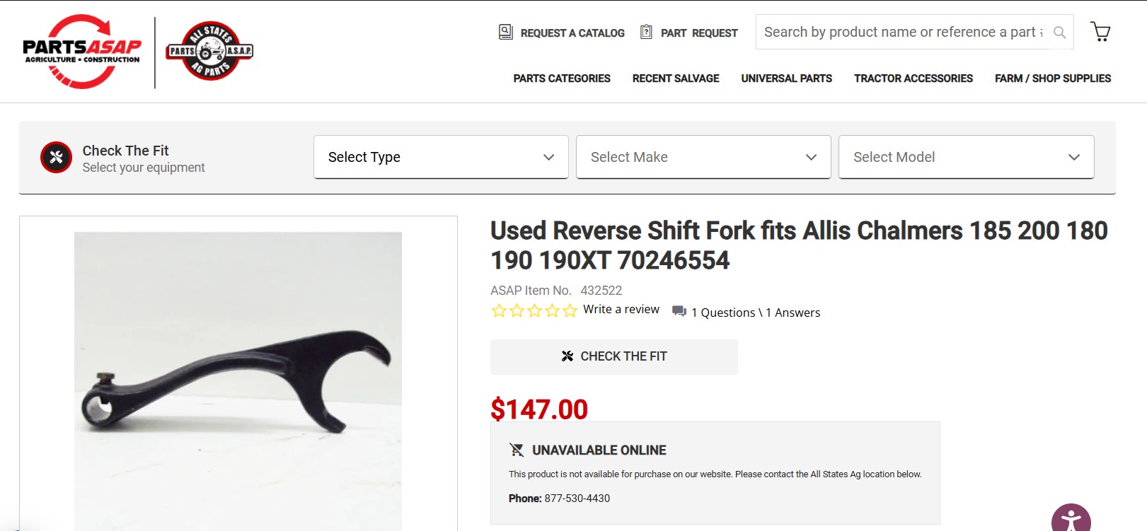

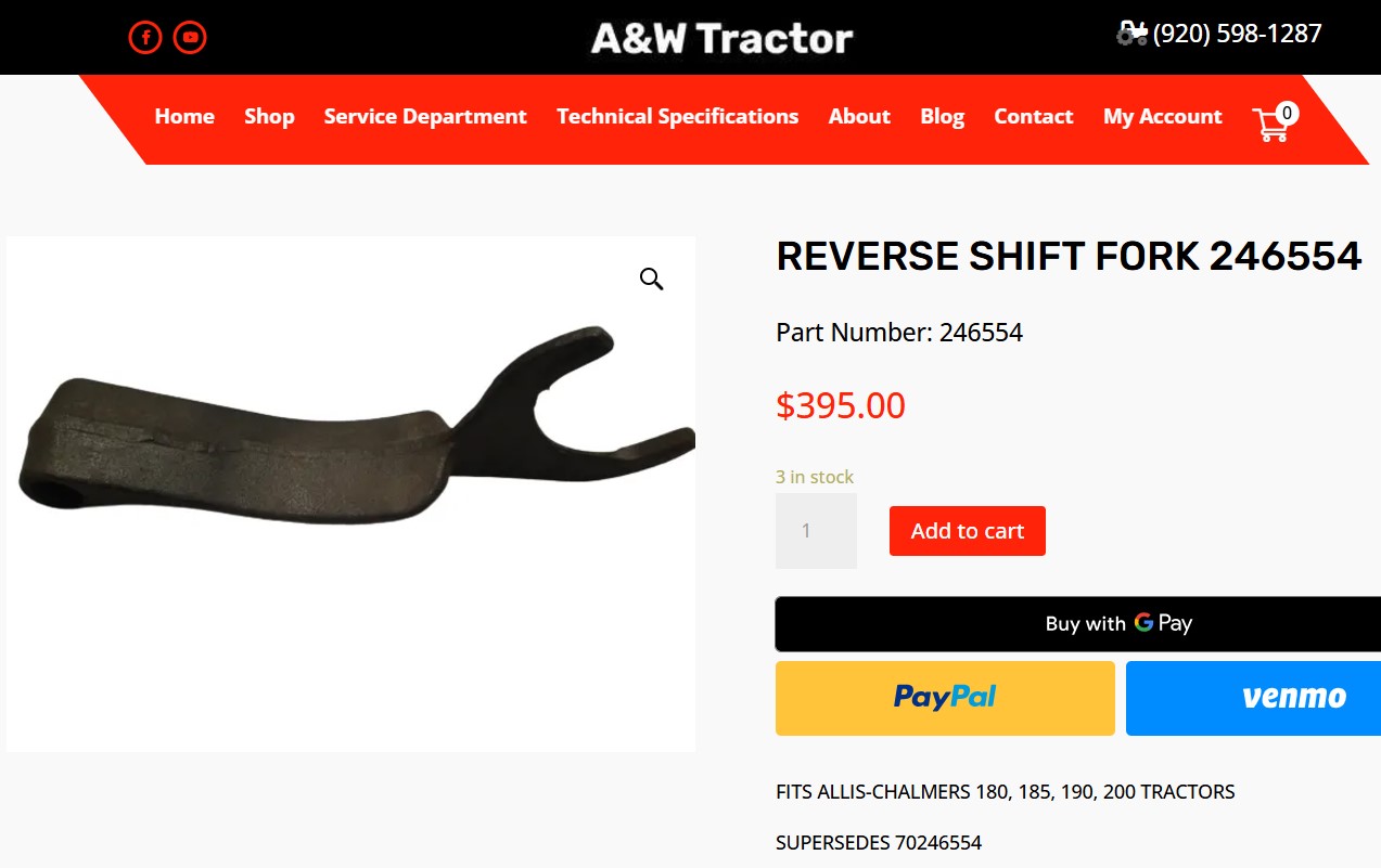

add a "70" to the front of that part number when you GOOGLE... A few used ones around but they sell pretty fast..... grinder has a GREAT price aat $50.
Points: 88632
Post Options Post Options   Thanks (0) Thanks(0)   Quote steve(ill) Quote  Post ReplyReply Direct Link To This Post Posted: 01 Dec 2024 at 8:11am
or NEW...
