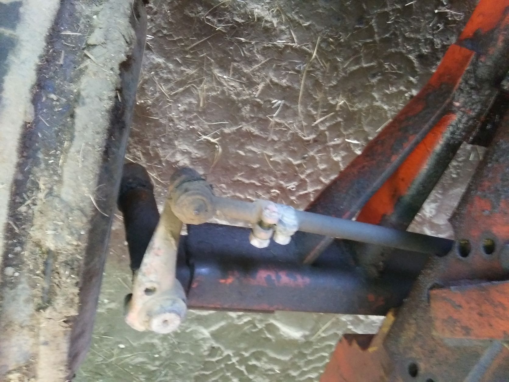

Mike, the AGCO clamps are heaver and better than the China ones. Look at the pic I posted the left is China the right is AGCO.  I haven’t bought any for quite some time so I don’t know how they are now

From my experience, the AGCO ones are more precise fit (less gap between the male/female parts). We sell the same one as all state ag parts, those aftermarket ones are hard to get tightened without slipping. As was mentioned, using the original clamp on the aftermarket tie rod helps.
