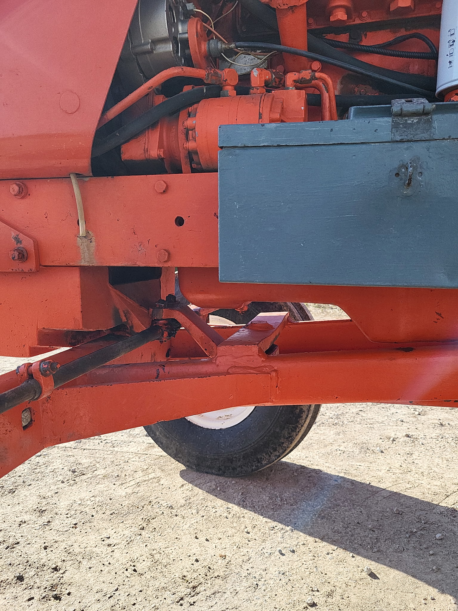

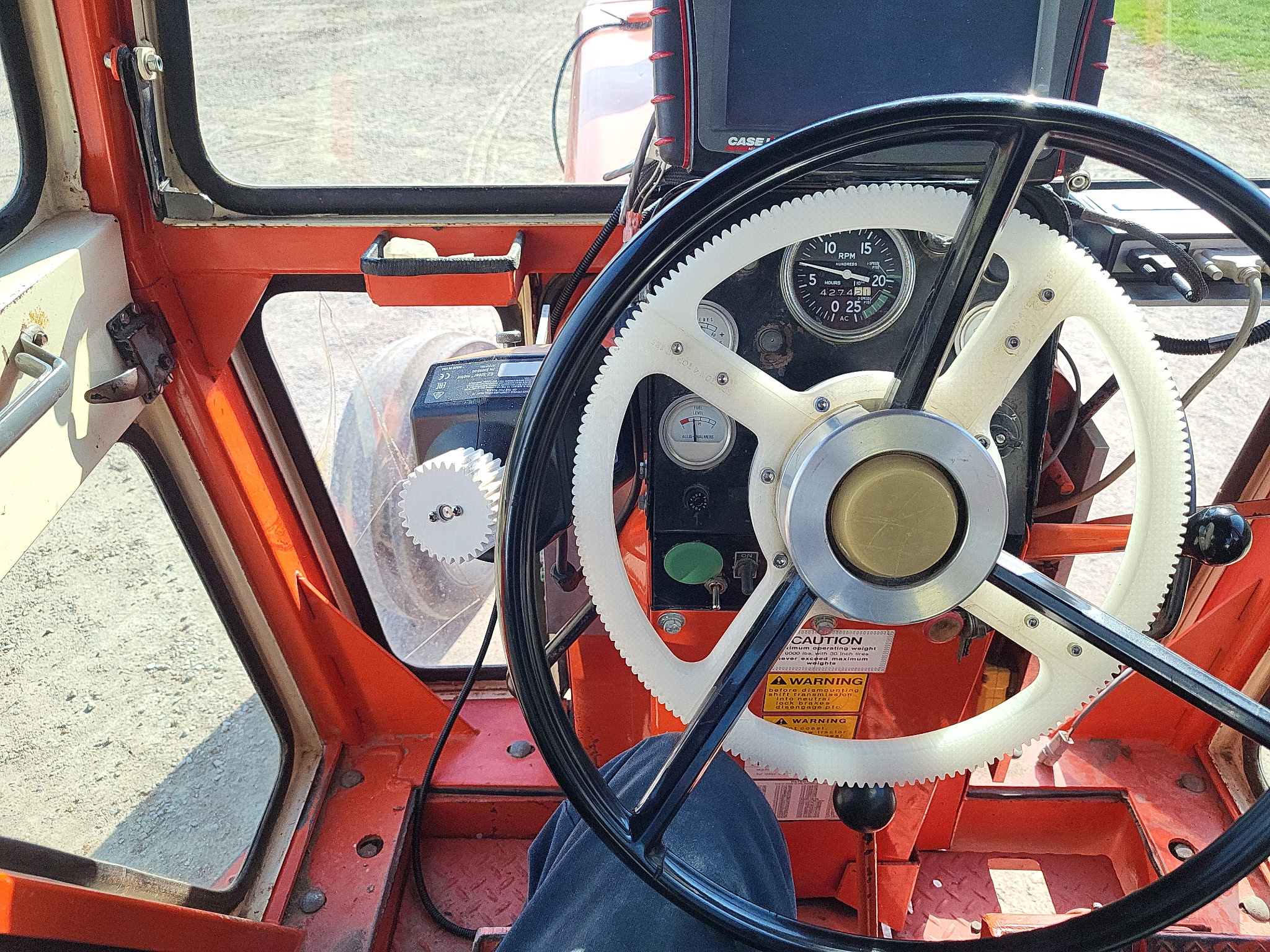

uploads/21385/1000006431.jpguploads/21385/1000006433.jpg
No extra weight, its a spray tractor so we want minimal compaction.  It's a 1979, i believe, SN8143.  I made 3D printed gears for all tractor to alliviate any slippage.  The force to turn seems constant at high RPM, no where near as easy as our 7000 or 200.  According to the sevice manual the PSI for the steering shoulf be 1550 +- 50 psi gonna check that.

Tested the steering on the ground stationary, took between 500 and 800 psi to move steering , depending on how aggressively we moved the wheel.  When we reached full travel the guage read 1600psi.  We jacked up the front end and tested, took between 400 and 600psi to move steering.
The spindles and tie rods are well maintned and lubricated frequently, they dont seem to be causing the issue.
We believe that the pump and relief valve are fine.  Wether in the air or on the ground, the difficultly to move wheel seems constant, so we are leaning towards removing 2 of the leaf springs in the orbitol motor.
