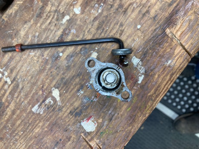

Post Options Post Options   Thanks (0) Thanks(0)   Quote captaindana Quote  Post ReplyReply Direct Link To This Post Posted: 09 Feb 2023 at 7:27pm
Yes Dr a spring and 4 washers, 1 of them really thick

Post Options Post Options   Thanks (0) Thanks(0)   Quote DrAllis Quote  Post ReplyReply Direct Link To This Post Posted: 09 Feb 2023 at 5:13pm
No spring inside of that aluminum cap ??

Post Options Post Options   Thanks (0) Thanks(0)   Quote captaindana Quote  Post ReplyReply Direct Link To This Post Posted: 09 Feb 2023 at 3:39pm
Maybe difficult to see but inside the plunger cap I removed are these 4 washers, one of which is very thick. Book doesn’t show any, what gives??
Blue Skies and Tail Winds
                          Dana

Next valve section over from the TEE handle, directly above the acorn nut, remove the two allen screws and the short aluminum cover and spring. Drive the plunger forward until the snap ring is seated. Arms should now be able to go down.
