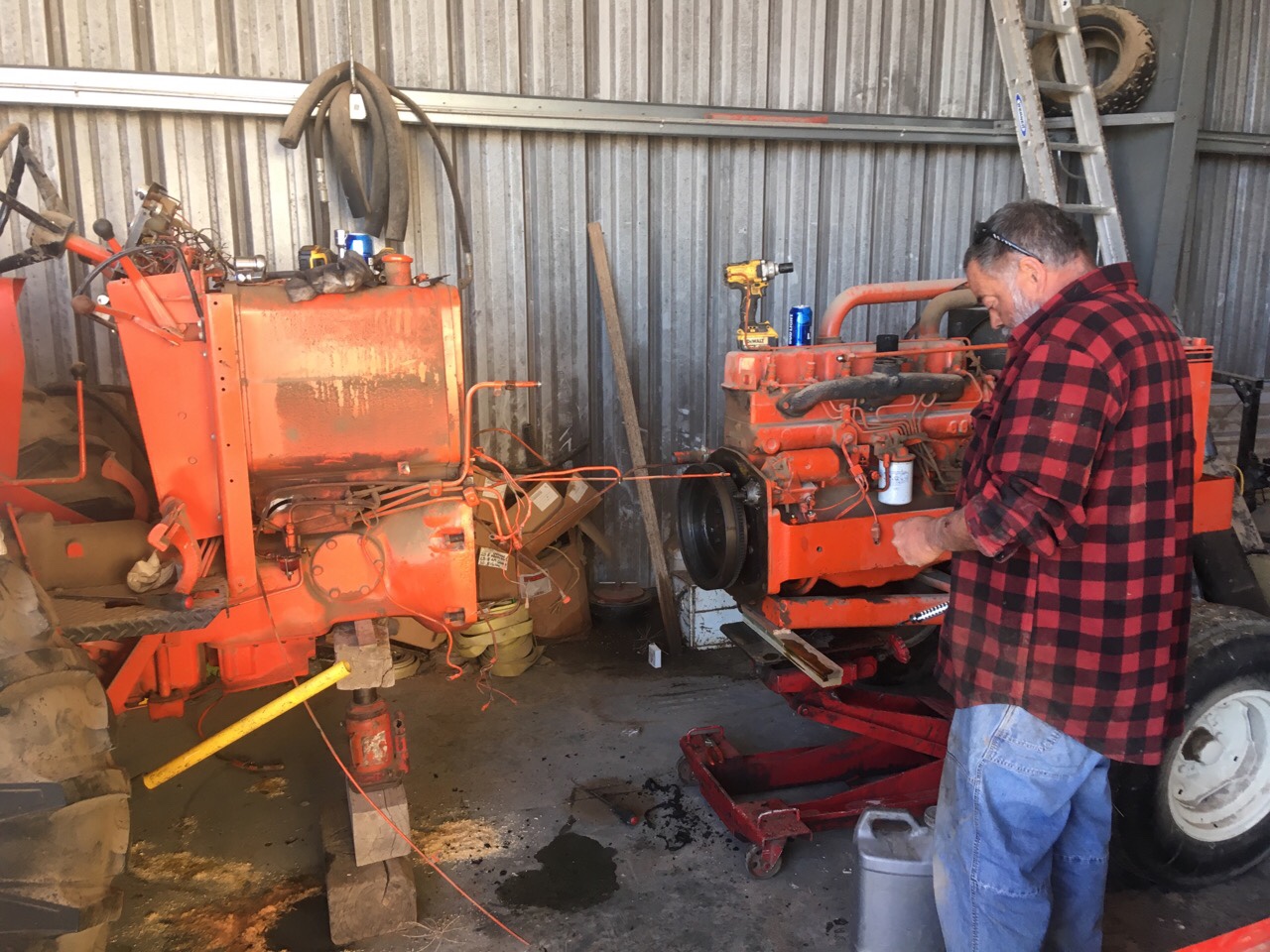

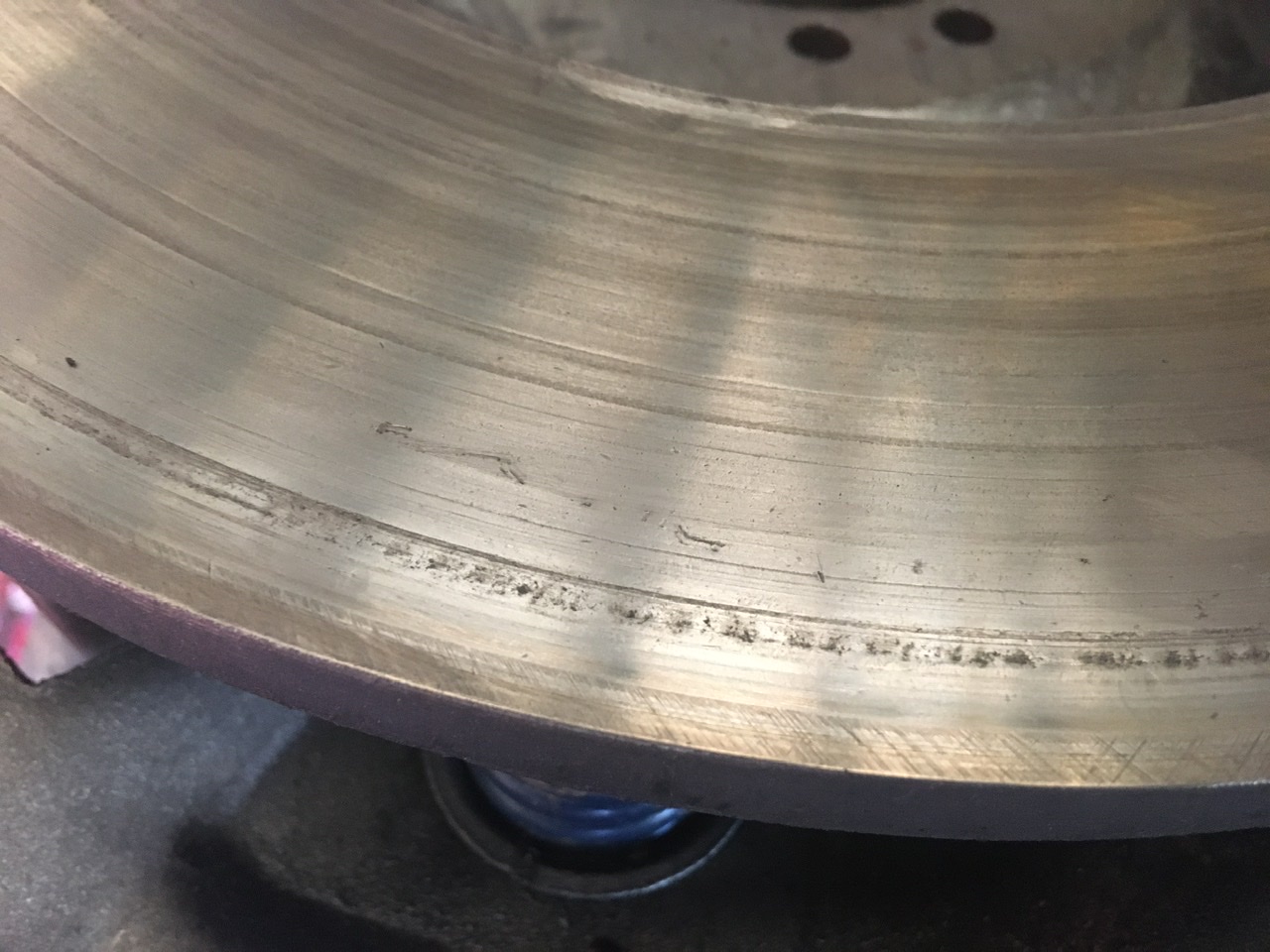

So I was mowing awhile back and as I bounced through a hole the tractor stopped moving. Couple times with clutching and away it went. Then it came to a halt for good and I heard the clutch throw some shrapnel. Anyway I have it split planning on getting a clutch ,pilot bearing and throw out. However I can’t see anything wrong with pressure plate but it has a pretty good grove(to me) cut in it from a spring or something. I only use it to mow and run the hay fluffer so it doesn’t need to be perfect but the mower will pull from time to time. Just wanting opinions on pressure plate. See picture below, it’s the worst grove, hopefully it’s nothing and I’m too paranoid. Flywheel looks perfect.
Oh you can see wear in center of pressure plate but I don’t see this as a problem as there should never be pressure there or maybe not?

Oh, disregard those Budlight cans, we never drink while turning wrenches they were just oil catch cans.  There just happened to be some oil dripping from the roof that I didn't want to get on the tractor.Wink LOL

I would put a new pressure plate while you are already in there.  The grooves might cause uneven wear on the new clutch plate.

You need to have the entire clutch rebuilt to do the job right... Pressure plate groove is from the button pads wearing into it and needs to be resurfaced, along with the flywheel...the disc is obvious, throw out bearing and pilot bearing. I can do the job for 225.00, plus whatever the shipping charges might be...you can have the flywheel resurfaced locally there and save money on the heavy shipping charges. You're already that close to having the flywheel off with taking out the bolts, so why not have it turned and it'll last a long time? Send me a private message, if interested...Rick

No way I would split a tractor for a clutch disc and not replace Pressure Plate and both bearings, and by all means resurface the flywheel.
Remember that whatever is removed from the clutch surface of the flywheel also needs to be removed from the pressure plate mounting surface.  There is a specification for that dimension.  I don't have access to the manual now but others will know the dimension.
Also, if it were me, and if you are not going to be using it for heavy draft loads, replace the button clutch with a fiber lined disc.  It will engage much less "grabby" than the button.

The flywheel step is 1.437 and what is taken off the face of that is also taken from the top flange of the flywheel where the pressure plate mounts...flywheel depth...

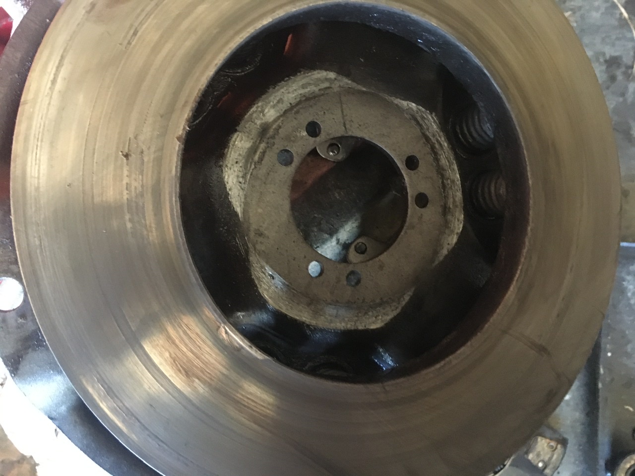

What's your thoughts on the wear on the pressure plate housing?  Probably just get a new pressure plate?

The pressure plate can be resurfaced, not a problem at all and can have the thickness brought back to where it should be by using thicker pads to pick up the difference, but it NEEDS the flywheel to be resurfaced, so that the buttons can seat in good. Take the flywheel to a machine shop that actually resurfaces flywheels...they do a far better job than a lathe...and will put the correct cut on it to knock off the high spots on the buttons...

Rick, I understand that but my concern was where the pressure plate back is wore in the center, the metal is pretty thin in that spot.(picture 2)

Okay...I never saw that...that's where the loose center hub out of the clutch disc slung around inside there and cut a pretty good groove in it...it's okay, as I do have another unit I can use (core) and just use the parts out of your old one later...pressure plate, cups...things like that...

Standard procedures while tractor is split: #1. replace clutch disc and pressure plate. #2. resurface flywheel.  #3. replace rear crankshaft seal and wear sleeve.  #4. replace clutch shaft seals(s) and gasket. #5 replace throw out brg.  #6. replace pilot bearing. ..  Anything short of these things and you will one day have to get back in there for something.

dont forget to turn the ring gear.  by now i am sure one side is wore out or has some  wear spots wear the engine always stops.  theres nothing more annoying than a starter that will not engage

Any thoughts on why that clutch came apart.

Old age. Shock loads. Dumping the clutch. Heavy PTO loads. Many clutches fail like that in 4 to 5,000 hrs. How many are on it ??

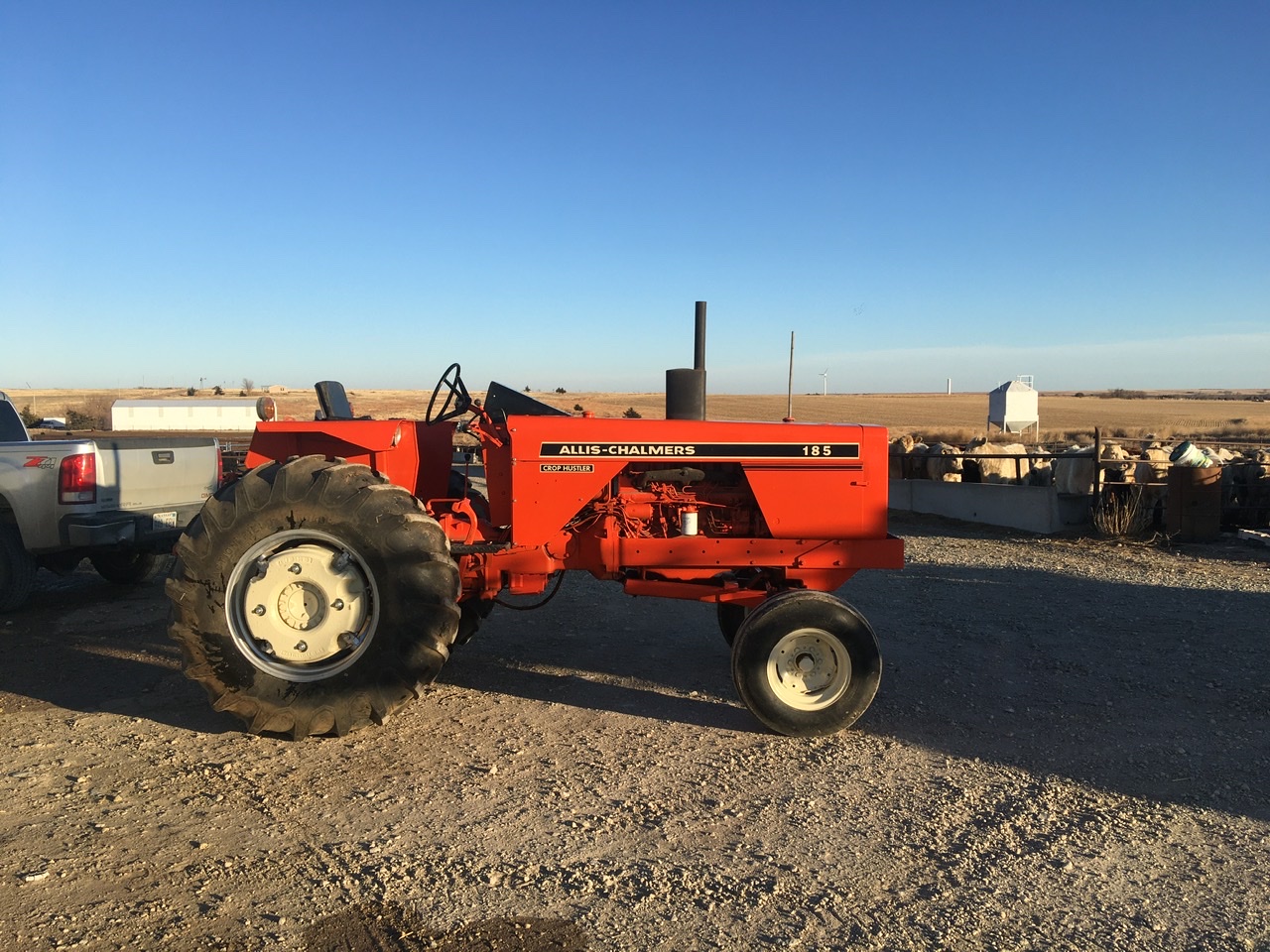

Got the 185 back together. Nice day today so went ahead and gave it a quick rinse. Took time to get a couple pics.
Even put a SMV sign on it so it’s road legal.

Be sure to adjust the clutch pedal free-play to 4 inches and that will give you many years of service life.  That's a sharp looking tractor and the OEM muffler always stands out compared to any after-market muffler.

I will check free play, I wasn't sure what it needed to be.  I have a fair amount but not sure if it's 4 inches,  I went till I knew the throw out was off plate but not a lot.

Oh BTW, and I'm not trying to criticize, but you should build a jack stand for that job. That blocking and bottle jack looks precarious. Wouldn't want a forum member to get hurt.
