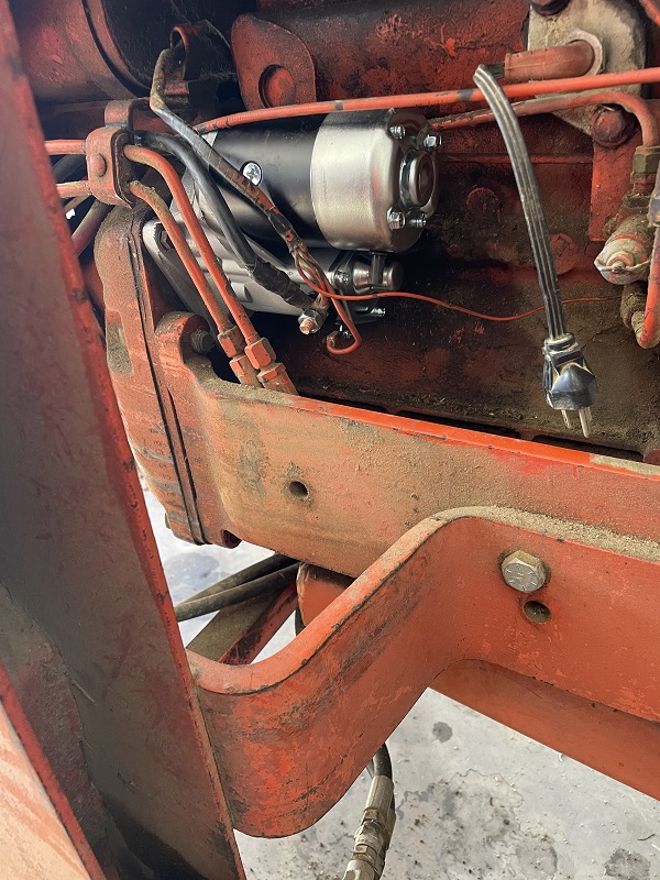

Had the old one off, New One was on in Minutes!!  Not ever had that easy a install.  Tractor cranked like not ever before started just fine so shut down and gathered everything up cleaned up, and tried to put outside to do some snow cleanup, won't crank, ammeter goes hard Neg past 60a, checked engine still turn by hand at fan so tried again, got to roll once then starter locked back up.
All States Ag getting a return slip sent out, shipping another.
Figures too easy, HAD to go south.

Post Options Post Options   Thanks (0) Thanks(0)   Quote Steve in NJ Quote  Post ReplyReply Direct Link To This Post Posted: 03 Feb 2026 at 7:46am
Dave,
Make sure your Battery cable is heavy enough. In your pic, the cable doesn't look like it's that heavy. Also, make sure the block has at least two heavy ground cables going from the block to frame rail. One on each side. The Starter may be searchin' for a ground. The reason why its rolling over slow. First, it Started right up, then it rolled over slow. Sounds like a ground issue to me or not enough current to the Starter. One or the other or both! HTH

Post Options Post Options   Thanks (0) Thanks(0)   Quote deckape Quote  Post ReplyReply Direct Link To This Post Posted: 03 Feb 2026 at 7:55am
It's alway the groud !   Check that connection at the eyelet  , looks iffy .

Post Options Post Options   Thanks (0) Thanks(0)   Quote Les Kerf Quote  Post ReplyReply Direct Link To This Post Posted: 03 Feb 2026 at 11:13am
... won't crank, ammeter goes hard Neg past 60a...
Hmmm...
In normal operation the solenoid is the only part of the circuit that draws current through the ammeter, the main starter motor circuit being outside of the meter. The massive amp reading indicates that the starter is indeed trying to pull current through the solenoid circuit, and the wiring is obviously not heavy enough to make it work that way (it isn't supposed to).
I am not familiar with this particular starter, but some of the new gear reduction units require a separate ground wire from the battery to a discrete lug on the starter itself because of the way it is designed; the traditional method of grounding through the chassis will not work if that is the case with this starter.

Post Options Post Options   Thanks (0) Thanks(0)   Quote DMiller Quote  Post ReplyReply Direct Link To This Post Posted: 04 Feb 2026 at 6:20am
Same Wiring the Lucas Had since built.  These starters draw less current than the OEM design do.  As to cranking Slow, it didn't, cranked faster than anytime I have ever started the old Gal.  Really shocked me as it did turn over so fast.
My Ammeter always went hard Neg during Cranking, just was cranking.  This time Starter was Locked Tight.

Post Options Post Options   Thanks (0) Thanks(0)   Quote DMiller Quote  Post ReplyReply Direct Link To This Post Posted: 04 Feb 2026 at 1:53pm
Bad new starter on way back to Ag Parts, next new one arrived Noon and On, NOTHING changed as to Install, has 15-20 amp draw during Cranking starts like not ever started prior, spins up Sweet and so far started let batteries recharge got back to low A input shut down and repeated three times. Just got a bad one first go round.

Post Options Post Options   Thanks (0) Thanks(0)   Quote DMiller Quote  Post ReplyReply Direct Link To This Post Posted: 04 Feb 2026 at 3:02pm
Motor was locked. Solenoid on starter sees hard battery power to motor. Ammeter sees what is moving across the line as high draw sucks from every circuit fed by Batteries. Two group 31 12volt.
Alternator feed is across starter hot post so will see system draw or feed.
