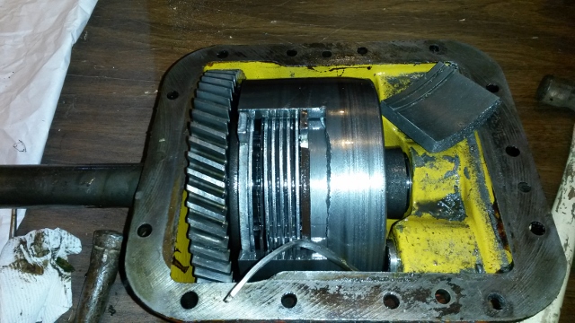

Post Options Post Options   Thanks (0) Thanks(0)   Quote ksbowman Quote  Post ReplyReply Direct Link To This Post Posted: 27 Jun 2019 at 7:48pm
Here's what mine looked like after I pulled it and I always adjust my mower clutches each year.

Post Options Post Options   Thanks (0) Thanks(0)   Quote Charlie (NC) Quote  Post ReplyReply Direct Link To This Post Posted: 28 Jun 2019 at 5:59am
Ouch, Thanks for posting the picture. That helps me.
