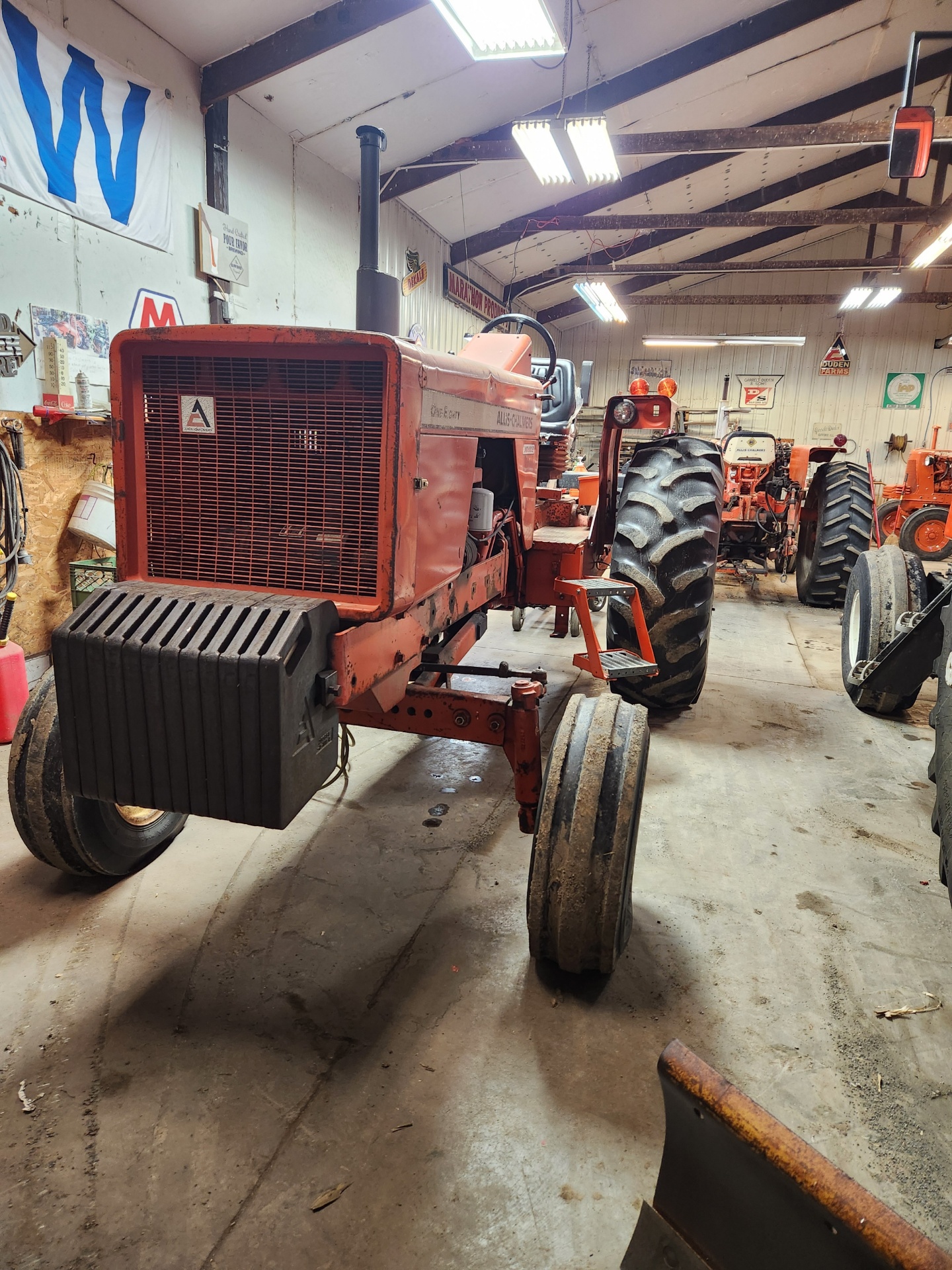

Painting my 180 and was wondering what color the grill insert should be? have seen white on some and some orange. Serial number 12162. Cloud white for front rims and rear wheel centers?

Creme on those parts. Not cloud white or new white. As far as the grille screen goes, I think creme. BUT, the 185 came out in late 1970 and had the new color scheme of an orange grille screen with black background hood decals. Your s/n is newer than 1970. I still think creme is correct, especially if the hood decals are creme background. Can't you tell what color the grille screen was painted originally ??

My old 180 appears OEM paint, and grill Grating area is same color as rest of Grill panel.

And, I suppose there's a chance the grille shell and screen were painted orange first and then the screen got masked and sprayed creme. Any 180 screen was creme until possibly very late after 1971 or so near the end of their production.

Looks like the grill screen was and still is orange. The hood decal was cream with black letters. Thanks for the info. Randy

Is the grill the flat front, shallow screen style like a 185? Those were all orange as far as I know, but many times us old farts remember wrong lmao! To me, all 180's would have cream decals and cream grill mesh with the older deep 190 grill shell. Could be like the 210 though, after 72, they got the shallow flat front grill shell with orange mesh. Never personally seen a 73 190D, but curious what style grill shell those had.

I checked my grill today. It was painter orange from the factory, so orange with the cream decal on it. Thanks again for all the info! Now i just have to get it ready for the GOTO at Penfield this summer.

That kind of confirms too, that all those grills after 72 were the flat front shallow style. I've also noticed the new style is made of a slightly thinner metal. Always figured they found a different supplier.
Hey Randy, which style grill is yours? And you had it a long time, and pretty sure it's original?
Went and looked your serial, and yours is indeed a 72, so yes, it should look just like the brochure Dale posted. I have never seen a 180 or 190 with that grill ever, I know those post 72 tractors are out there, but we rarely ever see them lol!
