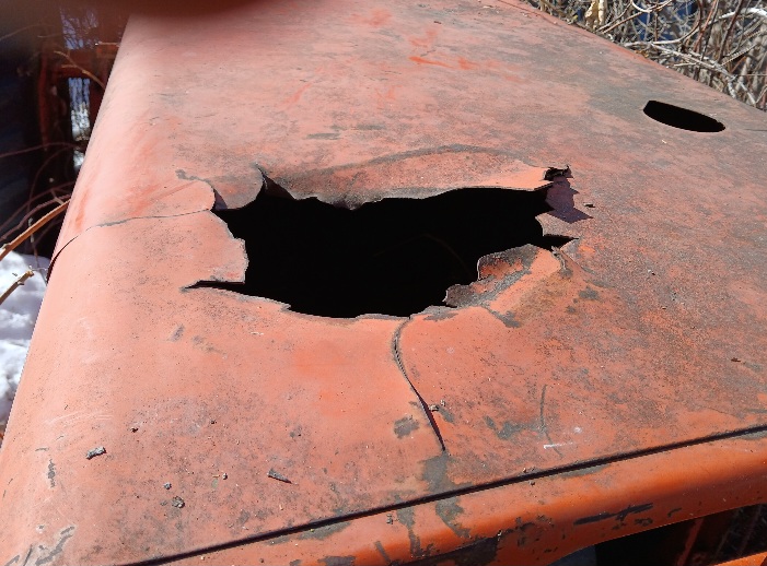

  IMO, don't need the precleaner unless you are in really dirty conditions all the time.
Worse, stacks will vibrate and shake until it breaks the hood out like pic below. Hood had a 20" stack with support plate bolted tight under it.

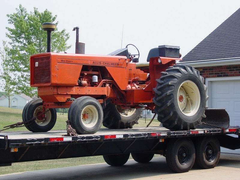

My 180D as we got it in '09, still same precleaner and stack is on it today.
