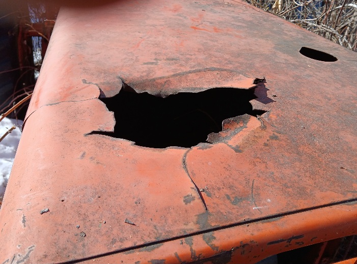

  IMO, don't need the precleaner unless you are in really dirty conditions all the time.
Worse, stacks will vibrate and shake until it breaks the hood out like pic below. Hood had a 20" stack with support plate bolted tight under it.
