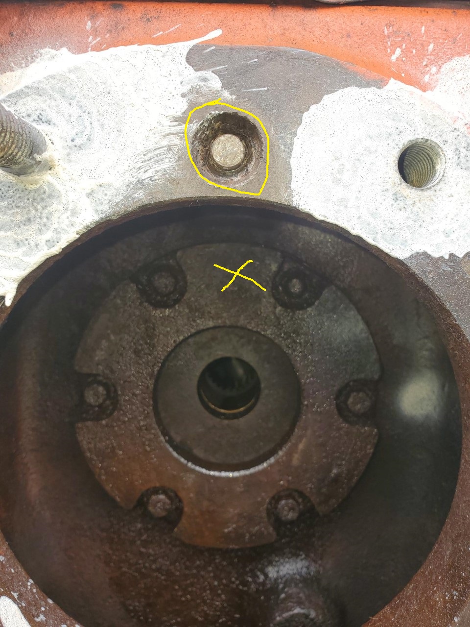

Hi all,
Anyone tell me the part number of the "X"??  Cant seem to find the part in my 175 parts catalog....also, helluva time getting the circled pin out.  Seems frozen good....

Looks like the differential carrier.

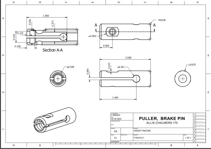

 I had to make a puller for a small slide hammer. One end has 3/8 threads which are not labeled on the drawing.

Thats neat Joe!
Know someone who can make me one?  $ for your trouble of course!

Part# 70237183. It may or may not be available and the cost could be high.  You could probably have your old one surfaced if that is the problem.

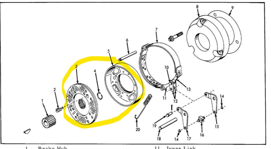

So I dont get confused as I easliy do, can you tell me below what parts you are talking about?
MACK View Drop Down
Joined: 17 Nov 2009
Points: 7664
Post Options Post Options   Thanks (0) Thanks(0)   Quote MACK Quote  Post ReplyReply Direct Link To This Post Posted: 27 May 2021 at 7:52am
Resurface #8 and shims are #9. Measure between #5 and 8.                MACK

Ok thanks...but part 5/3 slides freely off part 1....At least thats what it looks like as I am looking at it with whole thing taken off the tractor..  What keeps 5/3 in place?
Lemme guess...the snap ring!

Joe is there a bolt in that puller to pinch it closed on the dowel?

3 and 5 have to float that is what expands to apply the brake the bands only actuate that part to push apart. You brake against no 8 and something on the side of 3. Your clearance would be with 3 and 5 together not spread apart and between 8 and the housing or cover on the other side. Not familiar with the 170/175 but the 190 just has a cover

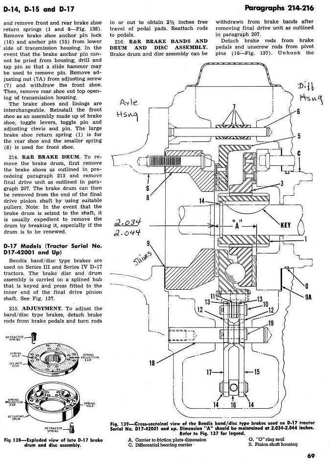

"Dimension between friction plates is suppose to be 2.034 - 2.044" -  you mean between parts 5/3 and 8 with 5/3 being closed?
Based on the other comment, there is a gap between the other side of 8 and the pictured part I posted?  How the heck do you measure that gap??

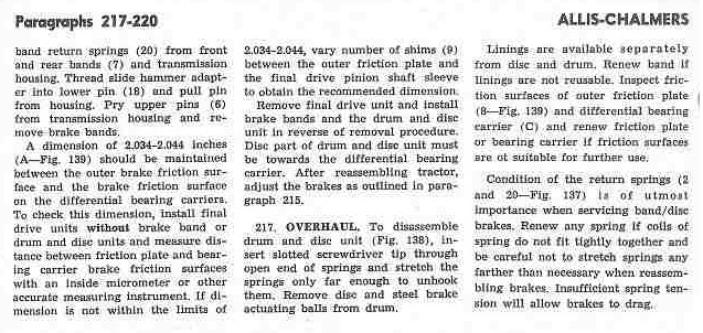

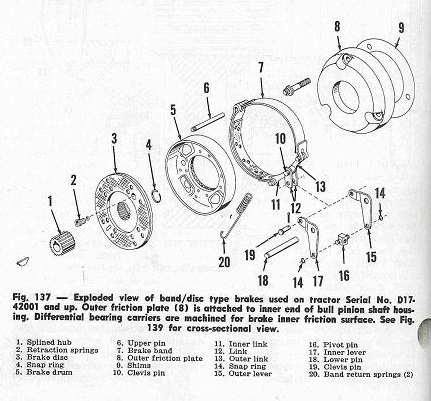

The dimension given is shown in 2nd pic
This is from an I&T manual for a D17s4 (and s3 if I'm not mistaken)
You won't find this in an AC repair manual.
I think they used this basic design in the 175
BTW, Tom, I have made an extraction tool like Joe's to get that *@!*$#* pin out.
I'll look to see if I had made an extra if you're interested.

I made one like the earlier posted drawing
