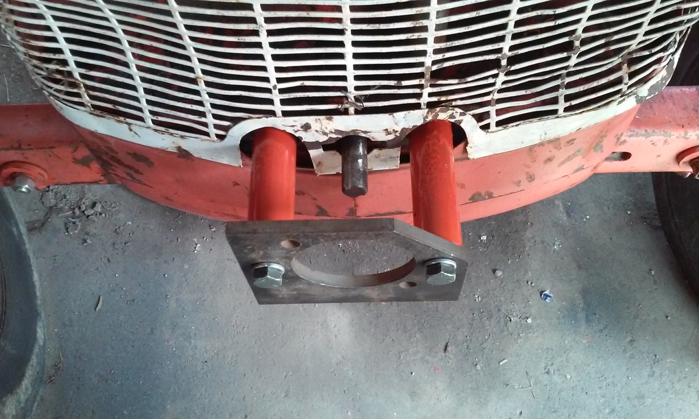

Get pump drive 1101-0404 off of eBay.  That bolts to your crank pulley.  Buy the shaft that goes with it.  I don't have a number for that as I had the shaft.  The pump I have is an Eaton 26013-LZC F140530FM.  I got it from Hyd Surplus.  Then all you need is the bracket to mount the pump.  It looks like this.  Good shop can make one if you give them the pump and the distance between the mounting bolts.

Joe(TX) View Drop Down
Location: Weatherford. TX
Points: 1682
Post Options Post Options   Thanks (0) Thanks(0)   Quote Joe(TX) Quote  Post ReplyReply Direct Link To This Post Posted: 30 Jan 2020 at 6:16pm
For the hub
for the shaft
These are Ford parts but will work on a D17
Factory setup used a chain coupling with a 10 tooth sprocket. I modified a standard #50 sprocket and shortened the chain. I got these from www.surpluscenter.com
I am working on making the plate and spacers.
