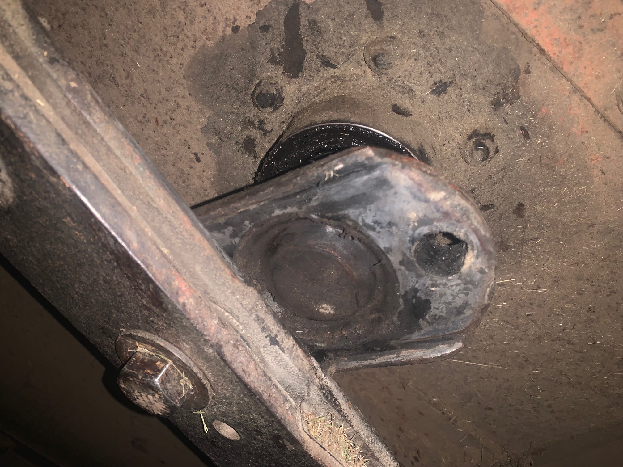

How does a person remove the shaft from a 172 Rotary Cutter for the purpose of replacing the bearing at the bottom of the shaft?  I am assuming to open the back plate of the gear box, but I am not sure what I will find when I do.  Is the bearing easy to come by?

you have to take the gearbox apart, theres a gear on the end of that shaft you need to pull off, so the shaft can drop out. There is a bearing behind the gear, and there is supposed to be a seal on the bottom of that housing, in your picture
