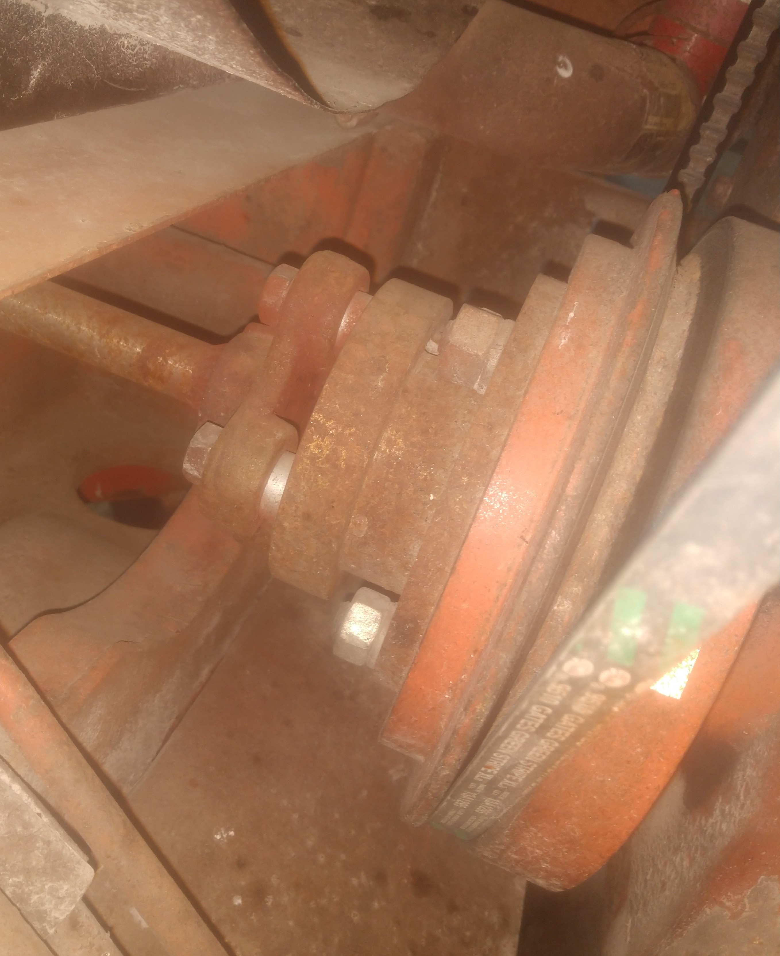

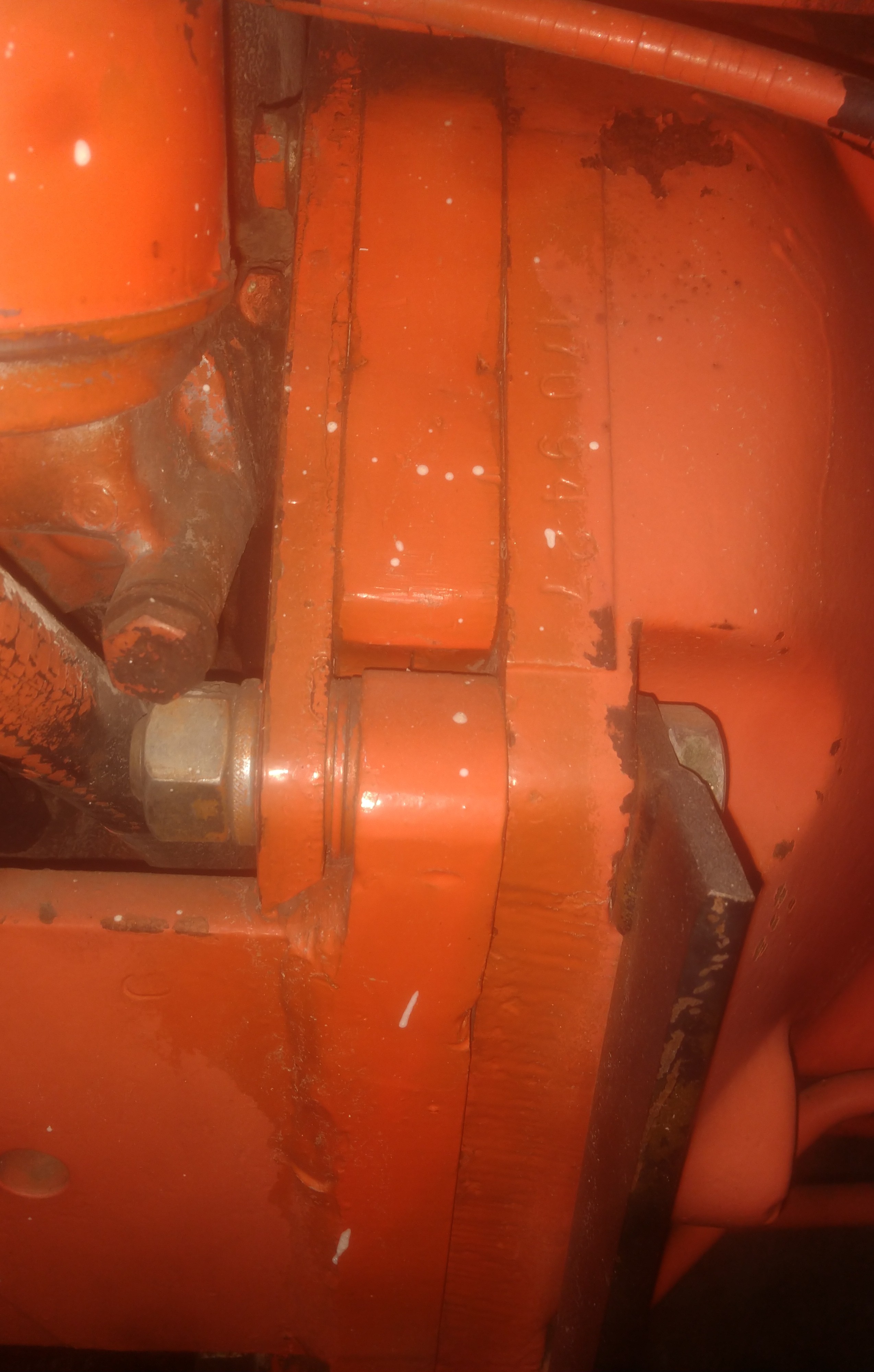

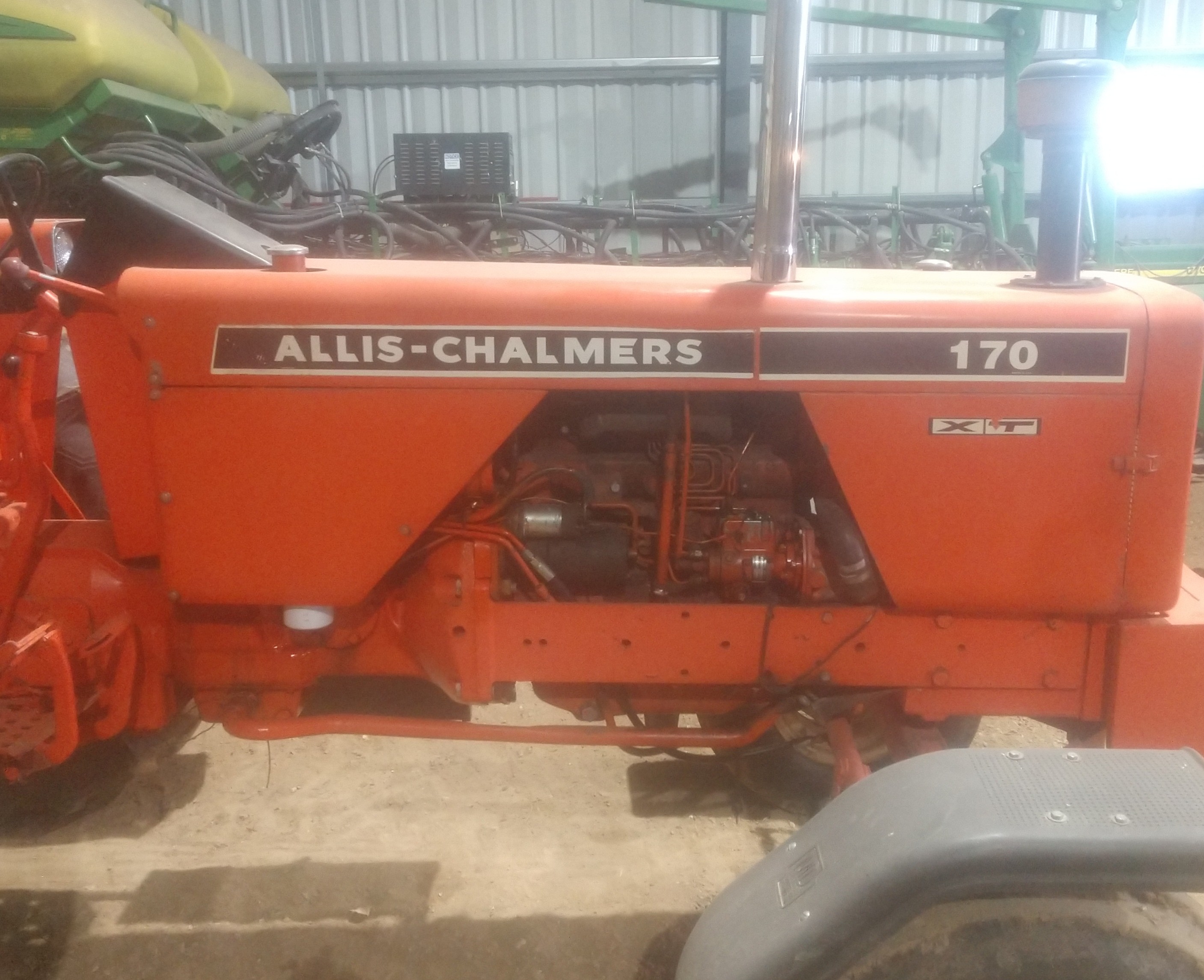

Some photos of a later one we did. 190 flywheel and clutch. If I remember correctly the adapter plate is 1 3/8" thick. Still had to grind a little in the bell housing for clutch to clear.
Edited by Chad S - 26 Nov 2021 at 4:33pm

Post Options Post Options   Thanks (0) Thanks(0)   Quote AC720Man Quote  Post ReplyReply Direct Link To This Post Posted: 27 Nov 2021 at 6:40am
That’s a neat combo, how long have you been running it with the 433 in it?

Post Options Post Options   Thanks (0) Thanks(0)   Quote Chad S Quote  Post ReplyReply Direct Link To This Post Posted: 27 Nov 2021 at 11:53am
It's probably been 8-10 years.

Thanks chad for the pics.   Is the plate on the back of the engine custom made or was it off a combine? Looks like it was a factory motor in those tractors!

Post Options Post Options   Thanks (0) Thanks(0)   Quote Kevin in WA Quote  Post ReplyReply Direct Link To This Post Posted: 28 Nov 2021 at 5:48pm
With the diesel clutch shaft the 433 with 190 flywheel, clutch and rear plate the 433 will fit, a gear reduction starter fits without grinding the housing also.

Post Options Post Options   Thanks (0) Thanks(0)   Quote Chad S Quote  Post ReplyReply Direct Link To This Post Posted: 28 Nov 2021 at 6:26pm
The rear engine plate is what was on the engine from a combine. It was the same as a 190.
