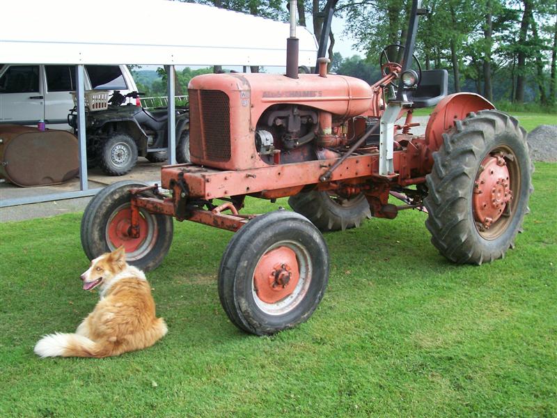

This was my "ROPS" on my old WD years ago. It was off a little Ford diesel. Made me feel safer anyhow PLUS was a great place to mount lights!
