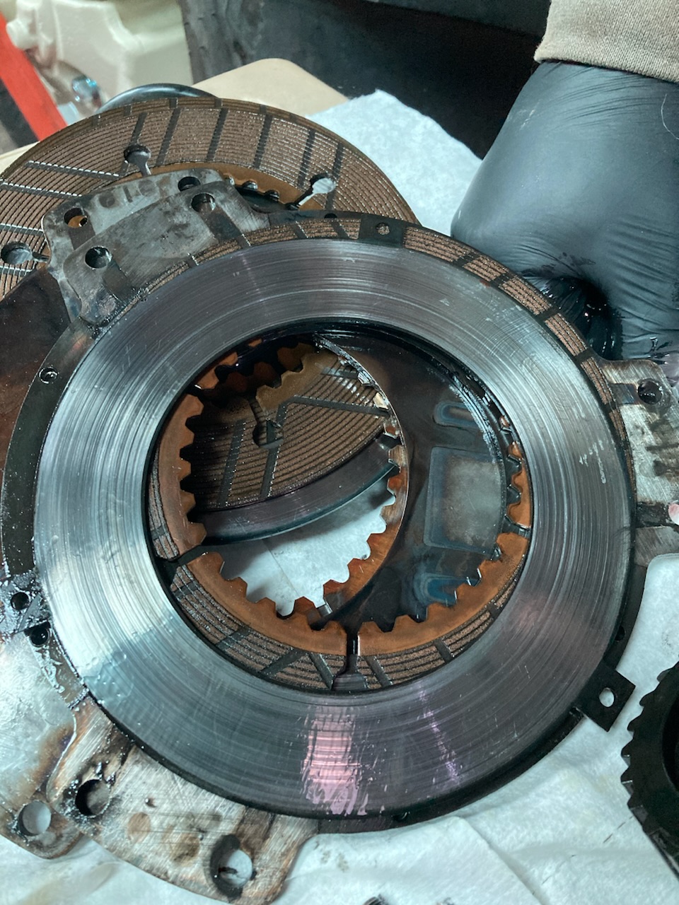

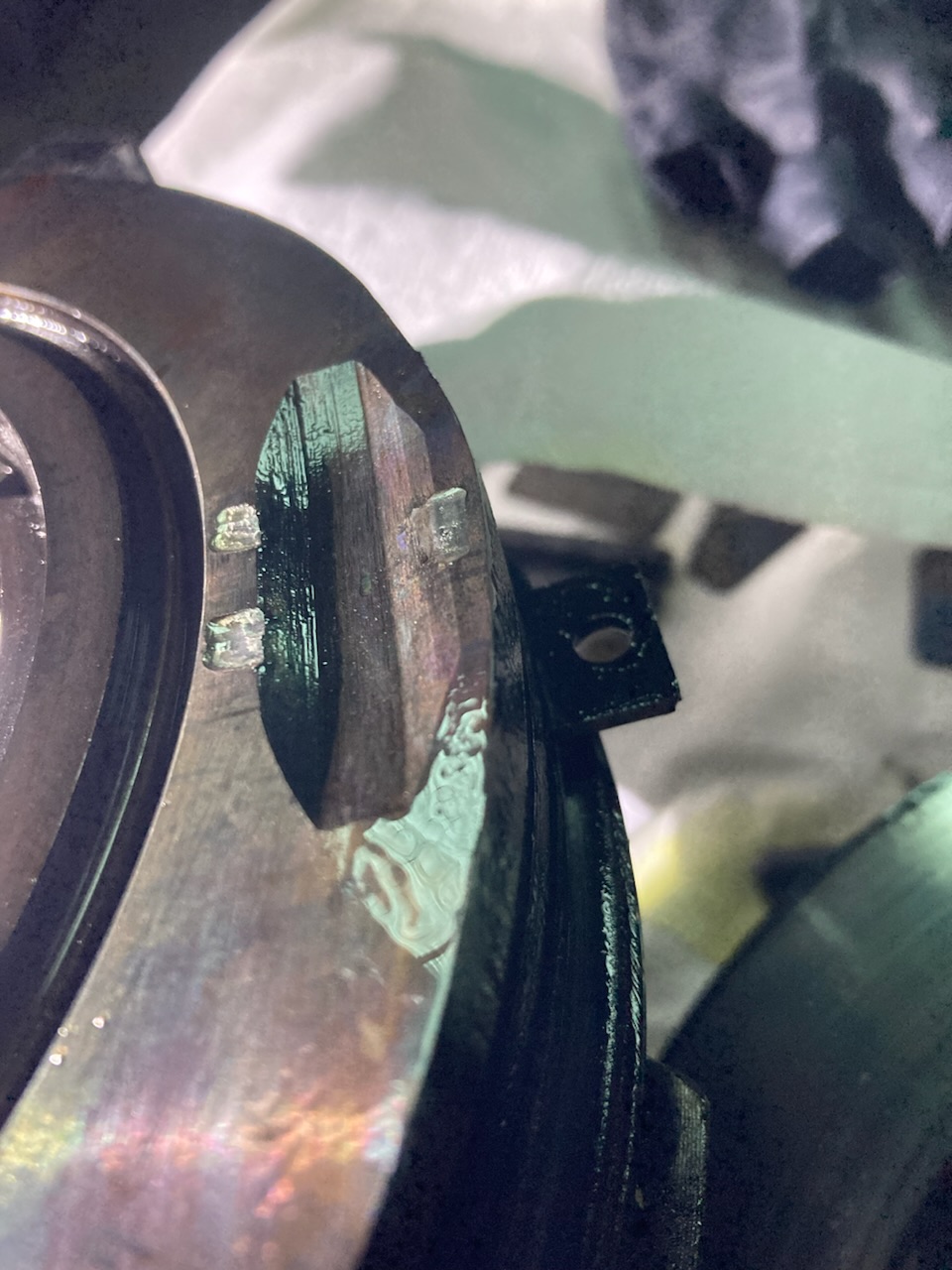

Here is image of my endplates

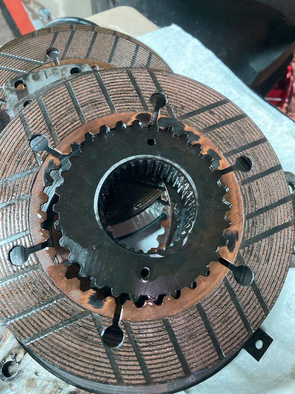

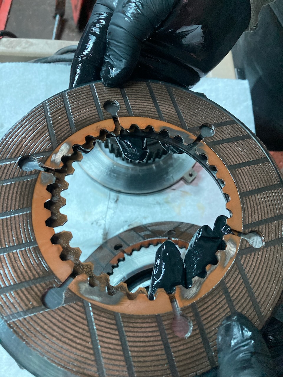

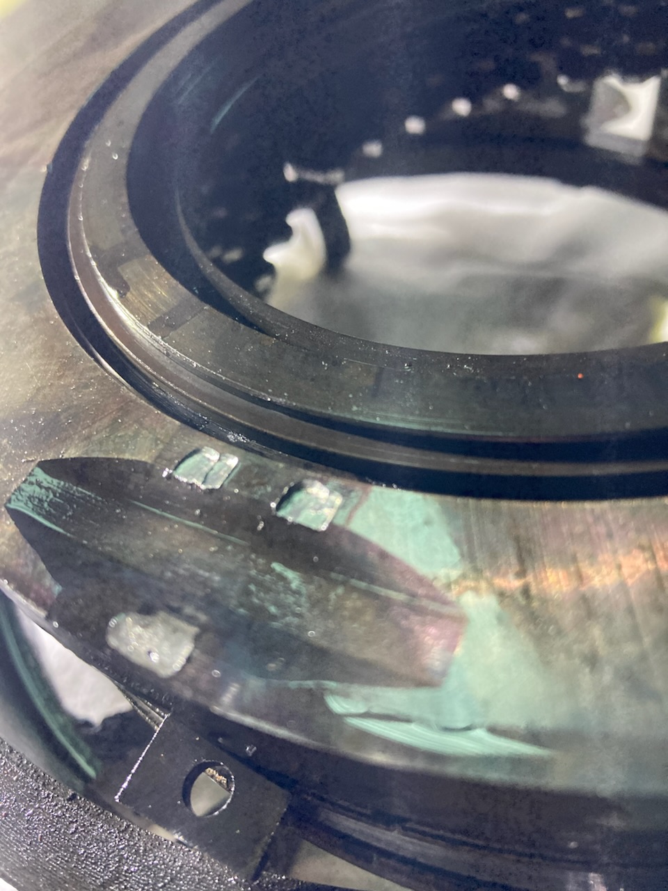

Also images of my clutch discs which i believe a couple have some warping it looks as if some of the plates almost have some rubbing on the inner centers by the splines

Normal wear on a clutch that has been used. Wear on the discs and plates are compensated for by short shim removal and replace the same amount back into the long center shim location. If you want all new parts, go for it. Anything warped should be replaced. If it was mine, new ramp end plates and rollers and adjust shims as required.

Post Options Post Options   Thanks (0) Thanks(0)   Quote D-SERIES Quote  Post ReplyReply Direct Link To This Post Posted: 22 Feb 2023 at 10:30am

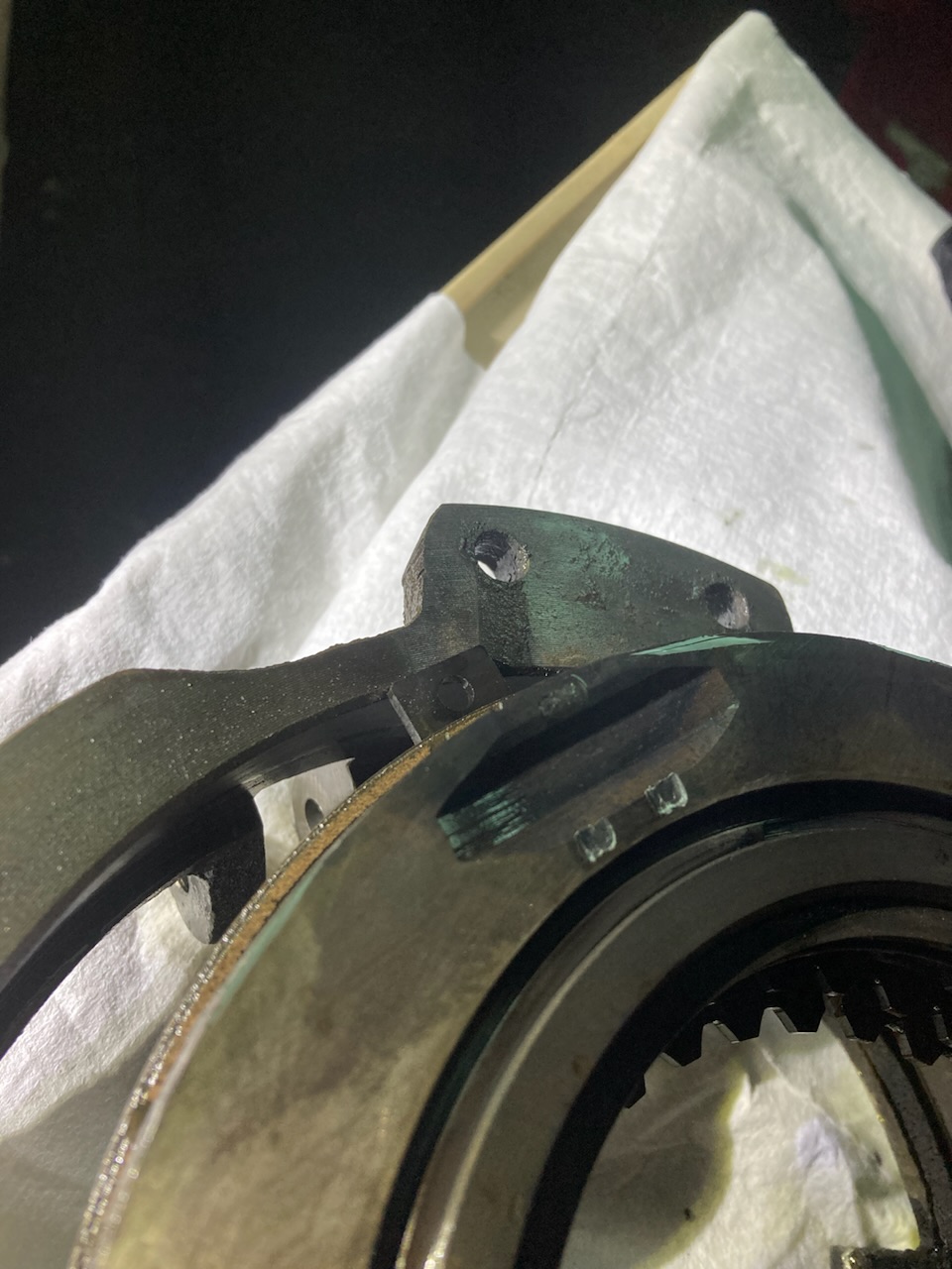

IF THE ROLLERS NEED REPLACED I ASSUME THEY WILL SHOW WEAR OR FLAT SPOTS CORRECT?  MY ROLLERS LOOK GOOD I THOUGHT I DIDNT REALLY SEE ANY WEAR ON THEM. BUT AS YOU CAN SEE THE RAMP DO HAVE WEAR AND WASNT SURE IF THAT WAS SEVERE ENOUGH TO WORRY ABOUT OR NOT BUT NOT SEEING MUCH OTHER WEAR THINK I HAVE TWO OR THREE OF MY FIBER DISCS THAT DO HAVE A LITTLE WARP OR CUPPING THE METAL TABBED PLATES LOOK GOOD AND DONT SHOW ANY WARPING
Points: 22827
Post Options Post Options   Thanks (0) Thanks(0)   Quote DrAllis Quote  Post ReplyReply Direct Link To This Post Posted: 22 Feb 2023 at 10:31am
Yeah. The short shims in the center shows that whomever did the "shim job" didn't have a clue. The way your ramp plates look, I'll bet it would jump out of gear at full throttle/cold oil. New ramp plates will tighten things up some. You might find yourself adding short shims back where they cam from.

Replace over center plates and rollers if they have flat spots or end pins broken off. Disks look like new. Save your money.                     MACK

Again, none of us are there looking and holding your parts, but make sure there are no driving discs or seperater plates that are warped !! Everything must be flat.
