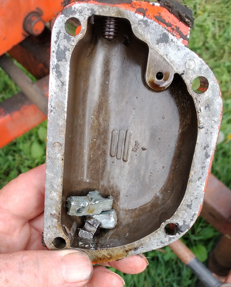

 Mack, That's what we would have expected, but when shrapnel piled up under the linkage, it couldn't shut down.
 This is what I found when taking cover off very carefully. I didn't place the broken parts in the cover.
 And under the fork assembly linkage.
Linkage was blocked from closing.
