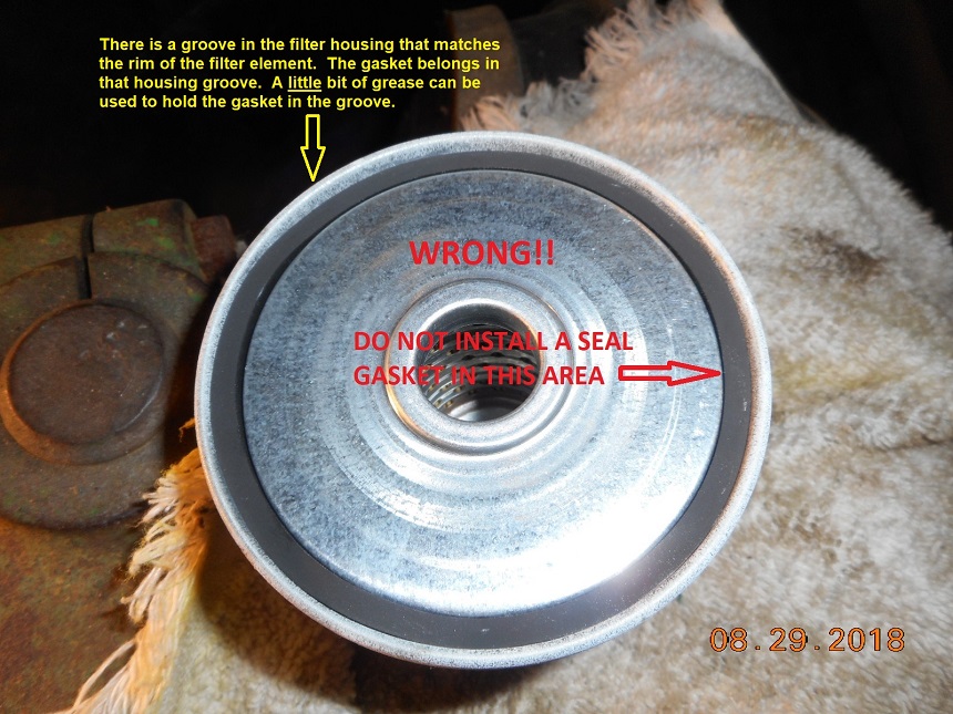

That has a CAV/ Roosamaster type filter doesn't it?  Did you use a WIX or NAPA filter? If so did you get the gasket in the right place?

Thanks for the advice.  Going to do some more troubleshooting today.  I used a NAPA filter and was warned about the gasket, i'm pretty sure i put it in the right place but will check.  I knew Massey used these engines a lot, we had a good local massey dealer i was going to talk to but he's recently closed up shop.

The problem with the filter with the slot isn't the filter itself, it's people putting the seal in the inside edge of the lip, thus blocking flow. The seal goes in a channel in the header assembly above the filter. When installed correctly, they work fine. The agco filters with all the holes is probably a better deal though.

As injpumpEd said; The problem isn't the filters it is people putting the gasket in the wrong place.  It's been done may times, and sometimes they drop down during installation and don't get noticed.  I've used the WIX/NAPA filters for years without problems.  A dab or two of grease holds the gasket in the groove of the head during installation.

Did you remove the old gasket? Sounds simple but it's happened in all makes and models.     Leon
