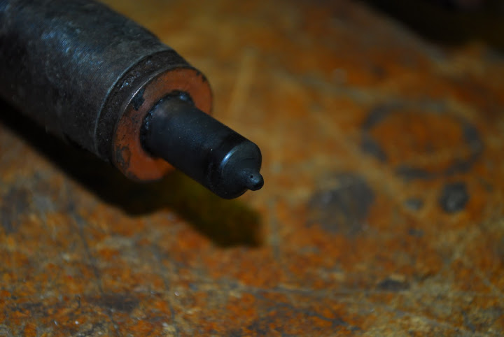

I have pulled the injectors off and will have pictures posted in a moment. They are pencil type injectors and are covered in soot. I cleaned off one of the injectors, the holes are visible and do not appear to be damaged. I'll post the pictures and let you guys tell me what you see if I'm missing something.

Any comments on the injectors? I didn't see anything that made me think they are the problem but I'm really not sure what I should be looking for.
I am in the process of removing the oil pan. Unfortunately I have to remove a loader cross beam before I can finish so it will take a little longer than I had expected. I will update with my findings once the pan has been removed.

I don't see anything with the injectors. I'd pull the head and look for any scuffing on the cylinder walls.

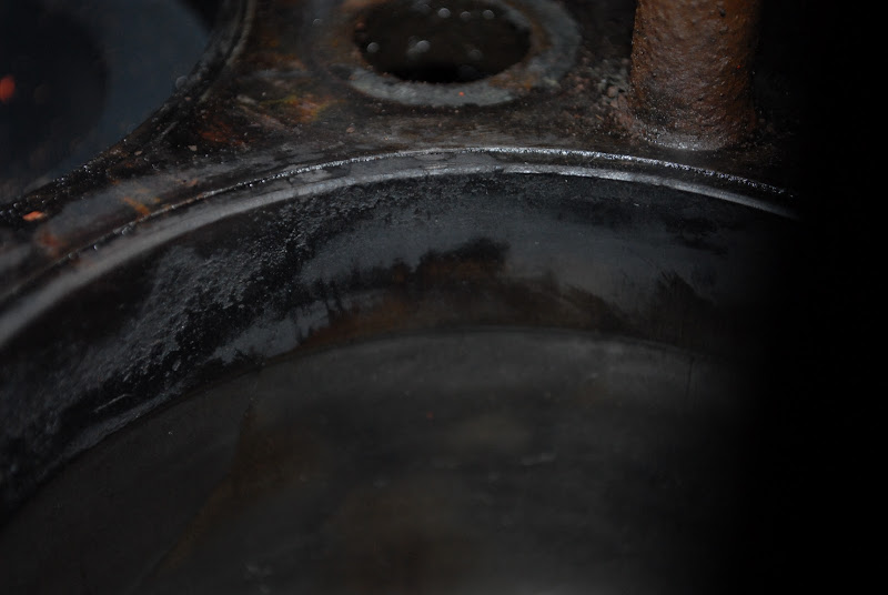

We were able to get the head off today. It just took two of us and four pry bars to move it slowly and gently up the studs, keeping it aligned the entire way was the only real challenge.
What I'm seeing so far is a crack in the cylinder sleeve (I hope that's the right term) on the cylinder furthest forward. I'll try to get some good pictures posted. The crack extends to the top of the cylinder and is around 1 1/2" long.
Pictures will be coming soon.

Was it running hot? If that is a wet sleeve I'd be expecting to see coolant in the combustion chamber and wanting to push coolant out the radiator overflow.

those are dry sleeve engines.

Looks like time to rebuild it or figure out if your going to use your other 160 to make one good one.

Id say you spun a bearing Erik.  When the eng pulls down and smokes, thats never good, probably spun the bearing at that point.  the cracked sleeve isnt gonna make it pull down as a rule.   You need to pull some bearing caps to see what spun.   Your looking at a major rebuild on the bottom end and at least one sleeve, probably should go with new sleeves and pistons too.   Good luck
