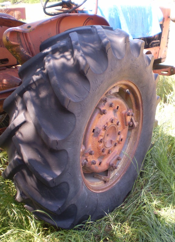

Regarding rim width. They are suppose to be on 14 - 15 wide rims. I have my D 17, 16.9 tires on 13" wide rims and they work really well at 14 lb, pressure with 400 lb, per wheel weights. I also put 16.9's on my 850 Ford, with 13" rims. I have 700 lb, per side weights on it and run it at 12 lb and it works fantastic.
I've seen 16.9's on 12" rims and I think you could get by with it, especially if you can run lower pressures. My D 14, came to me with both 14.9 & 16.9 x 26 tires, both sets on 12" rims but, I haven't run it yet, it has a bad engine but, it doesn't look out of place.

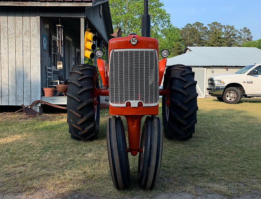

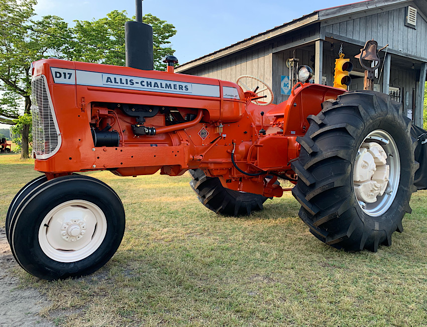

Here is my D17 with 16.9's.

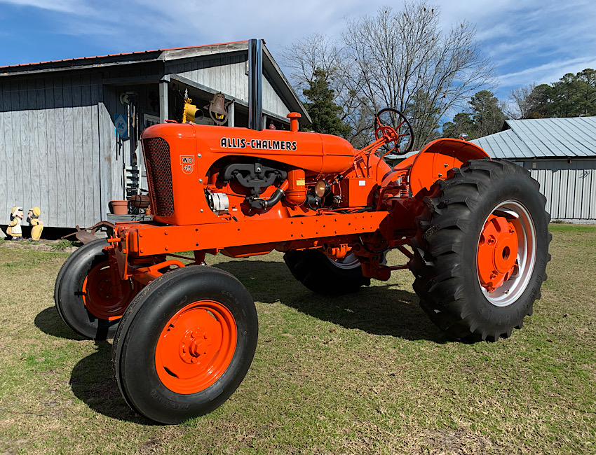

Here is the WD45 with 14.9's

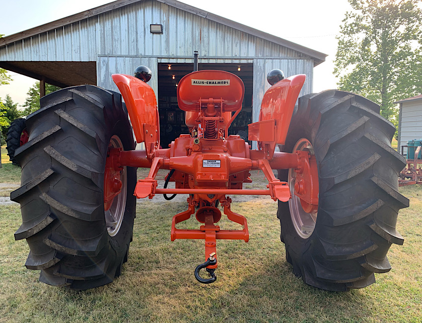

Here is a rear end shot:
The 16.9's would work fine, but as mentioned you may need to be at a 14 or 15 inch wide rim.

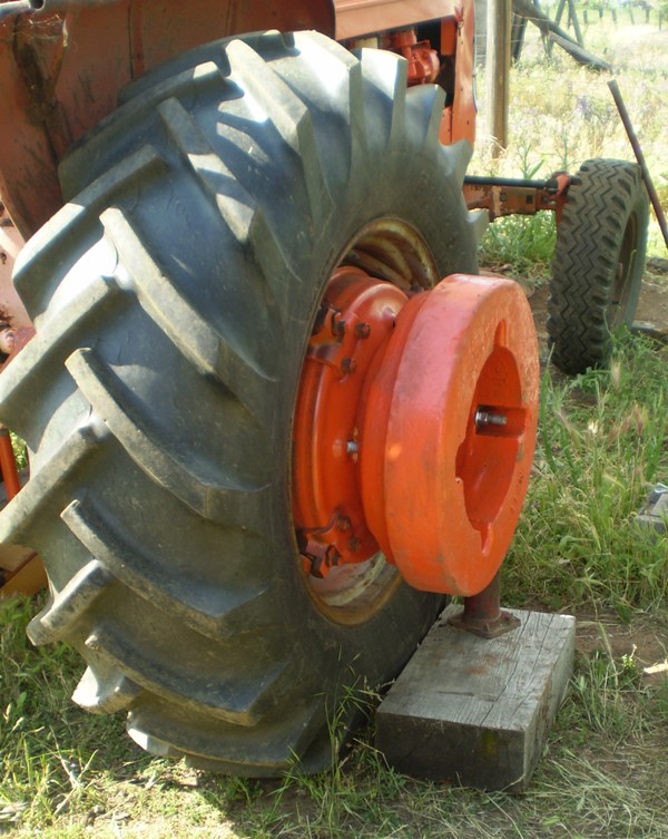

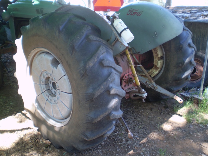

This is my D14 with 16.9 x 26 tires on 12" rims and a picture of my 850 with 16.9 x 28 tires, with 525 lb outside weights and 220 lb insides, @ 12 lb.

You have a 16.9 problem!:) I like the look! That Ford has a lot of rubber on it!
Those pie weights look good too!

LOL Thanks Chris. It's the one I placed 2nd with in last years pull but, with 14.9's and the small (30 lb, 450 lb per side) weights and no enter weights. No pulls this year though :(
Those pie weights, were a LOT of work!! I had to first sand blast the extremely rusted  mounting plates (I hate sand blasting) and clean up everything else on them.
Mounted the inside weights and tires on the tractor, then the pie weights. 45 lb each, doesn't sound like a lot but, there are 24 of them and they barely fit, inside the rims. I painted everything up good, hoping I never have to do it again.
