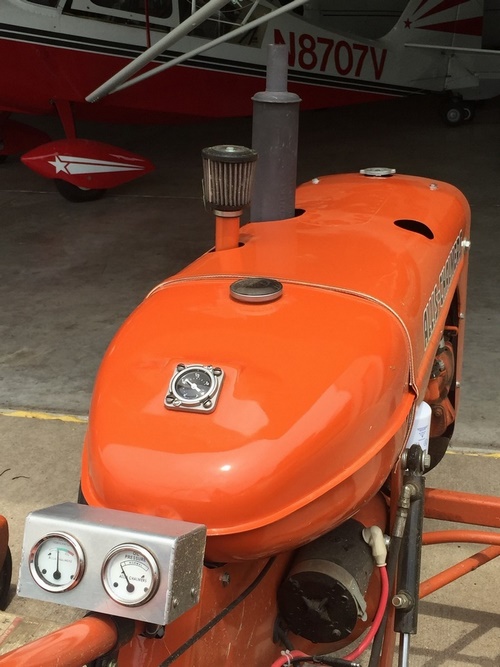

I put a D14 149 engine in my lowered B for mowing. These are some of the things I needed to do. The 138 eng. should be all the same.
Had to use the B fan, and the B flywheel and clutch. The D14 manifold required moving the muffler hole a little bit. The B air filter will not fit with the D 14 manifold so I fabbed a new tube and used a K&N filter, and moved the hole in the hood. Made a instrument box mounted on the steering column for the temp and oil pres. Needed to drill out the holes in the radiator mount to the engine to 5/8". I made a patch to cover the B temp gauge hole and oil cap hole. I also added the fuel gauge mount from the D14 tank, of coarse not necessary.
That's all I can remember, it all worked out well, have fun.
