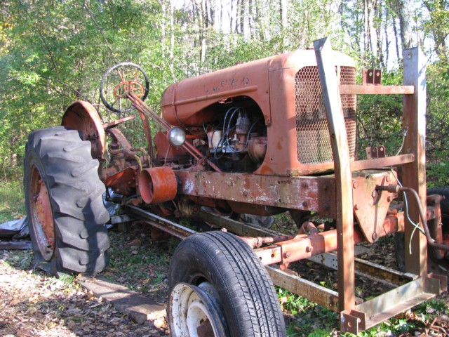

Post Options Post Options   Thanks (0) Thanks(0)   Quote Mark G. Quote  Post ReplyReply Direct Link To This Post Posted: 05 Mar 2012 at 8:45am
Post Options Post Options   Thanks (0) Thanks(0)   Quote CTuckerNWIL Quote  Post ReplyReply Direct Link To This Post Posted: 05 Mar 2012 at 10:19am
Looks like you have the start of a nice snow plow rig or a light dozer there. Might need to store the hand crank though.Smile

Post Options Post Options   Thanks (0) Thanks(0)   Quote Mark G. Quote  Post ReplyReply Direct Link To This Post Posted: 05 Mar 2012 at 10:46am
Yep, thats a plow frame on it. The hand crank has been removed. that pic is when i got it so the hand crank is rusted on. I removed it by spraying on a little pb-blaster.
