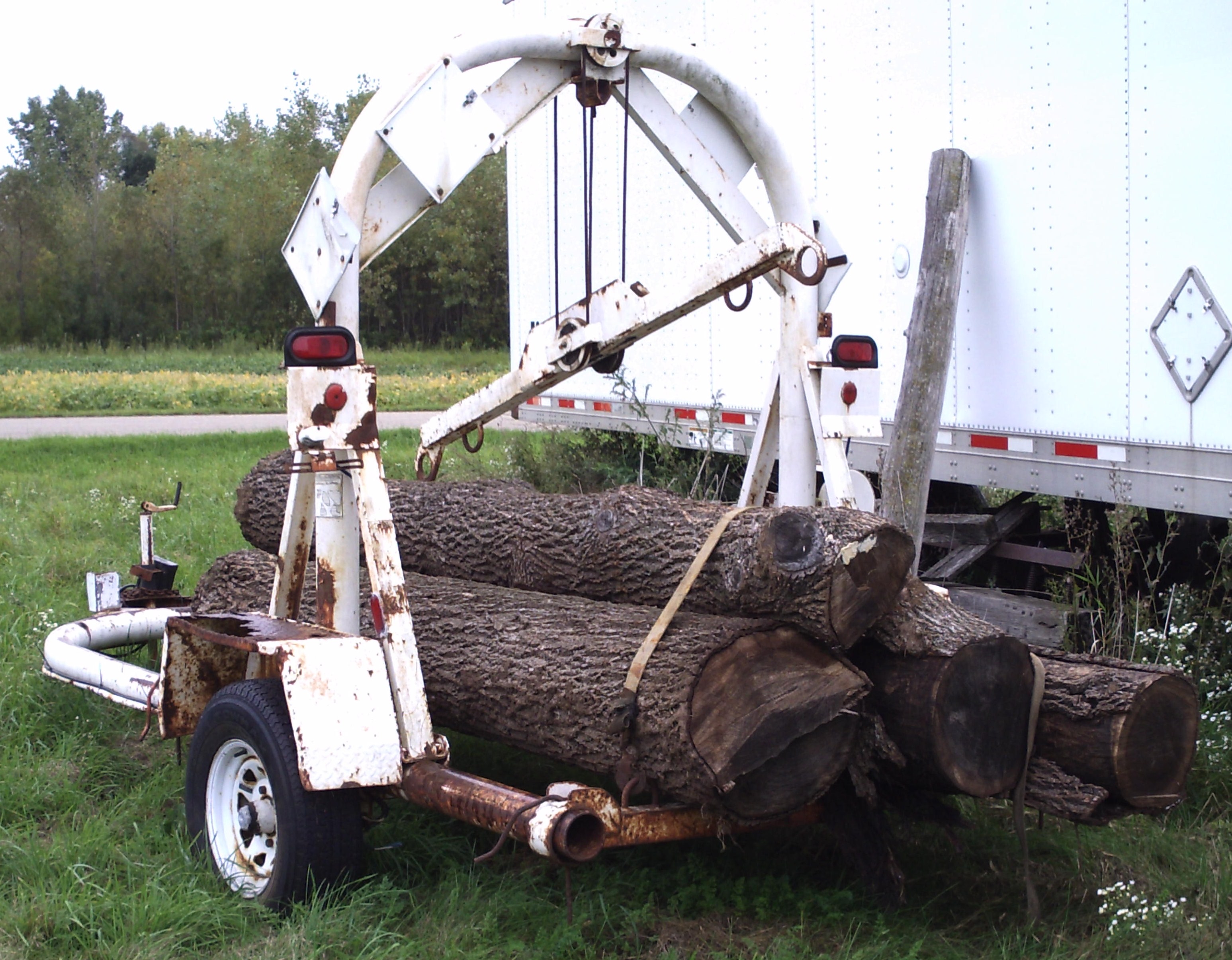

I use an old Brindle propane tank trailer

I hauled a lot of lp tanks on one of them. It gets a bit harry with a 1/2 full thousand gallon tank on them. Only did it once, was a repo situation.
