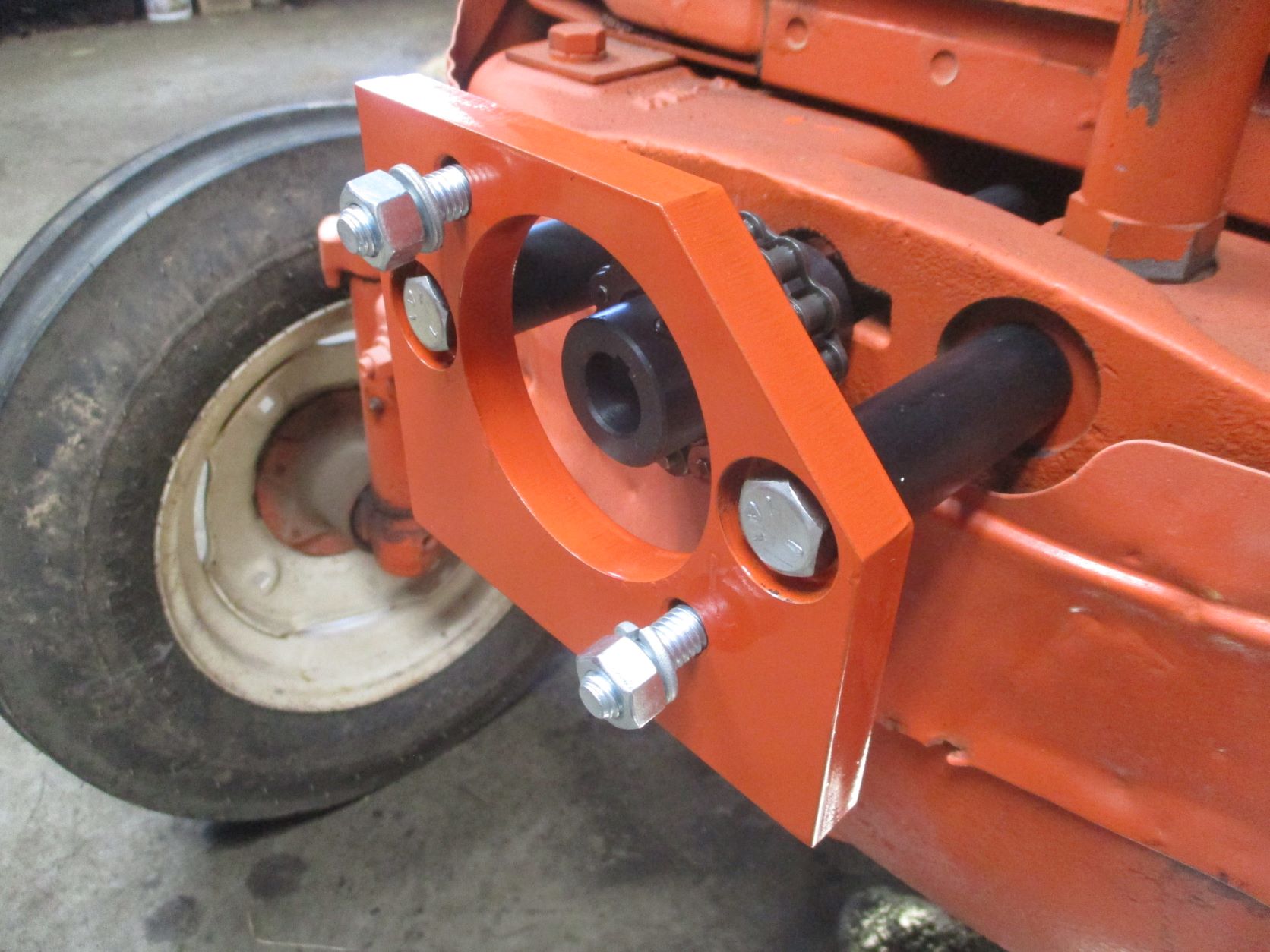

We have front pump mounting kits for D14/15/17 available for purchase. You can use your own pump with SAE 'A' mounting or we have 9.5GPM or 14GPM bolt on pumps available too!
www.awtractor.com
A&W TRACTOR 920-598-1287
