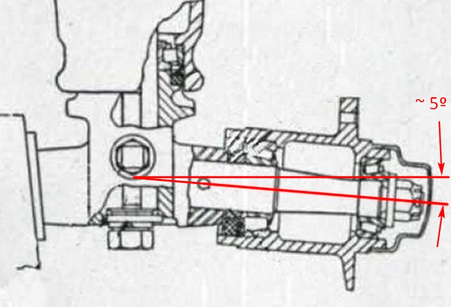

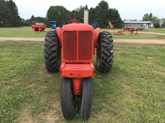

Are they supposed to be at a angle? If so they where not. They are wider than the narrow front on my moms oliver 77
The wheels/tires should be at an angle.  On a diagram of the Front Support, I measured 5º per side tilt outward at the top of the wheels/tires . IDK if that's exactly correct, but it's very close......could be 4.5º
This is what your WD45 should look like.  If not, there's something seriously wrong !

the axle stub shafts are not horizontal.. they are welded together at an angle so the rims will slope out.... Either the shaft is bent or the bearings in the wheel hubs are worn , if the tires appear to be no angle outward.

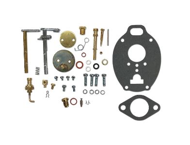

Can I buy only carburetor jets for the wd45
Points: 23629
Post Options Post Options   Thanks (0) Thanks(0)   Quote DrAllis Quote  Post ReplyReply Direct Link To This Post Posted: 17 Oct 2022 at 12:57pm
Which brand carb????????   Marvel Schebler or Zenith ??   pretty sure you can buy adjustable main jets but any internal ones (other than needle and seat) maybe not.
Points: 93381
Post Options Post Options   Thanks (0) Thanks(0)   Quote steve(ill) Quote  Post ReplyReply Direct Link To This Post Posted: 17 Oct 2022 at 1:32pm
Some of the kits are just gaskets, but some "appear" to have more parts like shafts and jets for a complete rebuild......... Depends on what you got and what your needing..
https://www.steinertractor.com/ACS3565-Premium-Carburetor-Repair-Kit?mkwid=|pcrid||pkw||pmt||slid||pdv|c|product|ACS3565|pgrid||cpgnid|17561055353|ptaid||adtext||&gclid=EAIaIQobChMIuLPDvvLn-gIVkh6tBh1p5w83EAQYASABEgKtsvD_BwE
