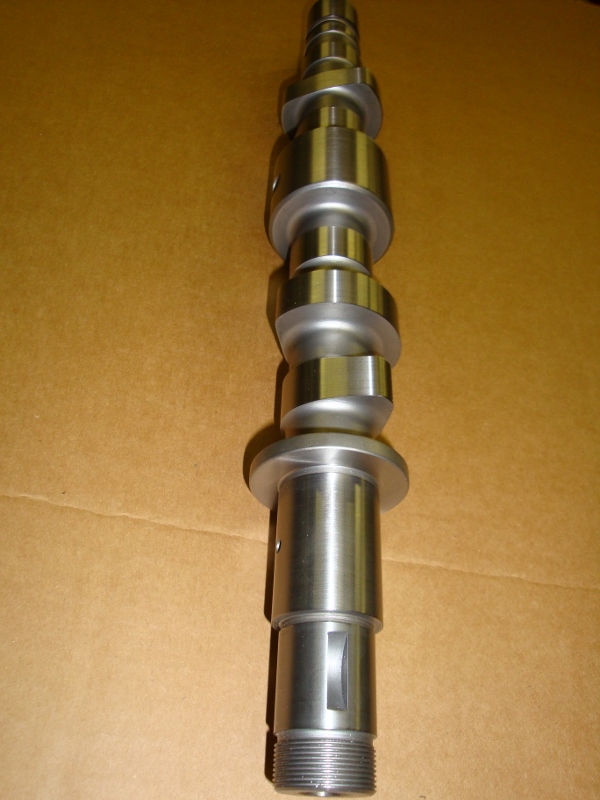

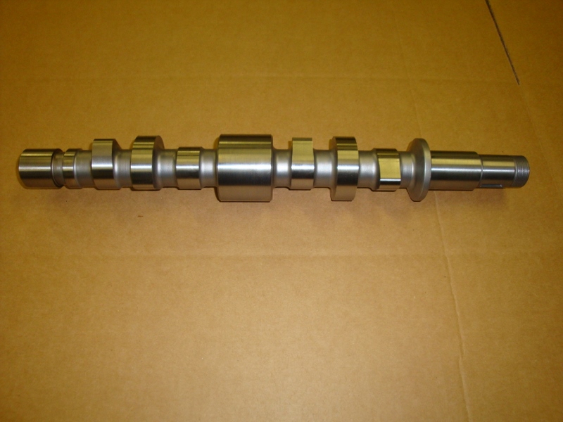

yes wi 50 we can grind from billet or produce the cam core/billet.these are pics of some billet cams we sell for the j-d 720/730 diesel.these were made from 8620 3" diameter round bar and are carburized to harden and prevent abnormal wear .high helix angle cam gears can present a challenge depending on camshaft configuration.we would be interested in discussing your needs,just private message me thanks
