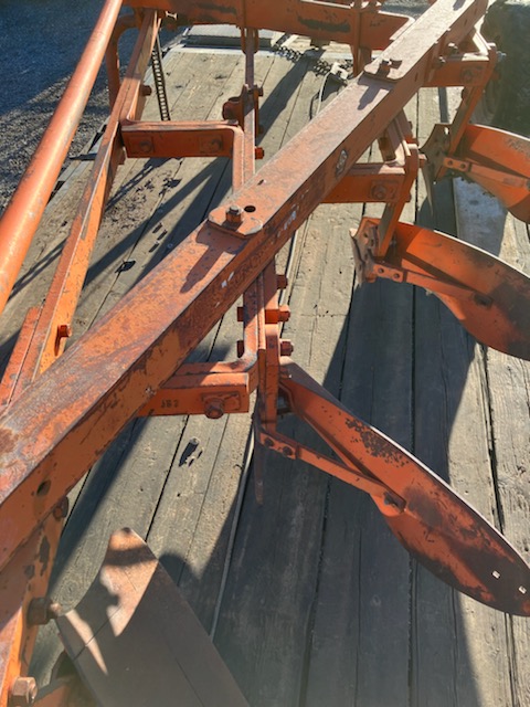

what model plow is this

4 bolts on the shears  three bolts in a straight line  the  the front one is alittle lower  none of the center to center on the bolts is the same
Points: 23664
Post Options Post Options   Thanks (0) Thanks(0)   Quote DrAllis Quote  Post ReplyReply Direct Link To This Post Posted: 29 Sep 2026 at 10:24pm
If the frame width can be assembled 14 or 16 inch width I'd say 70 series. Bolted only to one frame width 60 series.

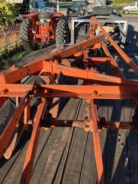

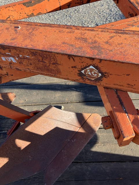

does this help alittle bit dr. allis   need to find shears for this and land slides also
Points: 23664
Post Options Post Options   Thanks (0) Thanks(0)   Quote DrAllis Quote  Post ReplyReply Direct Link To This Post Posted: 30 Sep 2026 at 11:15am
70-series. There is more than one plow "bottom" for the 70-series. And that determines what shares or landsides. I have made my own landsides out of 1/2" or 3/4" flat steel. They won't last as many acres as OEM, but my plow days don't happen that often and new landsides sure do keep the plow straight when plowing.

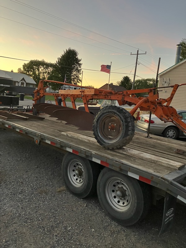

Had to dig the bible out and review my Allis plows. The good Dr. is right, a model 74 pull-type. Not a real common plow. If it had cushion trip bottoms it would be an 84. Dave the plowman probably has wear parts.
Points: 23664
Post Options Post Options   Thanks (0) Thanks(0)   Quote DrAllis Quote  Post ReplyReply Direct Link To This Post Posted: 01 Oct 2026 at 6:32am
Not really a common A-C plow for sure. It would be interesting as to what tractor actually pulled it. It is set-up for a 14 inch cut, which in a mounted style would fit a D-17 in my neighborhood, but a pull type version takes more tractor to pull it. If it had been hooked to a D-19, I would have expected a 16 inch cut setting. Maybe it was pulled by a brand X tractor ???

i think this was a 5 bottom .          some cutting has been done on the back at some time .  this one was given to me.         all i will use it for is plow days and parades  but i will replace re build the cutting parts,  just did all the wheel bearings and tires before itook it off the trailer .   going to pull it with the d17d
