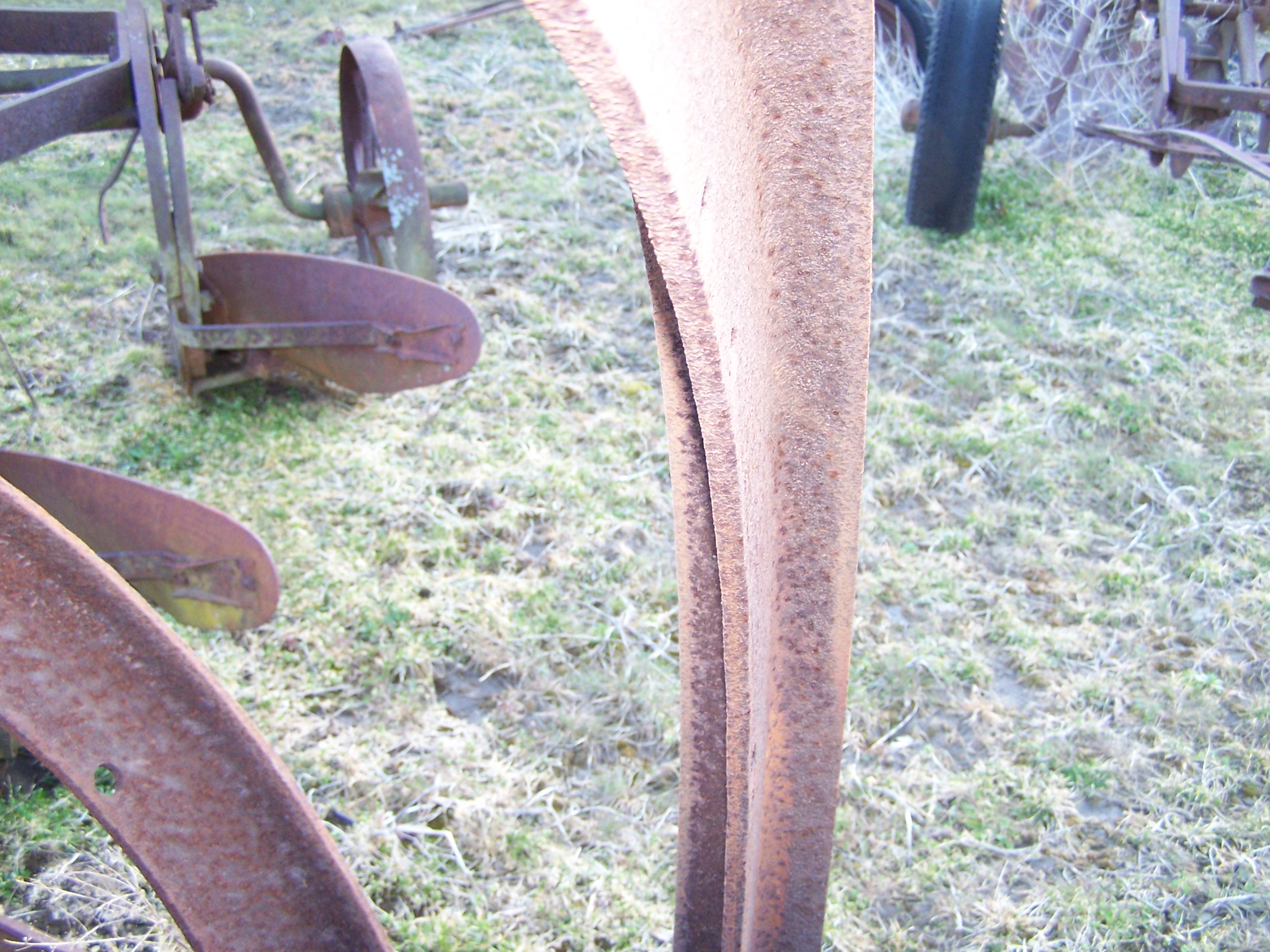

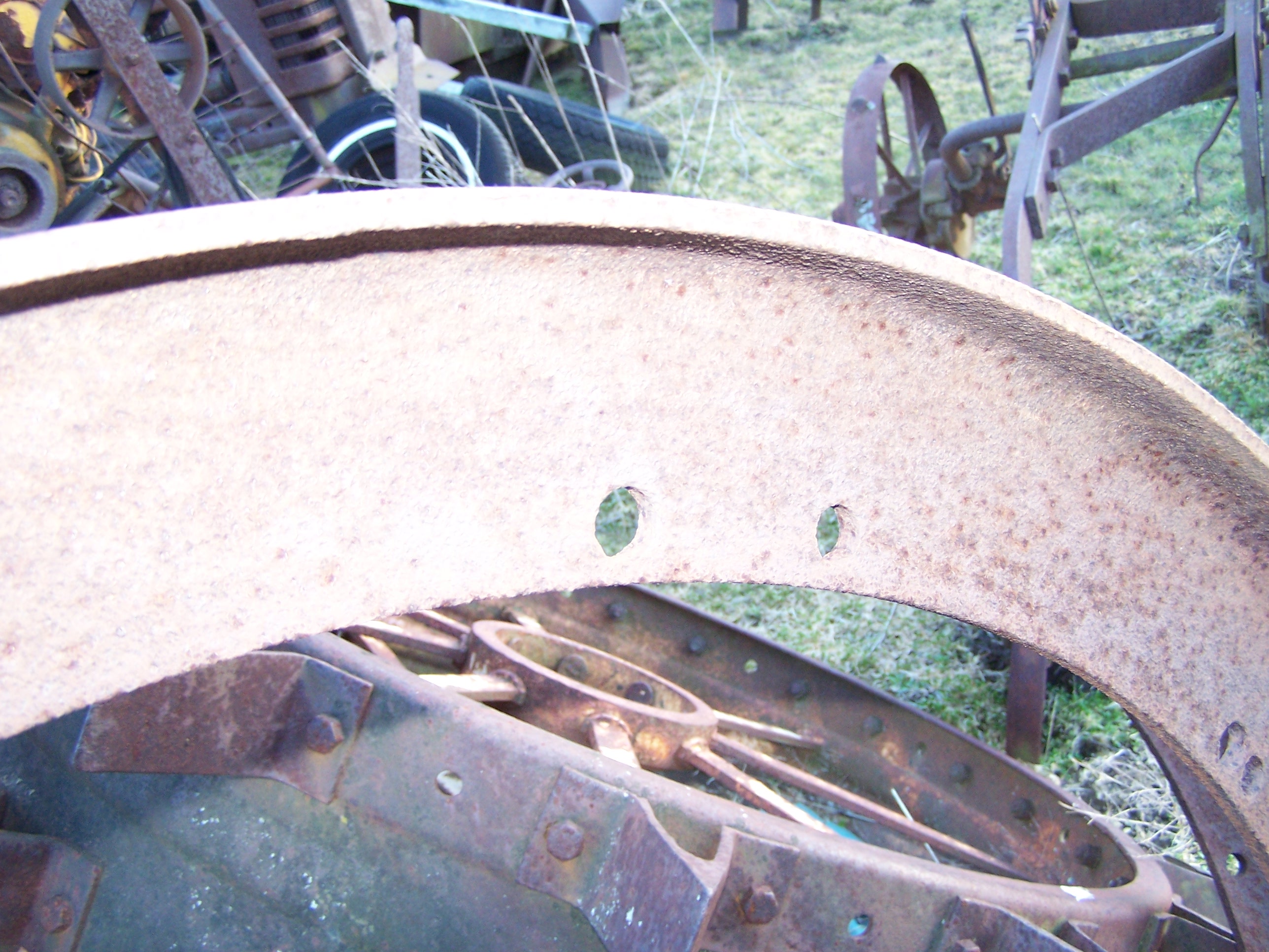

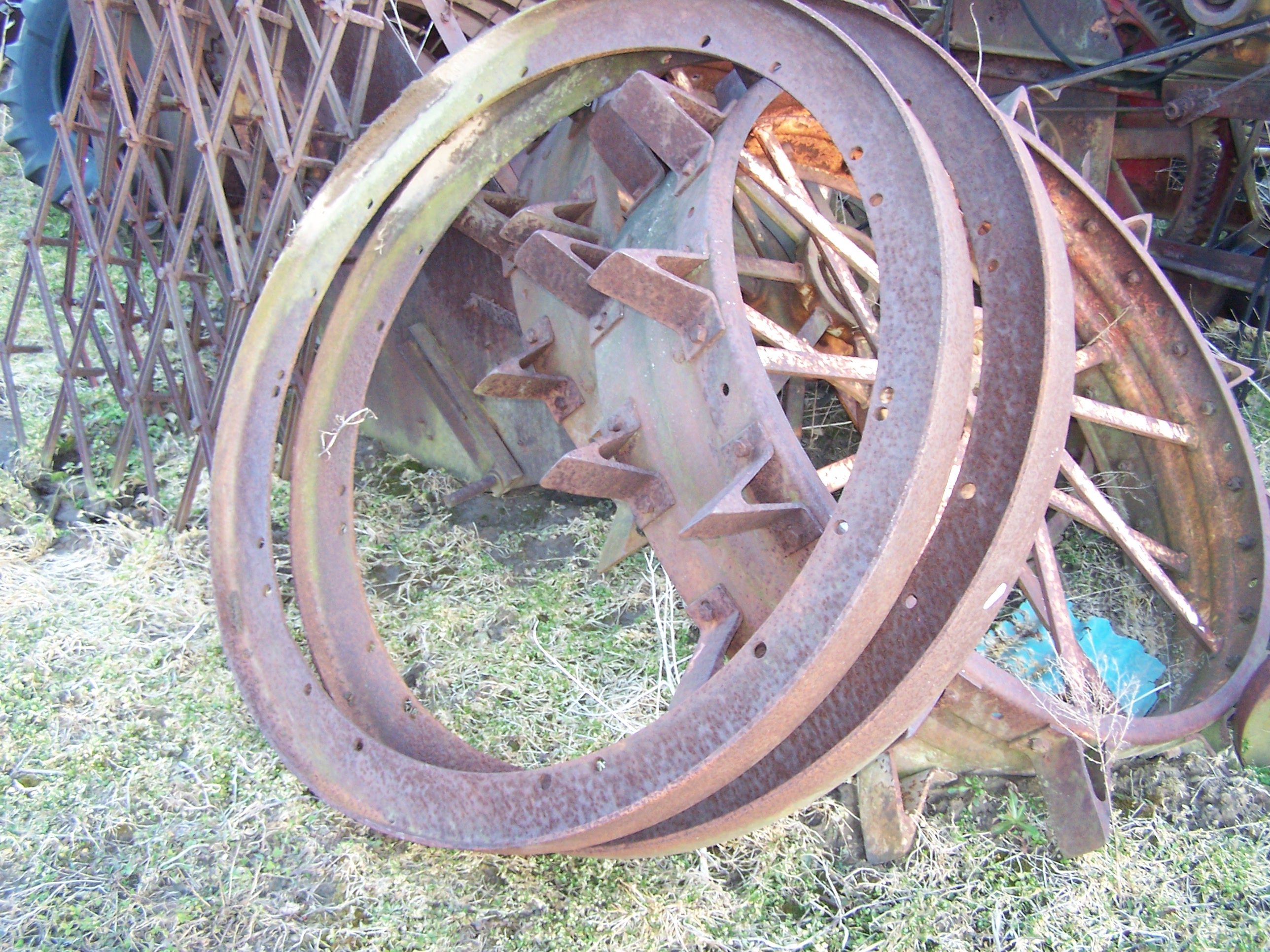

Assuming you have spade lugs (triangle shaped), these bands fit that style of wheel. I uploaded them large so to see the detail of the construction. They bolt on the outside of the wheel, through the open part of the lugs.

I guess I have never seen factory ones. Those will not be easy to duplicate. I made some for my C but it was just flat plate rolled. Thanks for the picture Jim.

    What are the dimensions?  They look like a rolled angle iron...about a 2" face by 3" width by 1/4" thick... all one piece?  Might take a little mfg with my plasma cutter?  Don't know if anybody around here can roll something like that.  Would you be interested in selling those?

These bands are rolled in a "T-shape", not an angle. However, two angle irons could be joined together to reproduce the same look.

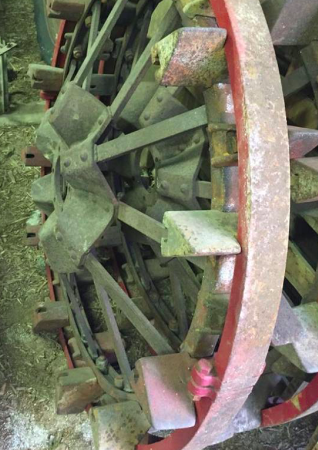

I've never seen a piece of WC literature showing that road bands were available for either the flat steel or skeleton steel.  The same style of F&H skeleton rears were used on several other tractors including the UC's and Farmall F-20's and there was a special road band made for that type of wheel but I've seen no evidence there was a WC version.  I can post pics of what they look like on the other tractors though if you want to fabricate something similar.

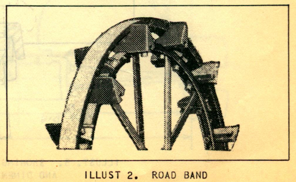

   If you could post some skeleton road bands, that'd be great!

The F&H lugs are notched to accept a road band or meadow band in the center.  This was by design as the F&H skeletons were an entire patented wheel system meant to work in all conditions.

Thanks for the skeleton road band pic.  Those look like something about 1" thick...almost like a wooden wagon wheel rim.  Do you have any idea what material they were made of?  A guy could roll 3 or 4 quarter inch strap irons, and stack them together to obtain that look.

They are 2 piece made of rolled channel just like a flat steel wheel band.  Road bands stuck out past the lugs and the meadow bands allowed some lug tip penetration for haying.

Oh, now I see.  Thanks for the picture!
