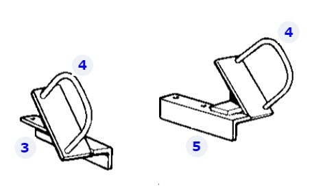

This is what the D14/D15 brackets look like.

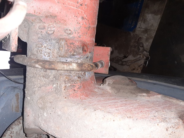

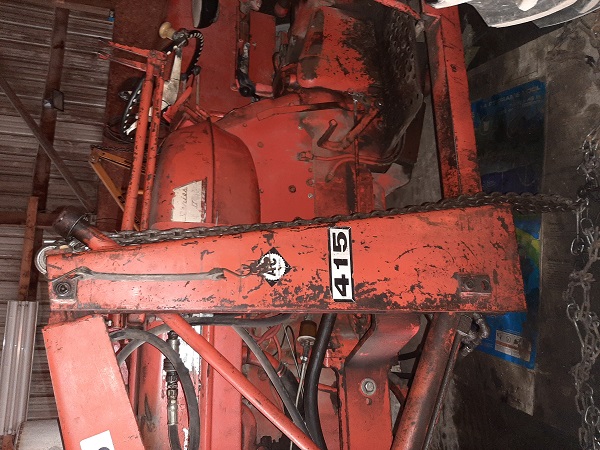

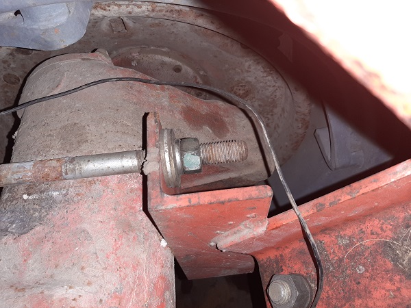

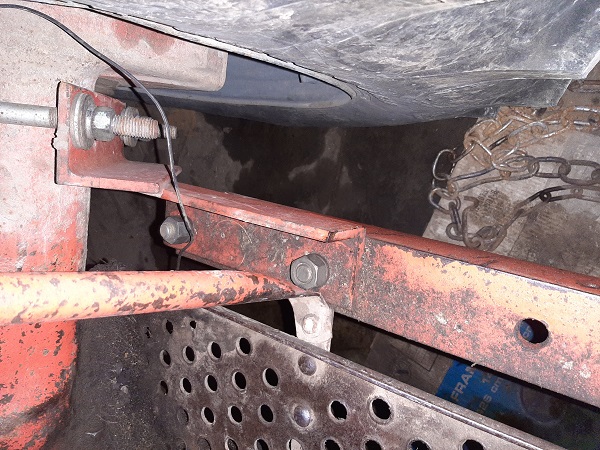

Here are some pictures of my 415 on my D15II, when I bought it the owner said he bought the tractor and loader new at the same time.

Yep, that's what I'm looking for.
What is the size and thickness of the angle that they are made from?

Paul
Took some measurements of the brackets of my 415 loader.
Mine are like those in the actual orange pictures, which you note are different from the sketch from the Parts Catalog.
The Horizontal piece: 2 1/2 X 3"
10" long L, 3/8" thick, 2 holes 7 1/8" apart.
The horizontal side with holes is 3" wide, vertical side is 2 1/2" high.
Sloped piece with 'U' bolt: 3 1/2 X 3 1/2"
9 1/2" long, 3/8" thick, welded to Horizontal piece @ 45'
'U' Bolt is 3/4" diam.
The welded position of the sloped piece would be critical because the frame is bolted with 3 bolts to the Engine side frame / rail.
Probably best to assemble everything in position and tack weld first.
HTH
Gary

   If you can't find a u bolt an angle iron with holes drilled will work on top, then use bolts.

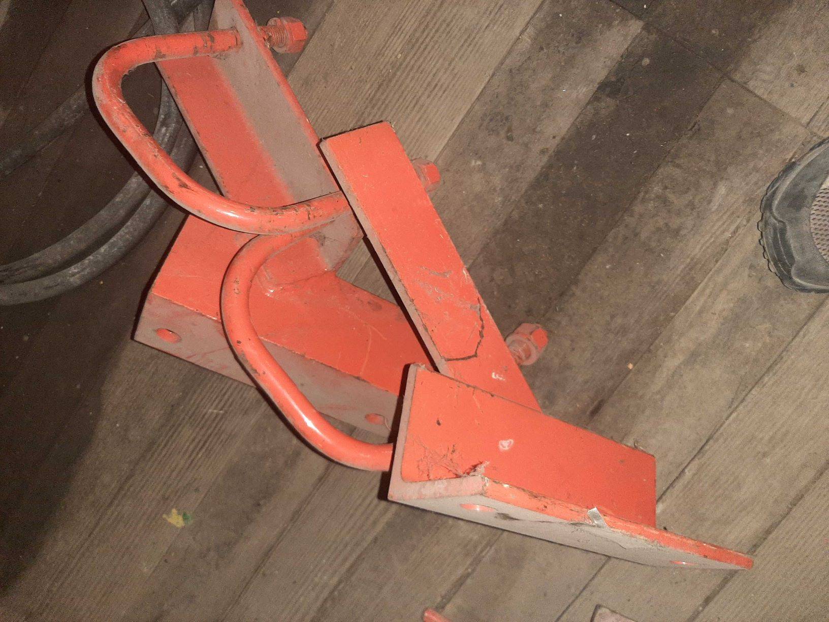

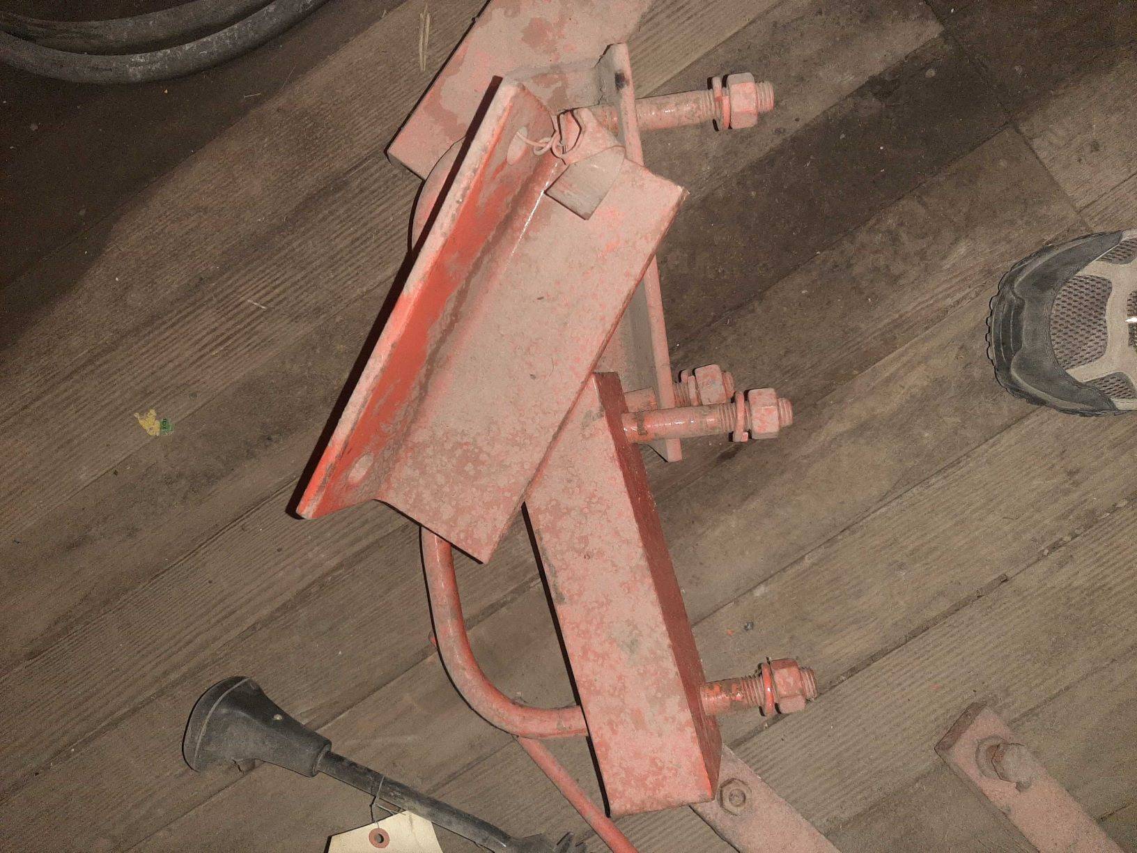

I think we have some NOS ones here.  I will try to get a picture of them.
Jim

Shipping tag number says 387416.

I have a pair of those brackets and did not even know what they are till now.
