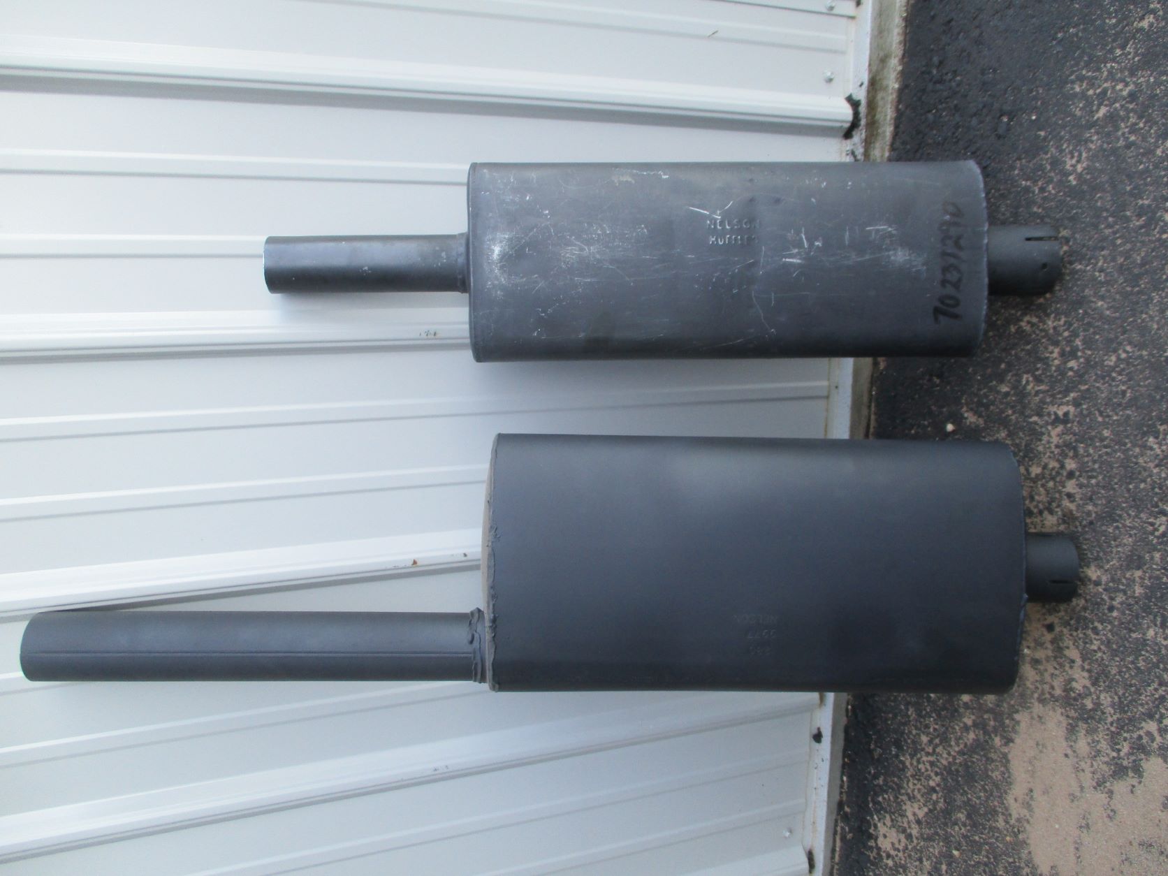

Post Options Post Options   Thanks (0) Thanks(0)   Quote Alex09(WI) Quote  Post ReplyReply Direct Link To This Post Posted: 04 Aug 2022 at 7:24pm
Here is a new 185 muffler next to a NOS late D17d muffler.

Points: 23665
Post Options Post Options   Thanks (0) Thanks(0)   Quote DrAllis Quote  Post ReplyReply Direct Link To This Post Posted: 04 Aug 2022 at 7:31pm
OK. The 185 muffler does fit a gas series 3 and 4  D-17, and also pretty sure the D-19 gassers are the same too.  I'm surprised that it fits the gas models and the diesel is a smaller body.

Post Options Post Options   Thanks (0) Thanks(0)   Quote Alex09(WI) Quote  Post ReplyReply Direct Link To This Post Posted: 04 Aug 2022 at 8:17pm
The D19 gas should have a 1 3/8" inlet and the 185 muffler will work on them. You may have hit the wrong key as the 175 gas muffler fit the D17 III/IV gas and the 170 gas, those have the same inlet at 1 15/16". But none of those have the 3x7 oval body required for the D15/17 diesels. And it is not a straight through design. The only other A-C mufflers that have the 7x3 body are the D10/D12 oval and the HD3 crawler that I know of. If I have some time, i'll see if Nelson makes any mufflers for other colors with the 3x7 oval yet.

Post Options Post Options   Thanks (0) Thanks(0)   Quote Alex09(WI) Quote  Post ReplyReply Direct Link To This Post Posted: 25 Aug 2022 at 3:57pm
To update everyone on the D15/D17 diesel oval muffler, according to Nelson there is no 3"x7" oval body muffler in production or in their current catalog. So there will be no alternative Nelson available as ordering new ones is insanely cost prohibitive. Only option is to cut hole in hood larger or to space the 4.25x9" oval above the hood.
