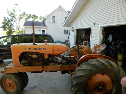

Was sitting around the table the other night talking about how to get more traction pulling and one guy said 5 gallon pail and rocks like ha ha
Another said fluid in the tires I replied ya but they eat the rims so I don't want to chance it he replied put rv anti freeze in them they won't hurt them and still gives u tons of traction.
My other ? Is I have f&h rims off a farmall on my WC allis there spoke rims and i have a set of f&h wheel weights but I don't know if they will work on there I have some j bolts off for a oliver set of duals that I was going to hook on one of the spokes and hang the wheel weights from but not sure what we be best.
Fluid sounds the easyist

Use Fluid to get you to your lowest base weight, then use weights after that to go up in classes.
Charlie

We do just what Charlie suggests on one of our WCs...but used winter formula windshield washer fluid. Kip

 go to taller tires and leave wheels light

I'm not pulling a sled I want it for pulling a 10 ft disk I should mention

like kip said put washer fluid in i use to work in a tire shop and we did that all the time for guys that wanted more weight for there lawnmowers in the winter for moving snow
