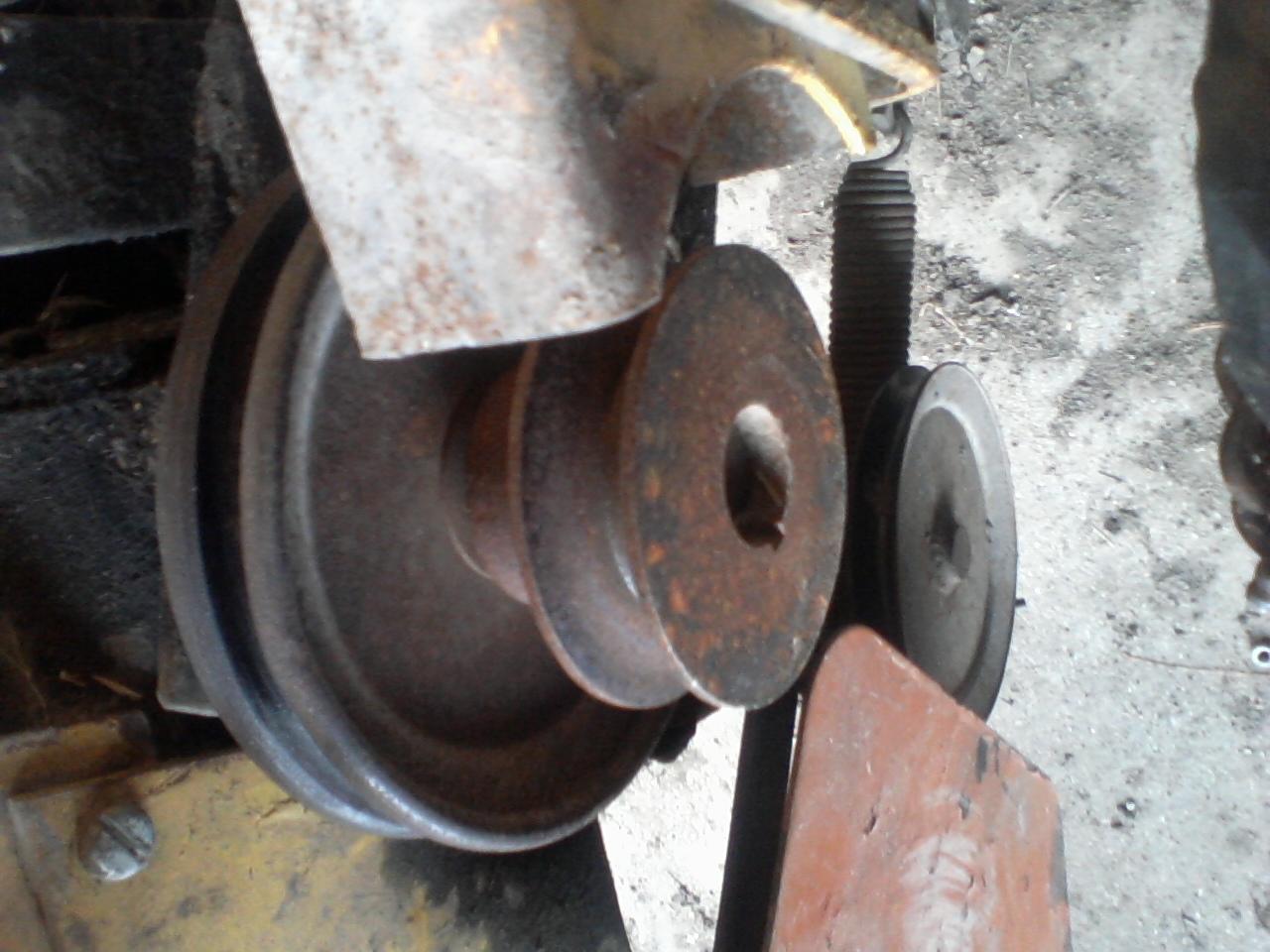

Post Options Post Options   Thanks (0) Thanks(0)   Quote wildbill26 Quote  Post ReplyReply Direct Link To This Post Posted: 26 Dec 2013 at 2:28pm
ok here is the pictures of the pulleys hitting, in the first one you can see the outside edge of the big pulley where the inside of the little one is hitting, the second i engaged the pto and then slid the small one so you could see the two hitting, i almost wonder if it is the wrong belt letting it do that, thanks

Post Options Post Options   Thanks (0) Thanks(0)   Quote Matt Tallant Quote  Post ReplyReply Direct Link To This Post Posted: 26 Dec 2013 at 3:35pm
That is the wrong pulley on the BGB.

Post Options Post Options   Thanks (0) Thanks(0)   Quote ACmowerguy Quote  Post ReplyReply Direct Link To This Post Posted: 28 Dec 2013 at 8:49pm
You might have the wrong combination of belt lengths.

Post Options Post Options   Thanks (0) Thanks(0)   Quote wildbill26 Quote  Post ReplyReply Direct Link To This Post Posted: 29 Dec 2013 at 8:07am
ac mower guy, thats what i kinda was thinking, once i get the engine back in(bad coil) and running again im gona call sandy lake and get new belts hopefully, did all the b series have a "mule drive" thats what i call it any way, to drive the mower deck?

Post Options Post Options   Thanks (0) Thanks(0)   Quote AaronSEIA Quote  Post ReplyReply Direct Link To This Post Posted: 29 Dec 2013 at 5:53pm
The belt should be a 1/2x35".  The mule drive was the same on the B10 and B110.  Top pulley should be roughly 5" diameter.  There is a guy on eBay parting out a B112, he might have the correct top pulley.  I've attached a picture of mine, but it's hard to see how it works with the belt shield in the way.
