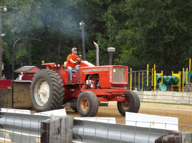

I think it helps a lot because its much closer to the center of the rear axle that way and when I pulled my WC I first pulled off the drawbar and spun out but after trying it off the bale and no drawbar she would always lift and spin out because I gained much more down pull on the rear tires and got 4" closer to the rear end without the drawbar
