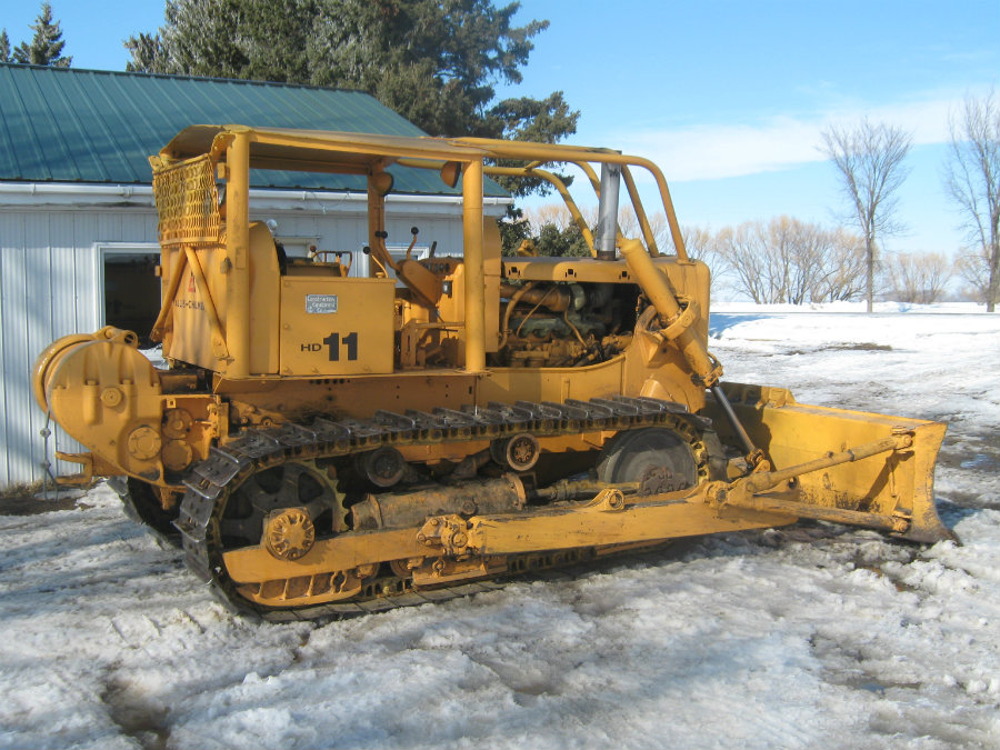

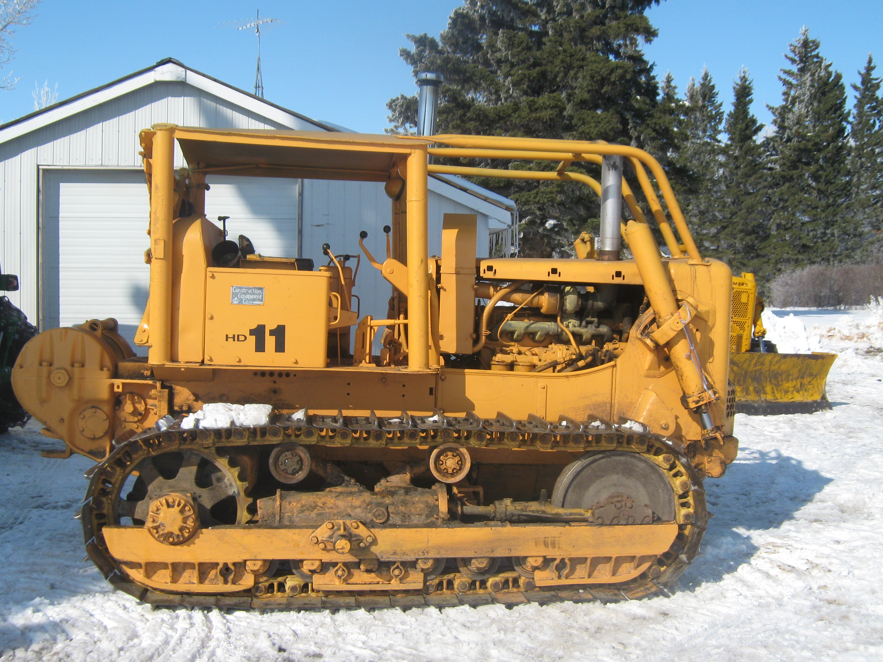

Put new boots on this old girl to go one more round... rails, sprockets and pivot pin- could use bottom rollers, too, but budget wouldn't allow.  Winter project.

Nice Boots!  Are they nos or adapted from another make?

Post Options Post Options   Thanks (0) Thanks(0)   Quote Mactractor Quote  Post ReplyReply Direct Link To This Post Posted: 30 Mar 2013 at 2:39am
Good lookin tractor Trev. With the Farr air cleaner she looks like the early series EP (Twin Disc converter and tall forward gearing, lower reverse)

What is the designation for the motor in this machine? The inline 6 cylinder has several designations I wonder what is stamped on the motor plate. I have main and rod bearings for this motor see HD6 Bearings post.

Post Options Post Options   Thanks (0) Thanks(0)   Quote Lazyts Quote  Post ReplyReply Direct Link To This Post Posted: 30 Mar 2013 at 8:55am
11000 series engine.  It has an American Bosch pump, and is one of the earliest machines with faster reverse range.
Merv:
Yes, I used to own this tractor and then the winch had a 1-1/8" cable on it.  Now it has 1/2" cable- but I doubt he'll ever use it anyway.
This is one of the only tractors that I know the whole history of- it is now on its 4th owner, and has bought lots of breakfasts.  The dozer trunnions and hard bar have lots of wear- you don't have to be an engineer to see that it has done its share.

Post Options Post Options   Thanks (0) Thanks(0)   Quote Lazyts Quote  Post ReplyReply Direct Link To This Post Posted: 30 Mar 2013 at 9:07am
Track components are a combination of NOS, good used and the sprocket rings are from Henderson, still being manufactured.  The rails aren't quite brand new, but measure new pitch, we had to install a used carrier roller- they are hard to find new.
I actually found enough new components to do the whole undercarriage, but cost would be too high.  We had to keep in mind what the tractor is worth, as this gentleman is close to retirement.  These rails will be all he needs, and we basically got both for the price of one brand new rail.
