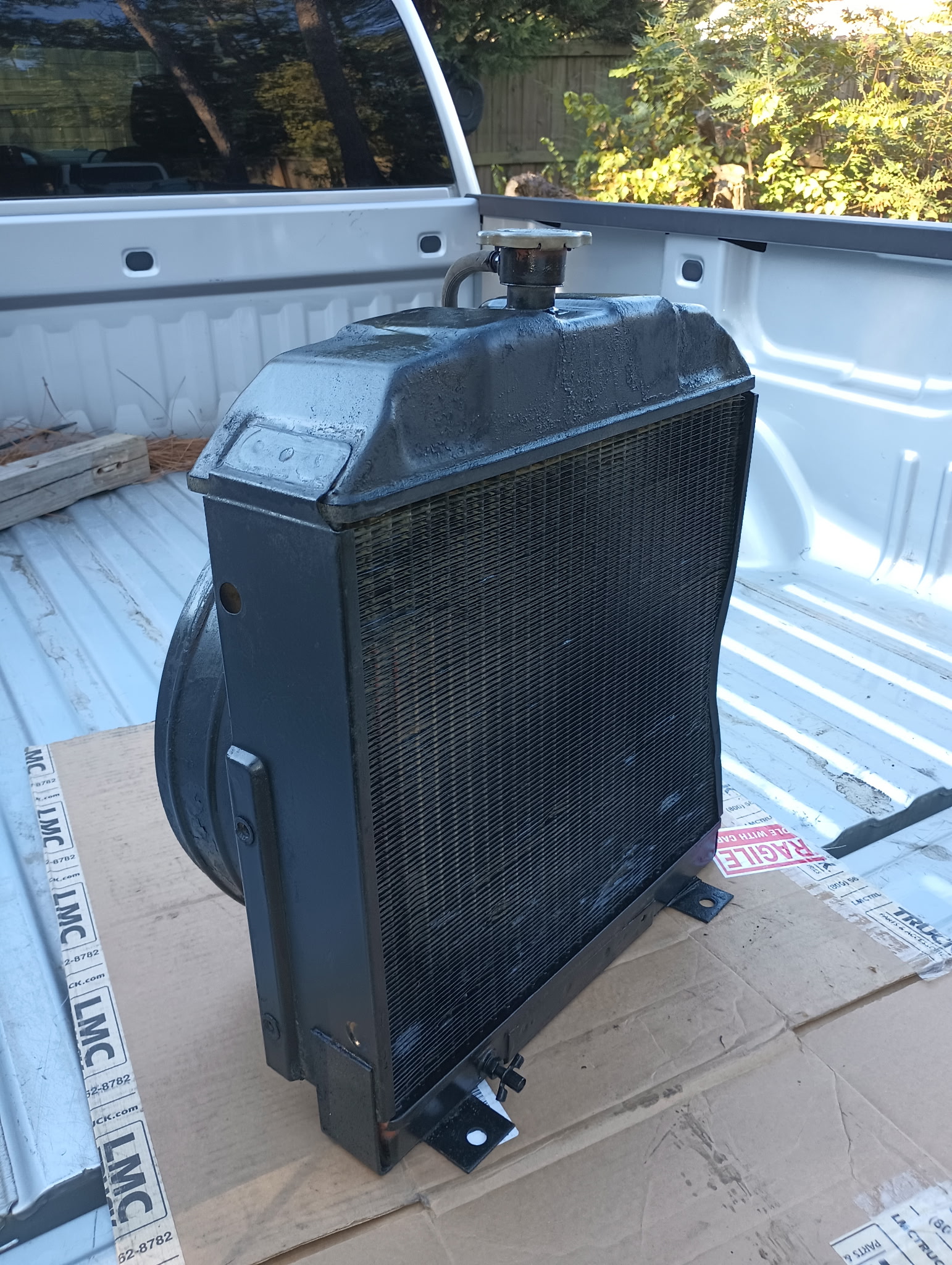

Post Options Post Options   Thanks (0) Thanks(0)   Quote ACinSC Quote  Post ReplyReply Direct Link To This Post Posted: 30 Sep 2026 at 10:49am
Got my radiator back today. Found fan belt is touching/rubbing bottom rad hose. Remember I had to buy a longer belt when I replaced alternator. Found old belt which is a smidge too short to go on. Used side grinder to knock a little off alt where it was hitting engine block and now it fits. Barely.
Now I'll put radiator back on.

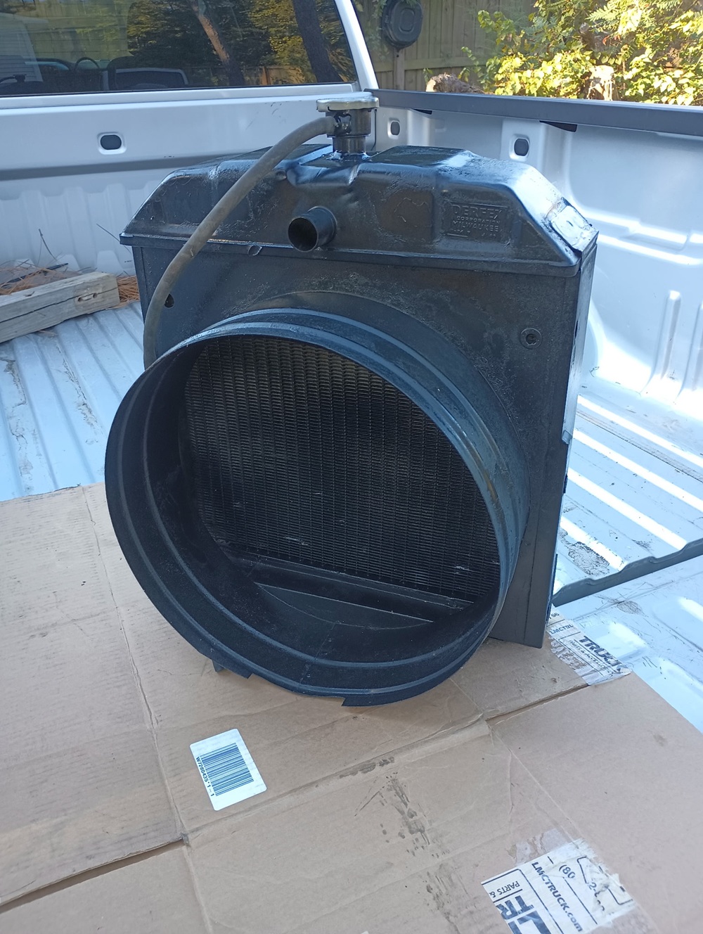

Post Options Post Options   Thanks (0) Thanks(0)   Quote ACinSC Quote  Post ReplyReply Direct Link To This Post Posted: 30 Sep 2026 at 2:31pm
Fav son posted a couple pics. I have radiator in and test drive went well. No leaks. Thanks for looking
