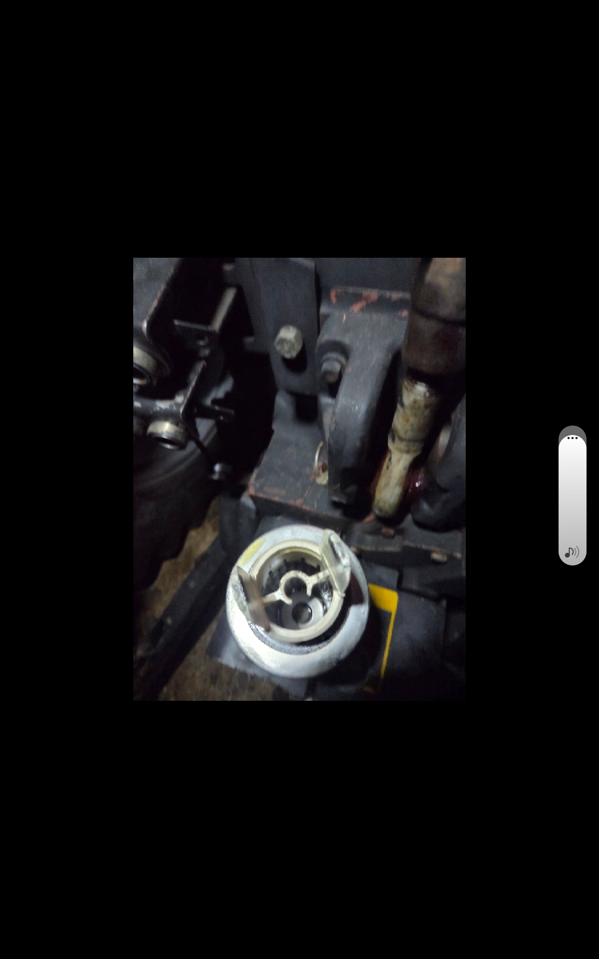

While changing oil on my new to me 7060 I discovered the plastic part that you snap onto the filter has a piece broken from around the bolt hole, not a very big piece missing but still broken. Not sure I need to get another but I thought I would ask if anybody has one of these in good shape they would part with?

The more I look at it it looks like to me the only purpose for the piece is to guide the bolt, why not go ahead and remove the rest of the broken piece so it doesn't break off more and take my time when installing the canister?

All the broken piece does is guide the long draw bolt to the threaded hole in the base. However, anything that breaks off in that area, winds up going into the PST valve unfiltered. So, break it off clean or get a new one. I thought AGCO didn't have them anymore ??

When I saw the damage I suspect someone dropped the filter into the canister and chucked that piece off, I hope they caught it, I cant see or feel anything. I was ready to dremmel it out and thought it centered the top or muck up the sensor so like I say cry once.
