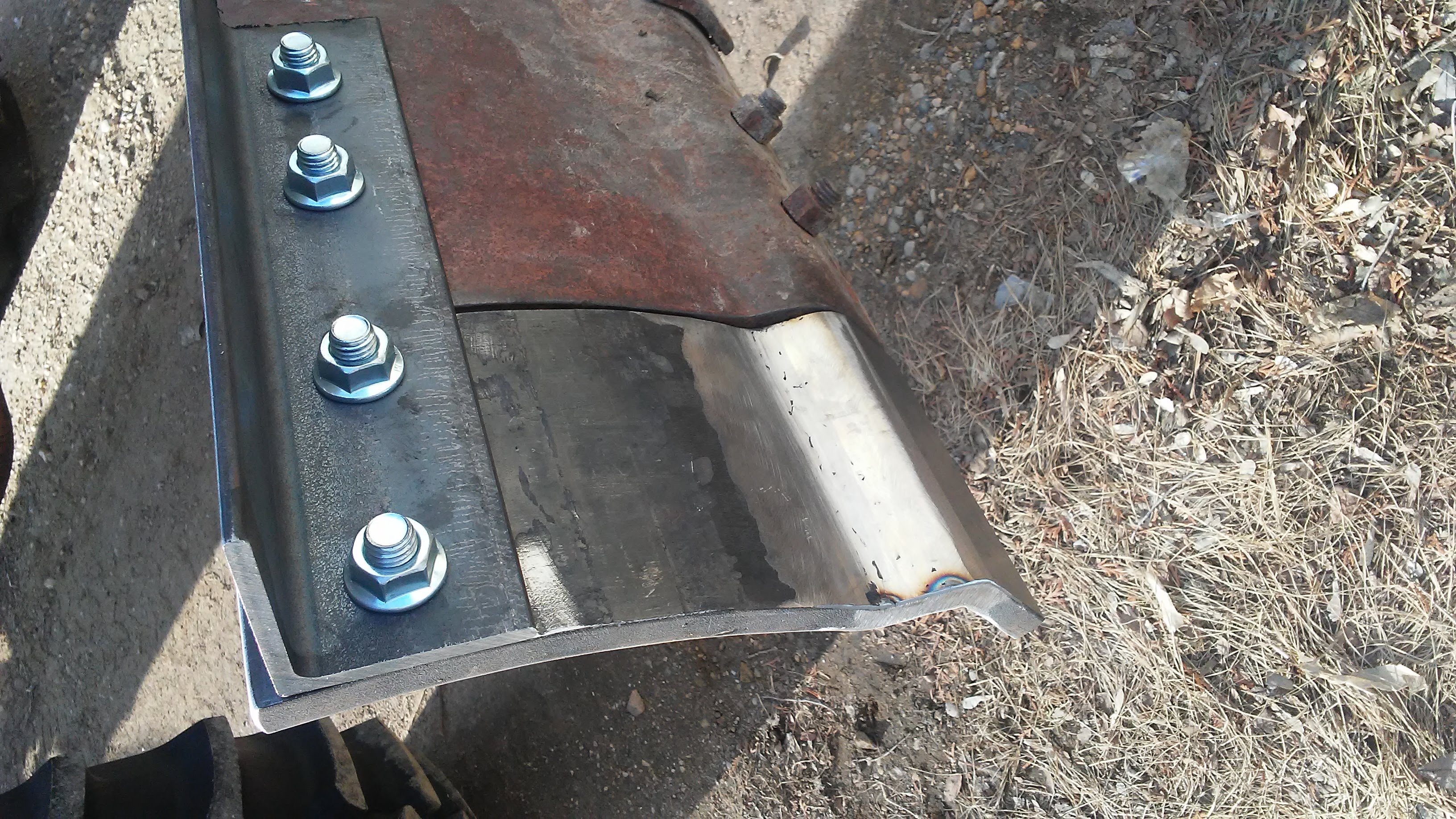

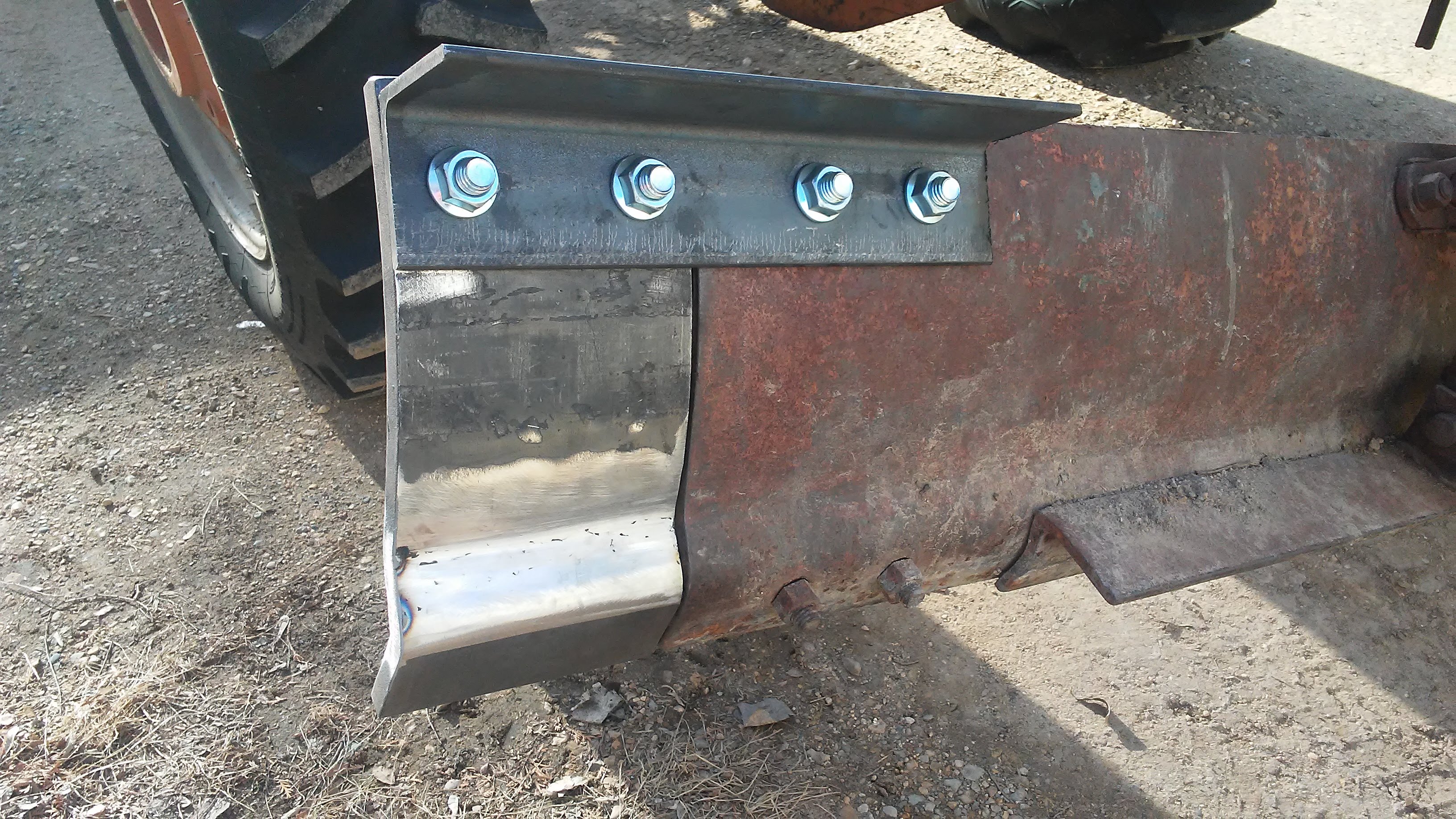

I made 6" extensions for mine. Had local metal supplier bend the curved part, then I welded 2 pieces of flat to the bottom to match the lip for the cutting edge.
