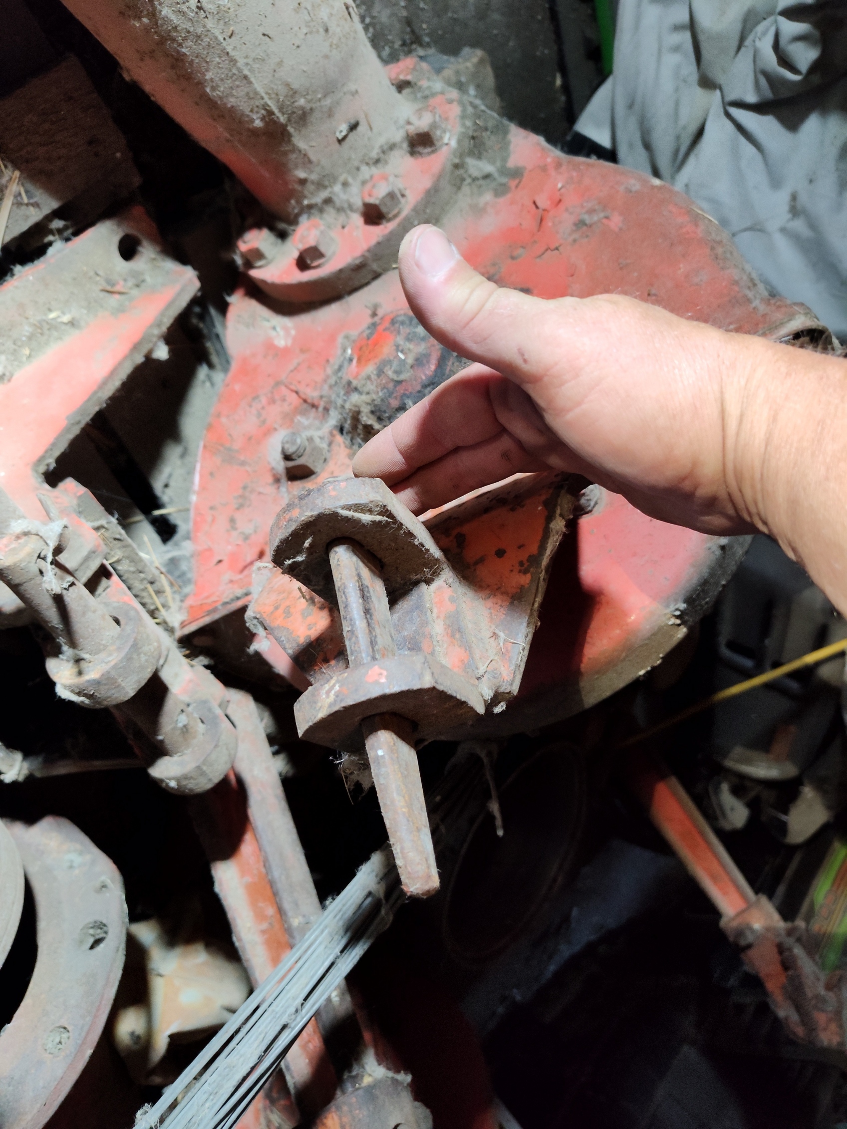

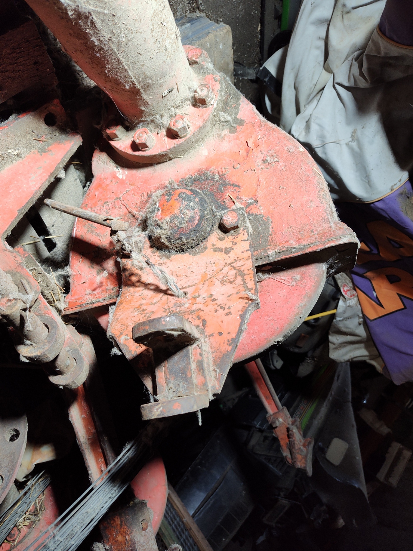

Can someone tell me what the brackets that go a WD 45 are called/part number. They go on the final drive and have a wedge pin to lock the mower attachment in.

Might be a picker or cultivator mounts..
If no one else knows for sure I’ll look at my wd and 33 picker.

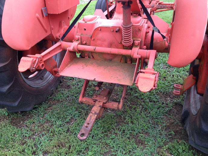

Here is a picture I found on a Tractor. Its for the pull behind sickle bar mower.

Which model mower are you thinking.
Don’t think those are for mower.
Points: 5472
Post Options Post Options   Thanks (0) Thanks(0)   Quote PaulB Quote  Post ReplyReply Direct Link To This Post Posted: 28 Jul 2026 at 6:45am
They are mounts for the #3 sickle mower

^^^^^^^^^^^^ Yes and leave the OEM draw bar on the tractor! you will need it! Dave

Allis called it a Bracket Ass'y for #3 Mower on a WD eff. Feb 1952
Part #803527

Thanks Paul I hadn’t thought of #3 mower
