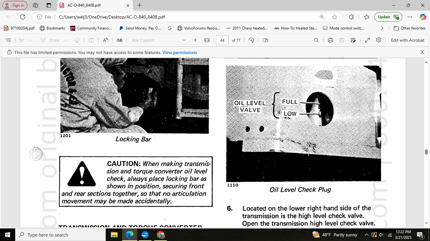

I live in northern MI where ice storm just hit. We are trying to get clean up going and ran into a problem.
I did a search and found nothing.
So I am iso information on a older AC 840 wheeled loader. Should be basic information. I have the operator , service and parts manuals but cant figure this out.  The pics in my manual are not clear. I was trying to check the trans fluid level. The trans pan has two pipe plugs on the front. One high and one low. My understanding was to pull the top plug to check fluid level. Well that resulted in about 2-3 gallons of ATF coming out all at once.
1) Is this actually how to check the level?
Manual states open valves ???
I have no idea what that means. but pic has a caption saying plug?
2) Manual says Dextron fluid?
Thanks for any help

John, I've had an 840 loader for 30 years. Yes the oil level should be to the top check plug. If yours was overfull it's possible either the steering or loader hydraulic pump is leaking hydraulic oil into the transmission, thru the front seal. I had this years ago, putting a new seal on the steering pump solved the problem. It's the same seal as a 190 tractor. Be carefull when you slide the pump out not to drop the adapter drive sleeve into the tranny. Hope this helps.

Thank you  that appears to answer my questions.
