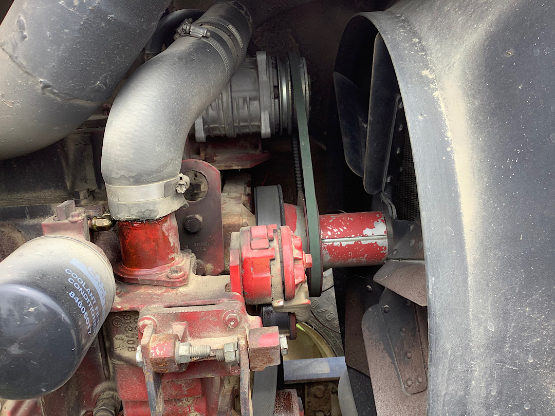

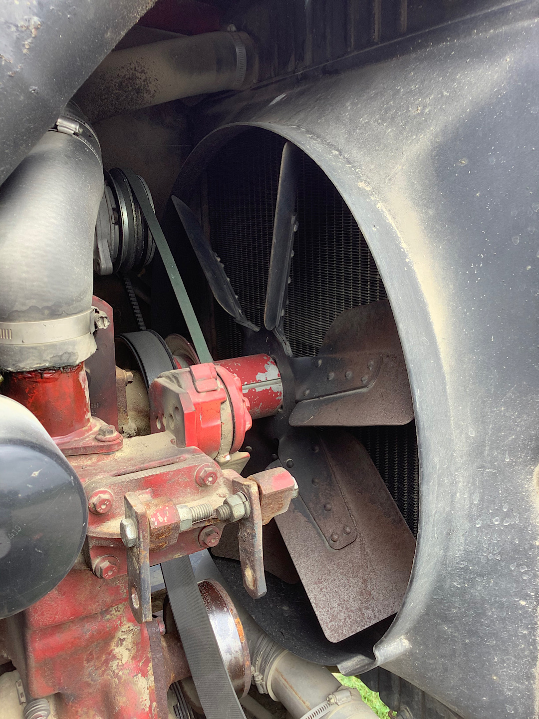

Post Options Post Options   Thanks (0) Thanks(0)   Quote Jordan(OH) Quote  Post ReplyReply Direct Link To This Post Posted: 17 May 2023 at 5:43am
This is an 8.3 in an 8030. Stock fan and shroud using the Cummins spacer.
