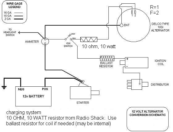

I use a 10 ohm 10 watt resister ........ no idiot light. If the alternator tests GOOD, then your not getting the excitation voltage to kick in right.

Have that exact diagram downloaded Steve. I went with a 5 ohm resistor to get higher amperage to make sure there was enough load to trigger the alternator. Using Ohm's law, V/R=I, 12/5=2.4 amp versus 12/10=1.2 amp. No ammeter or voltmeter wired into the system as of right now. Using a multimeter only get around 11.5 volts at battery. Idiot light stays on even holding it at full throttle.
Plan to eventually replace the original ammeter in the dash, but need to find a 10 pin aviation connector to replace the factory one that won't come apart so I can take the dash off. So for now just trying get it to run so I can move snow. Don't have a shop to get it inside, so that will have to wait till spring. Plan to rewire the whole machine come next summer.

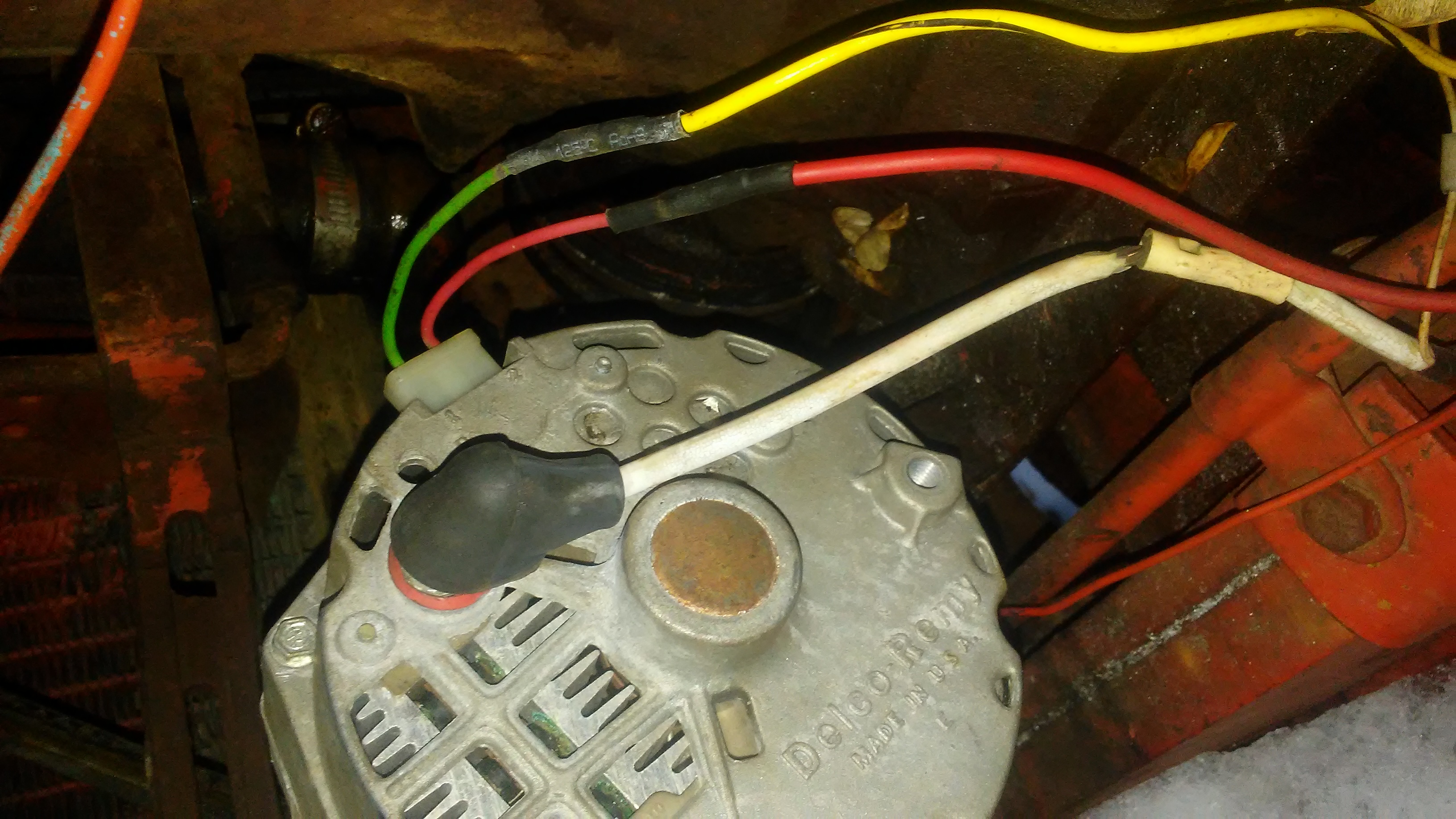

How about posting a photo of the back of your alternator, terminal end, so we can all be sure which alternator we are talking about.

Sorry about pic size. All I have is an android phone and android tablet, and haven't found a way to resize. If to big, what works for me is to open it in a new tab or window.
Heavy white wire, (which has been replaced since picture was taken) goes to battery side of starter solenoid. Red wire goes to battery side of starter solenoid. Green/yellow wire goes to idiot light.
Checked, and have ground from case to engine block.
Started with just the light in the circuit. Light stayed on, so added the resistor to increase load due to fact it is a LED, so small load.
Was originally a generator (1952ish) but, was changed to an alternator by a previous owner.

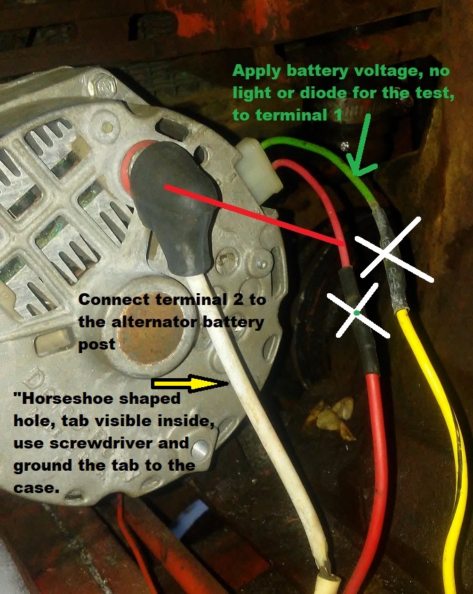

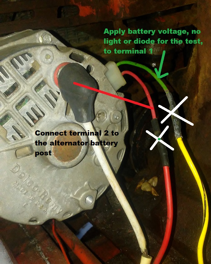

Try the temporary connections in this photo and see if it charges. You can just unplug the red/green wire connector and use spade terminals (to replace the connector) to make up the jumpers, you can put test clips on the other end of the wires so you don't have to hold them but can remove them easily. You can get battery voltage from the Battery/output terminal of the alternator to feed terminal. Another thought regarding the LED, most are polarity sensitive, I would remove the LED and try it with a regular incandescent bulb, no diode.

Post Options Post Options   Thanks (0) Thanks(0)   Quote Jim.ME Quote  Post ReplyReply Direct Link To This Post Posted: 12 Dec 2019 at 6:53am
If you try an incandescent bulb remember the socket needs to be isolated from ground and it needs ground and power wires for the bulb so it ties into the wire to the alternator in series.
