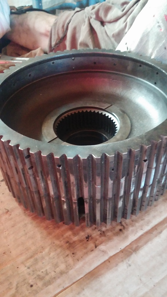

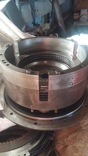

Purchased this 7580 PD from a puller while back finally took it apart, he claimed it was used one season on a thousand horse tractor. As you can see he took high side clutch and gutted the insides and continued the separator slots so they meet the low side slots. Stacked inside a total of 12 plates were used, I discovered the three very center clutch plates slipped and warped.
Question for Doc and others, too many plates so the piston couldn't travel far enough to fully compress them??? I figured remove three and shim up difference? My calculations are .404 separation per clutch and separator plate, does that sound correct?
I started making second PD from 7060,the most challenging part is finding a shop to weld the high and low hubs together, could machine new one, very spendy! Don't know if you can see in photo the smaller low side splines were removed and only engages high side. This new PD would have 7or 8 plates. Also could leave low splines on and remove gear on back of low shaft, maybe?
Another puller on this site is considering this set up also, so comments welcome.
Points: 23574
Post Options Post Options   Thanks (0) Thanks(0)   Quote DrAllis Quote  Post ReplyReply Direct Link To This Post Posted: 05 Jun 2017 at 7:09am
I'd say you are probably correct on not enough stroke on the piston for all those discs/plates and not enough squeeze pressure from just one clutch piston.  I like my two piston design much better than that thing. Sure looks like a time bomb to me the way he did that.

Doc and I had a discussion on this a while back,,, a 7580 pd with the low and high center together for either low or high which ever needed, using the low side clutch pac to start, build boost, then apply pressure to the high side to lock it up - the low side would have the resistance spring washers to cushion the start . Might add more lube flow as well. The stock clutch valve could be modified - or replaced altogether with another type of valve (s) for pressure application..if you wanted to get really cute add in s pluse width modulated valve...

Doc - Could you explain your two piston design? I am in need of something, would like like something that would last me a while. getting sick of splitting this thing. Haha

You have to decide which range you are going to use, Low or High. No more on-the-go shifting. Remove the countershaft gear to the range you aren't going to use anymore. Either replace that gear with a spacer or just cut off all the gear teeth to that gear and use the hub. Figure out how to weld (or bolt?) the two clutch hubs together, similar to what these pictures show, or maybe a different method??  The clutch hubs still are used and supply lube oil to the clutch discs. Remove the Belleville piston washers from the low range piston but still use the bolts and stools to seal it up. Do whatever it takes to the P.D. valve to supply pressurized oil to BOTH low and high clutches at the same time. Not sure what that will take, but that is the premise of my dual piston clutch. Both sides are used at the same time. The input shafts are used to keep everything straight and stable. All the power goes thru the clutch hubs. Using a late model 7580 clutch, you'd had 5 discs in low and 3 discs in high for a total of 8 discs to absorb the heat. Using the thick separator plates everywhere would also be a good idea, as they will take a lot more heat before warping. The wave springs are all that returns the pistons back into their bores....just like a Power Shift tranny does. Reason for removing the belleville washers is two-fold. #1. it sees to it both clutches try and apply at the same time ( near equal wave spring pressures) and it allows the low range piston to squeeze the clutch discs tighter because there's zero resistance from the belleville return springs. I haven't done a clutch like this as of yet, soooo whomever beats me to it is a crash test dummy. Good luck !!   Also, don't forget to consider replacing 2nd gear with 4th gear from a 7030/7050 which is a little faster than regular 7040-60-80 4th gear. Then, you'd have two 4th gears, slow and fast and then 5th.
