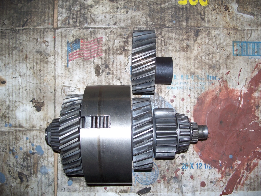

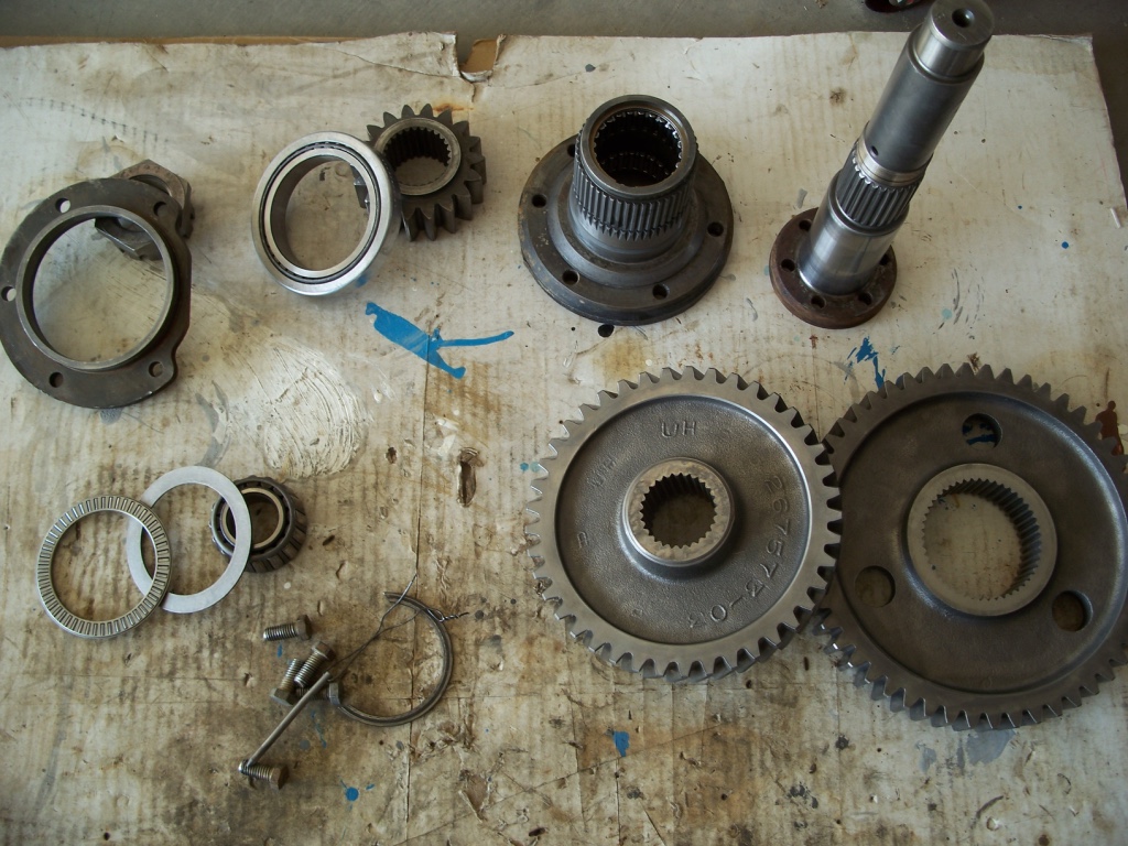

All the implements I have are 540 so I decided to convert my latest purchase, 7080, to dual 540/1000 PTO.
This is what I got at the junkyard, I pulled it out of a 7045 rear end.  They were nice enough to flip it upside down which made it awesome to pull out.

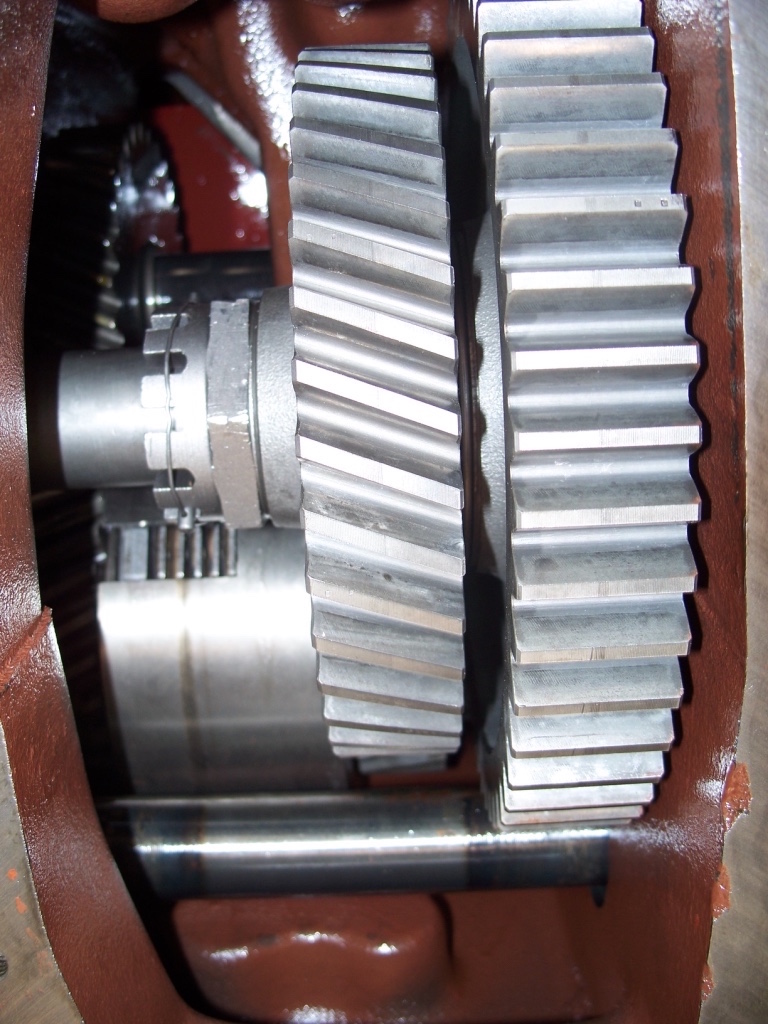

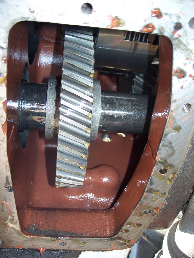

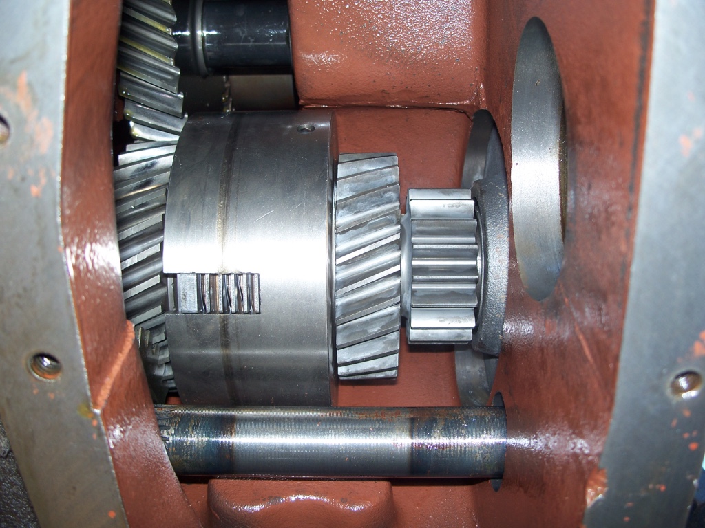

This is what it looks like with the lower plate pulled, you can see this shaft is just made for the 1000 gear.

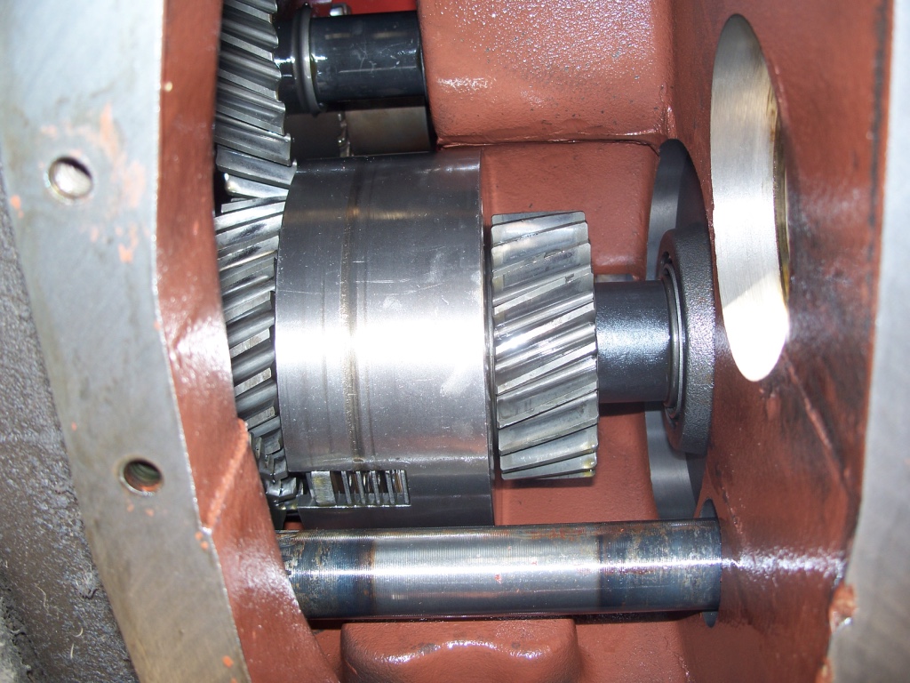

This is a shot of the clutch pack just above the previous shaft asm.  It has the spacer installed on the right of the picture instead of a 540 gear.

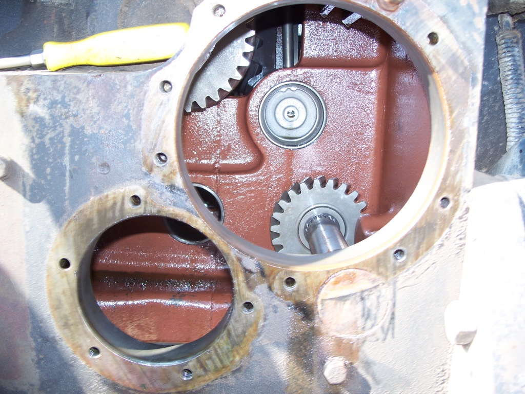

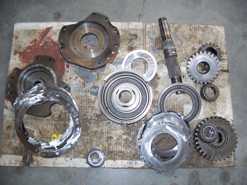

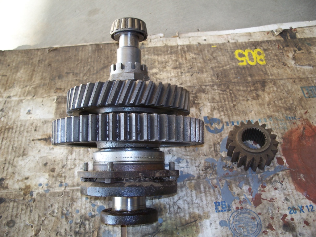

I decided to dismantle everything to clean and reseal.  This is the lower shaft asm.
This is the clutch pack asm.
This is where I ran into a little issue.  I went to put the junkyard gear on the clutch pack and it was a no go.  The original 1000 gear and spacer is on top, you can see it is about .250 wider than I can get on the shaft.  So back to the junkyard I go, guess I should have looked at the parts book a little closer, remember in addition to the parts in the first picture you need the additional gear on the end of the clutch pack.  The FSM says to set the preload on the clutch pack bearing set to 5-10 inch pounds, I tried to go with the lower end as they are used bearings, came out to 7 inch pounds.
This is the new clutch pack setup installed.  That mark on the housing must have been from a previous repair(had red silicone on the lower plate) I didn't find any evidence as to where it came from.  I took apart both the pistons, clutches, all looked good.  I reseal the pistons as I like to make sure everything is good to go.  The apply piston is teflon seals and the brake piston is cast rings.  I have to say they looked perfect, but I figured it didn't cost much for seals.
This is the lower shaft asm installed.  The FSM says to set it to 20 inch pounds more than the nominal turning torque.  My dial type wrench only goes to 150in lbs and it maxed it out so the next bigger one I have is digital and that was difficult to get a correct turning torque, got it narrowed down to 185in lbs turning.  I then tightened it up to an additional 20 in lbs.  If I was going to do any more of these I would get a 250-300 in lb DIAL torque wrench.  I changed the 2 axle filters filled it up, works perfect, nice and quiet.  I know this is a long post, but everyone likes pictures and it does come up time to time about how to do this.

excellent post with pictures and descriptions.  this should be made into a sticky for all to see what is necessary when converting 1000 only to dual pto
