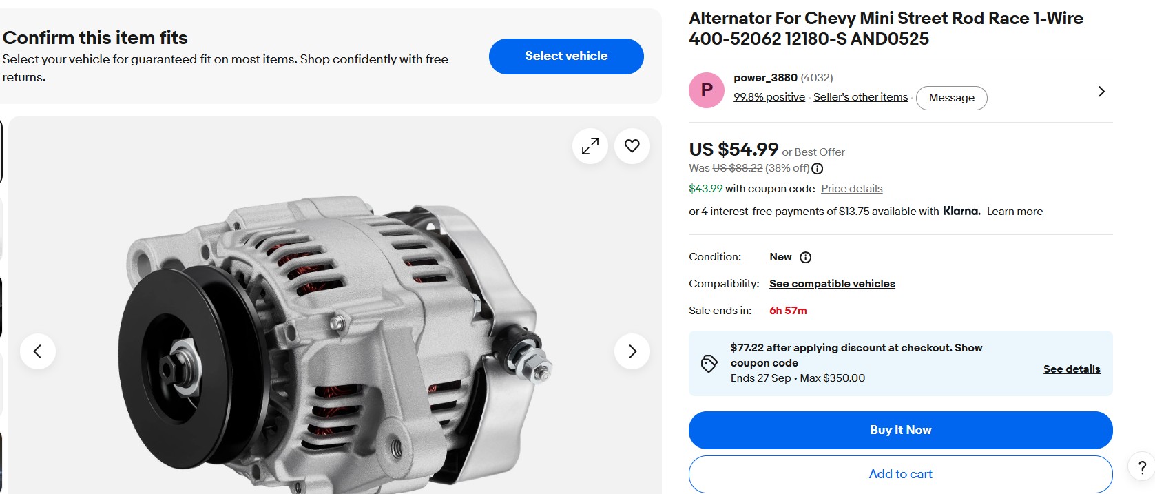

The old standard is the DELCO 10SI with internal regulator..
If you want one about 2/3 that size, you get the DENSO type, or "chevy mini".... prices range from $75. up to about $150. .. many of these are ONE WIRE, meaning there is no spade connector plug needed, just power cable to the battery ............ this is on ebay... everyone sells these. ![]() Edited by steve(ill) - 20 Sep 2026 at 7:27pm |
