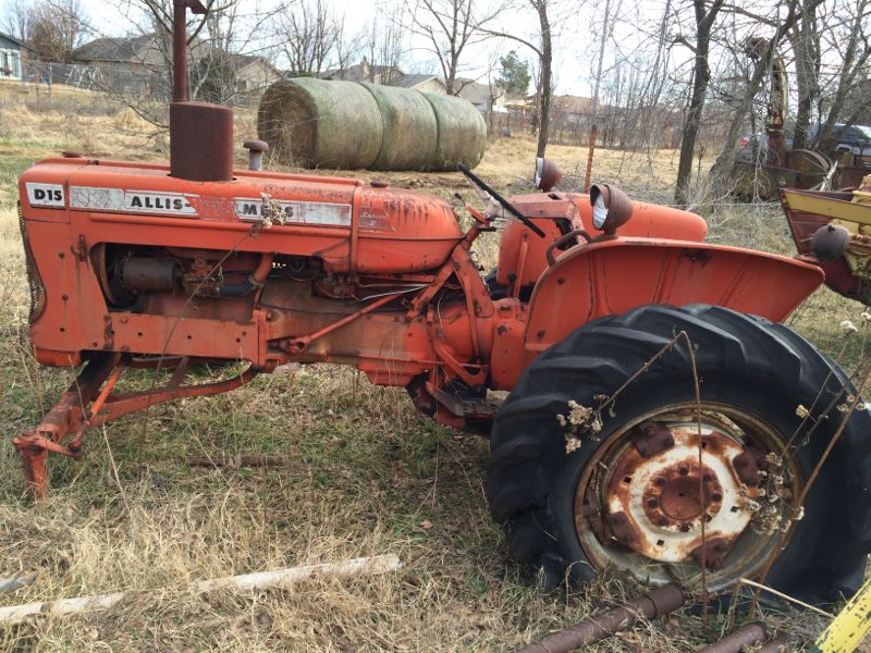

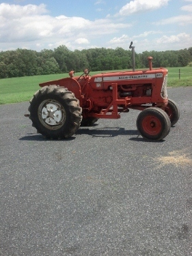

Hello,  I am planning to get my dad's old D15 tractor running.  Hopefully...  It has been parked in his pasture for who know's how long.  It's pretty rough b/c he has robbed parts from it over the years for other equipment.  The carb a marvel schebler tsx869, has a cracked bowl.  The tires had fluid in them originally so the rims are no good.  The crank is stuck (not the first time I've dealt with that on equipment).  Everything has oil in it which is a plus.  However I didn't see any fluid in the radiator...
Here's some pics from the other day.  If you guys have any advise or comments I'd appreciate it!  Thanks Robert.

I've seen  worse.  I'm sure you can save it.  Rust free fenders are a big plus and it's not too beaten up.  Take your time freeing up the engine.  Those rear rims don't look too bad, just weld in some fresh metal where it has rotten away (remove tires first!).  Do you know why he parked it?  Does he know something about it that you don't?

It doesn't look too bad...do you know why it was parked? A low houred Series II is definitely worth saving. Good Luck!

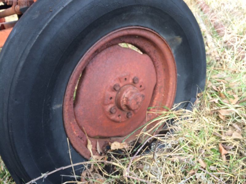

Not as bad as you describe...cept that front rim, as has been said take your time and we will looking at those after pics.

D17 should have 28" rim. D15 26". I had a 15II. I put Combine tires and wheels on it. A GREAT TRACTOR! I want another one.

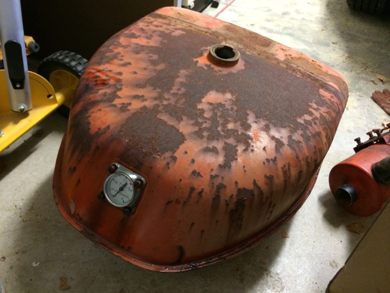

Guys thanks for the comments.  It's appreciated.  Right now I'm just trying to get it running.  I soaked the cylinders in pb blaster yesterday and put a spanner wrench on the front pulley with no luck.  I did get some parts off for cleaning.  The tank actually didn't look too bad.  Although it was full of varnish.  The air cleaner on the other hand I'm having trouble with.  I broke the ears off the wing nut for the paper element, so I guess I'll be trying something else.

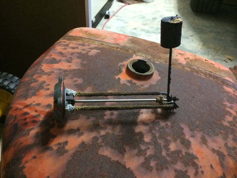

fuel gauge wasn't too bad.  Need to clean it up.

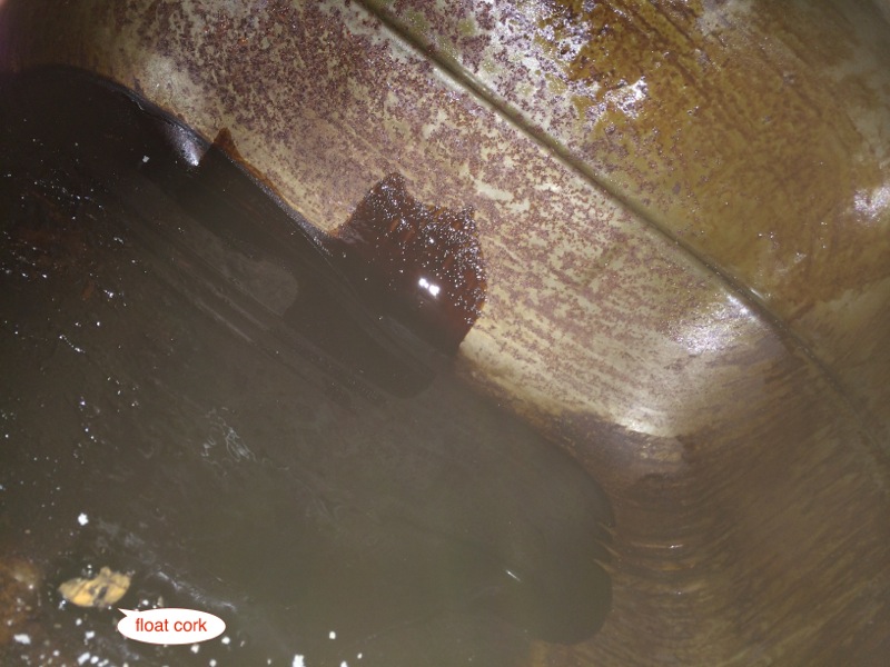

Here's a shot in the tank from the fuel gauge hole.  A little piece of the cork stuck in the varnish when I pulled the gauge out

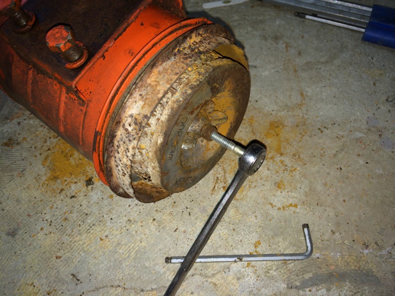

The air cleaner is giving me some trouble.  I threaded a bolt in the end for some leverage, but that just left me breaking the wing nut!

You mentioned difficulty getting the wing nut off the air cleaner.  No wonder!  I do not see any penetrating oil on there anywhere!  For something sitting outside that long, you should be oiling the hell out of every nut and bolt.  It will make your life much easier.
Don't be in such a hurry to get that engine loose.  Let the oil do its thing.  When you see it dripping out the bottom of the engine, keep oiling it!  I had to soak my D14 engine for over 3 months - that was just to take it apart (not try to get loose).
