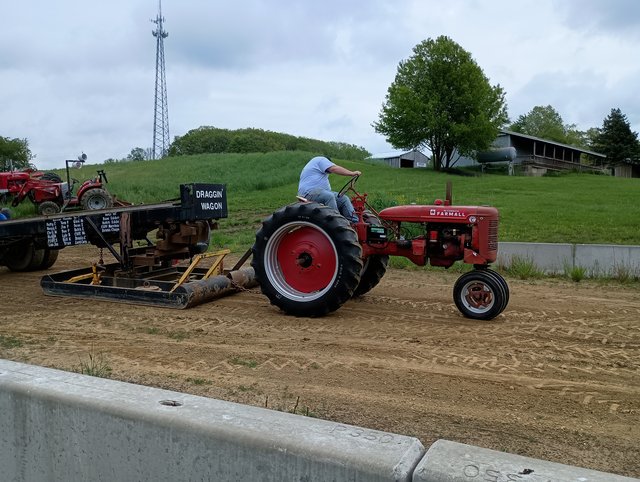

Tested on the WZ last night a local fair tractor pull. I removed 1000 lbs and pulled in the 3500 lb class. Tractor ran fine in low gear on a medium stick track. Not many front ends were in the air.  In hind sight which is always wonderful, I may have done better in the 4500 lb class, with some additional weight on the back. It spun out way before the 300 foot mark. Ok so we have another pull tomorrow night. I think I will load the weight back on and try it in low gear again?
Not sure what these green things are? In the background is my friend Jim unloading his new to him Cockshutt 20. He got first in the 3000 lb class! There were 147 hooks at this fair pull.
Another wide front Allis at the pull. sorry for the blurry pic.
