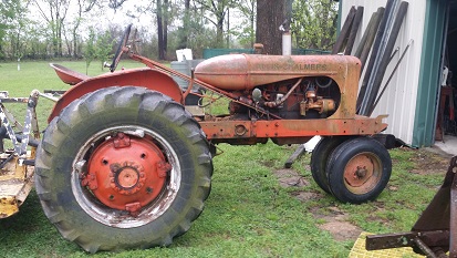

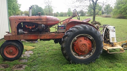

 Hopefully it workedSmile
Edited by mhankins - 19 Apr 2019 at 9:30am
Jim Hancock View Drop Down
Location: EL Reno, Ok.
Points: 1114
Post Options Post Options   Thanks (0) Thanks(0)   Quote Jim Hancock Quote  Post ReplyReply Direct Link To This Post Posted: 19 Apr 2019 at 10:53pm
Hi.
Yes, your pictures posted from the links.
Looks good from here.
I noticed a bracket on the front.
If you don't know what that's for, it's for the front part of a 2 row cultivator.
There should be another one like it for the other side.

Post Options Post Options   Thanks (0) Thanks(0)   Quote mhankins Quote  Post ReplyReply Direct Link To This Post Posted: 20 Apr 2019 at 8:43am
It only has the bracket on one side
